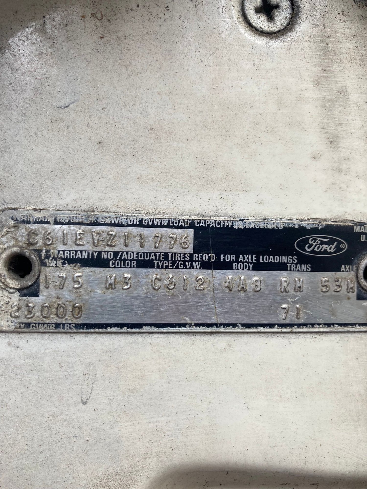

Can anyone please help me decode my vin number C61EVZ11776.

Welcome to FTE!
C61 = C600 gas
E = 361 4V XD FT gas V8
V = Kentucky Truck Plant
Z11776 = 1977 numerical series, July 1977 production
175 = 175 inch wheelbase
M3
M = White
3 = Dark Red Metallic (Is this a two tone?)
C612 = C600 gas, 23,000 lbs GVWR
4A8
4A = Black vinyl, standard trim standard cab L/B bench
8 = Standard cab without sleeping compartment
RM
R = Fan clutch in sound pkg. or engine with California emissions (MPC says 1978 only)(a character here is either an auxilliary transmission, or some oddity like the emissions etc)
M = Clark model 285V five speed direct transmission
53M
53 = Rockwell (Timken) model H-170 single speed rear axle, 17,500 lbs capacity, 6.14 ratio.
(Given the late production and 1978 code above, don't be surprised to find an H-172, same capacity with a 6.17 ratio)
M = Ford 7,000 lb capacity front axle with power steering
23000 = 23,000 lbs GVWR
71 = Los Angeles District Sales Office
Since it was a CA truck, it could be the emissions or the sound items. All of which could be different all these years later.
No special order.
(Note decode completed from tag photo below)
Last edited by 85e150; Mar 11, 2024 at 01:40 AM. Reason: More decode and again more decode

Thank you for decoding! Currently she is snowed in next to the barn. Very excited about putting it on the road again. Had been freshly rebuilt before being parked. Belonged to the local grocery store owner and was used to haul in store coolers..Thanks again Don Meadows Hessel Michigan

I got a little info, but the picture doesn't show the whole tag. Post a full pic and I'll add to the decode.

Full picture of vin
Please see completed vin no. Thank you again Don

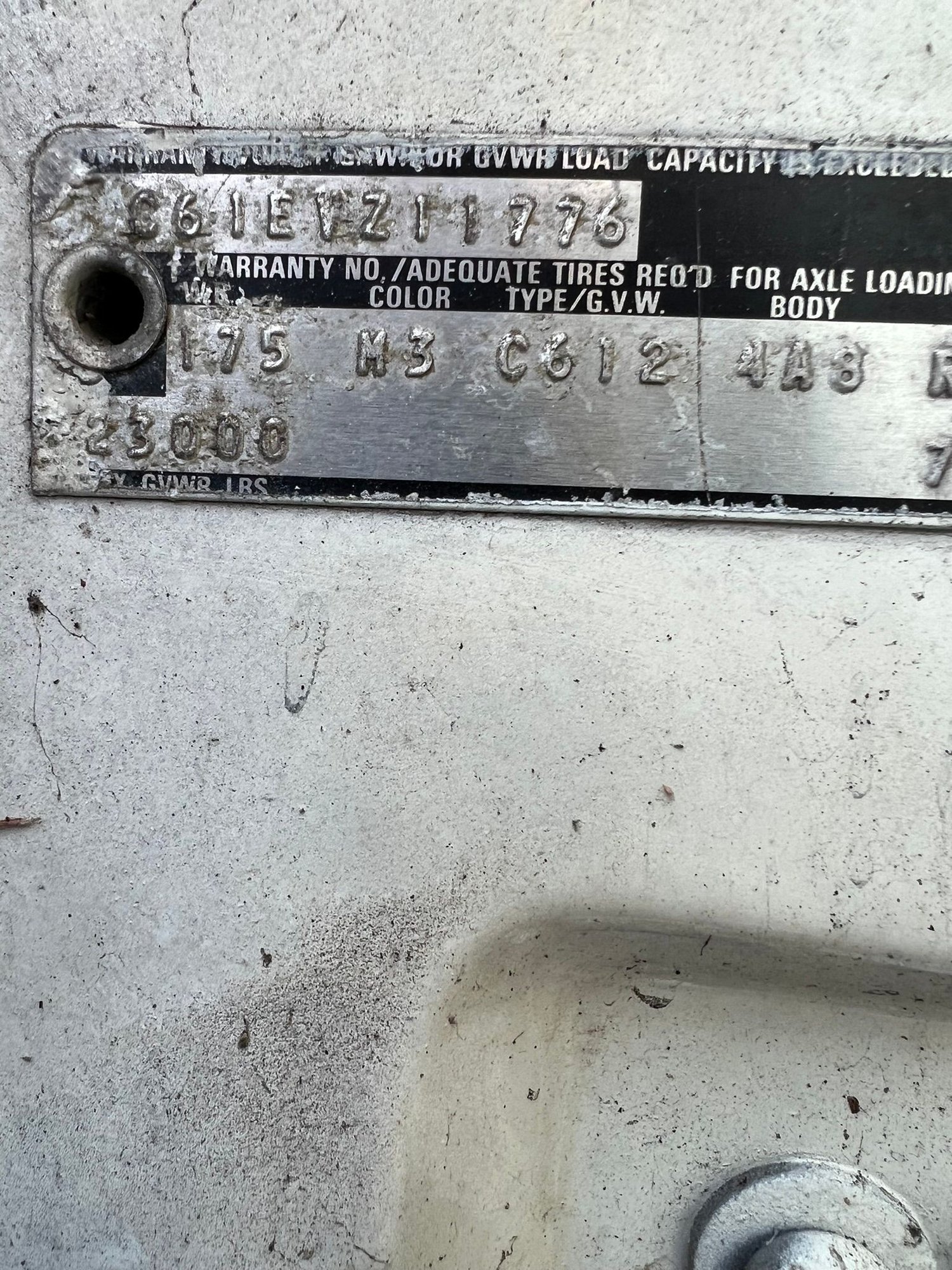

Vin
Vin number

Not seeing anything new. VIN is complete, it the rest of the tag that's no visible.

I think I got it this time

See decode completed above in post 2. I'll clean up the back and forth posts later.
