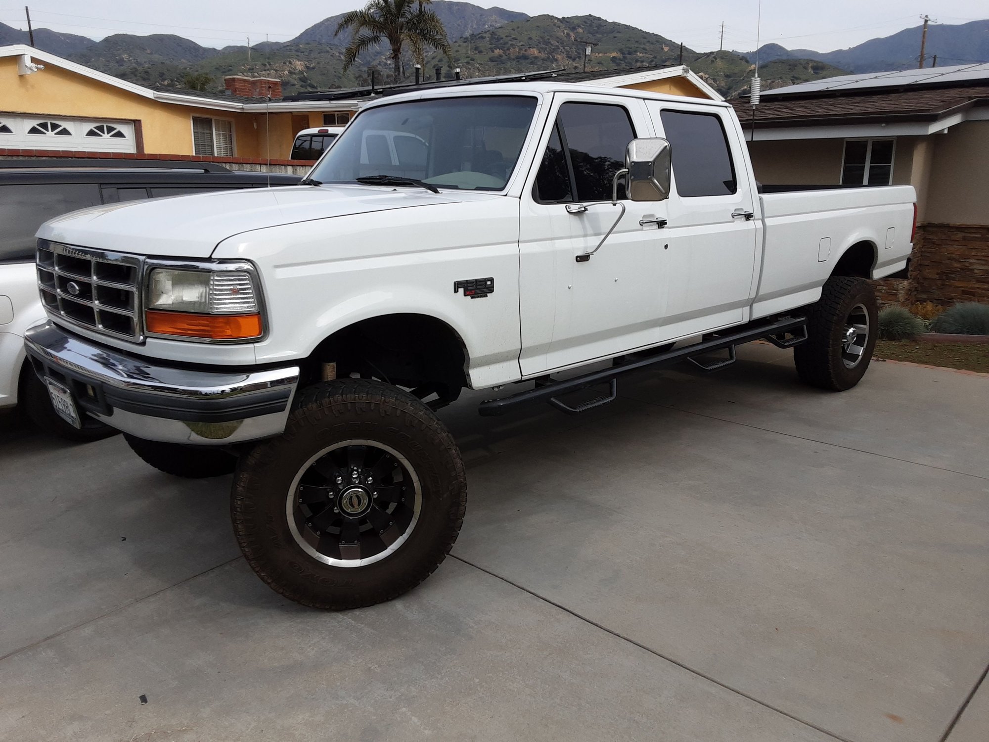

Hello all, Its been a while, Hope all is well.
94 F-350idi occasionally gets a sudden rush of fuel when cold starting it along with some occassional clacking noises during warm up mode. I recently change my low pressure fuel pump that went bad after 2 years probably from not driving it enough since I had a company truck. it sounds healthy once in normal mode. Can anyone suggest what could cause this?
