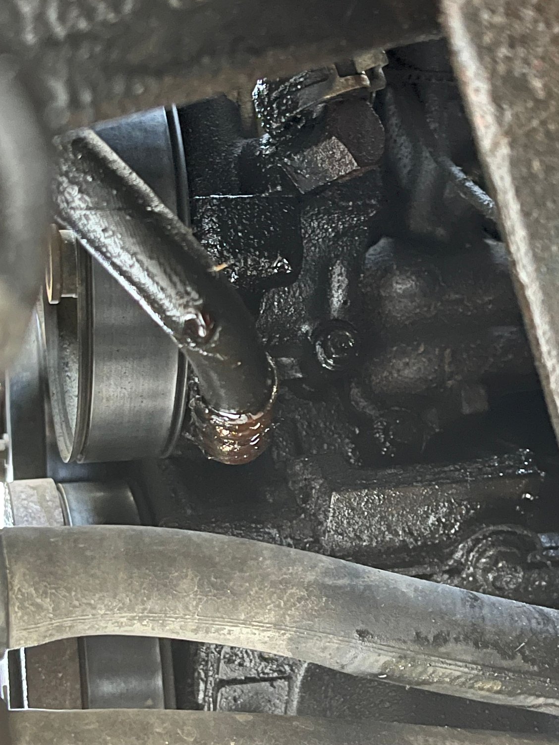

I rec
ently bought a Ford excursion 6.8 V 10 year 2000 it has 239,000 miles on it now the guy that sold me this truck told me they only needed a muffler and a rear windshield that was my mistake end up purchasing a truck and fixing both those parts in a long run, I noticed the oil started leaking. It was coming from the driver side underneath the bottom pulley gradually after I added oil to the truck replaced the oil filter, redid the coolant. The oil started leaking more progressively so I took some photos to see where it’s coming from. Asked a few people and no one has any idea , I’m quite concerned and hoping it’s not the block if anybody can help me figure out what the part number is for the hose lines that are connected to the pulley will be much appreciated or to tell me what the issue actually is is it possible with the simple fix or am I gonna have to have to replace the engine or what I would hate to see this truck go. I’m super excited about getting it on the road just be bumped out that I bought a lemon.

You bought 24 year old vehicle with 200k plus miles and a leaking power steering hose makes it “a lemon”???
Not trying to be mean or insulting, but if this is a major obstacle for you, then you’re probably better off selling the Excursion now because a 24 year old vehicle with over 200k miles is gonna have issues / need repairs on a frequent and recurring basis.
And if you’re not equipped to deal with these issues yourself for whatever reason ( time, space, tools, knowledge) and therefore must rely on shops to fix everything, then the cost of ownership will likely be higher than that a brand new vehicle.

Just have a repair shop fix the oil leak. It's not "the block" it's a gasket somewhere and not really a big deal. As stated above, if an oil leak on a 24 year old truck with nearly a quarter of a million miles on it is blowing your mind, then you should just go lease a new car. Not trying to be mean, but any vehicle with that mileage is going to have consistent issues.

I agree with Antonm23 that it looks like a leaking power steering hose, a $20 fix if it’s the return or a few bucks more if it’s on the high pressure side. Easy to do yourself. If the people who you asked for advice were not able to determine the source after physically looking at it and we were able to diagnose it with just a photo then you need to find a new shop. Good luck and remember as stated before a 24 year old Ex is going to need some love along the way.

I totally agree with the above members that it looks to be a simple leaking PS hose and that yes, a 24 year old vehicle with 200K+ miles will need frequent tending to.

Your oil leak is most likely coming from the oil filter adapter gasket, it's fairly common, especially at your mileage..if you clean the area directly behind the power steering pump where it bolts to engine block, you will see the oil filter adapter, which runs near the full length of the engine and is bolted to the motor mount and engine block..the gasket for that is directly behind the power steering pump, when they are leaking you can almost always physically watch the leak while the engine is running..hope this helps..
