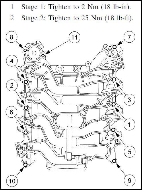

can anyont tell me the correct torque specs for the valve cover and plastic intake bolts for a 04 5.4l 2v? I have been searching and I am getting all different specs Also the pattern. I moved and my Chilton manual is in storage some where. Thank you

I found this elsewhere on the internet. This is represented as being for a 2004 Ford 5.4, but looking around it looks like the spec and procedure stay the same for a number of years older and newer. I hope this helps!
