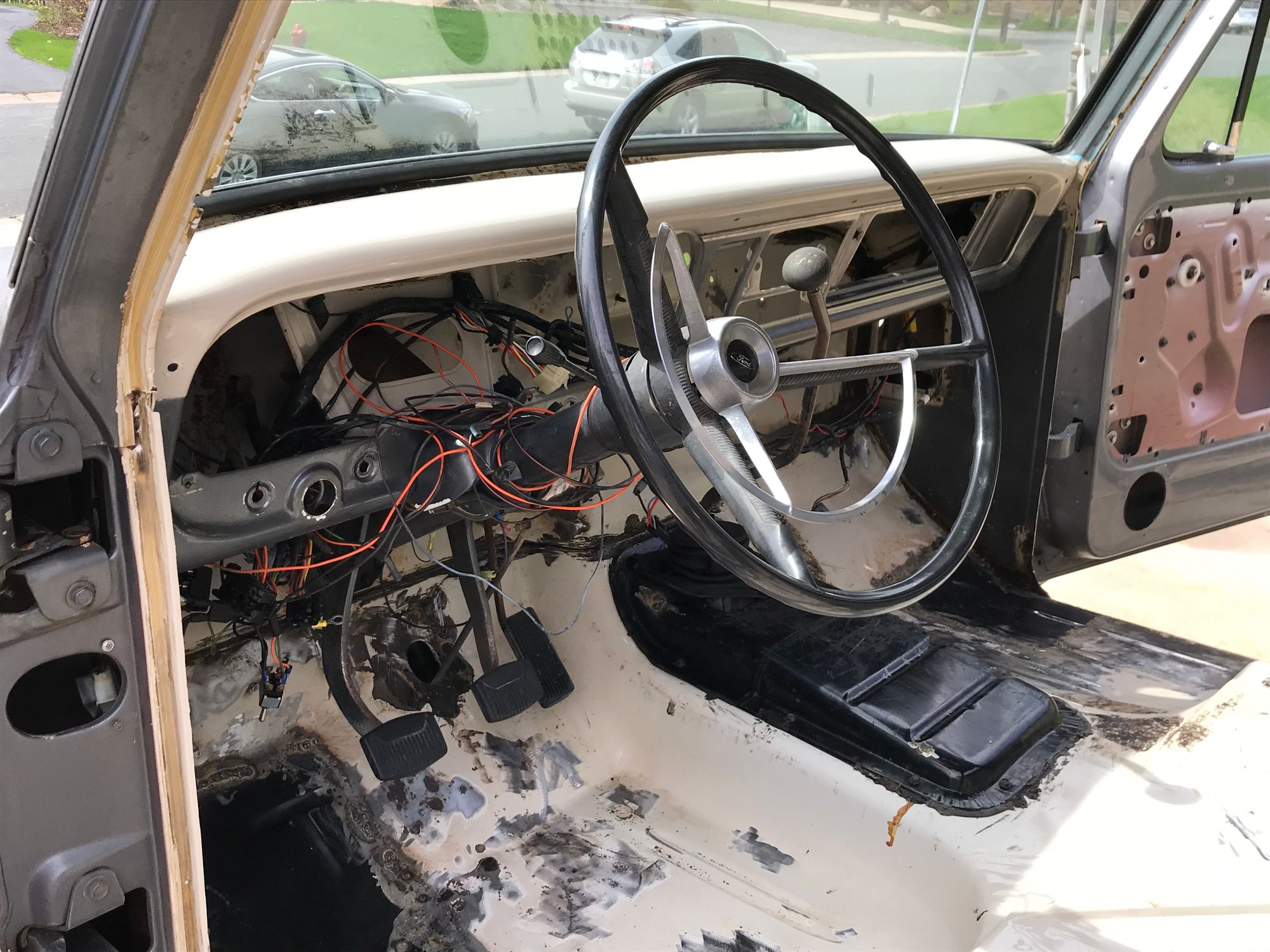

I’m gonna be replacing the windshield and gasket. When I rewire the truck, would doing it without the windshield be easier or make no difference?

I replaced the weatherstripping, and some of the dash wiring, in my '68 about 5-6 years ago, and I took the dashpad out as well, thinking that would make things simpler.
Turns out it didn't matter, as the dashpad is just that: a pad, for a metal dash, and from the top of the dash there's little to nothing accessible underneath.
Quick shot of when I did this that may help (top of the dash shows original color of my truck):
Jim

no. Just curious about access to feeding wires. But sounds like the actual top of the dash prevents it anyways, so no sense in waiting to replace the glass and gasket.
