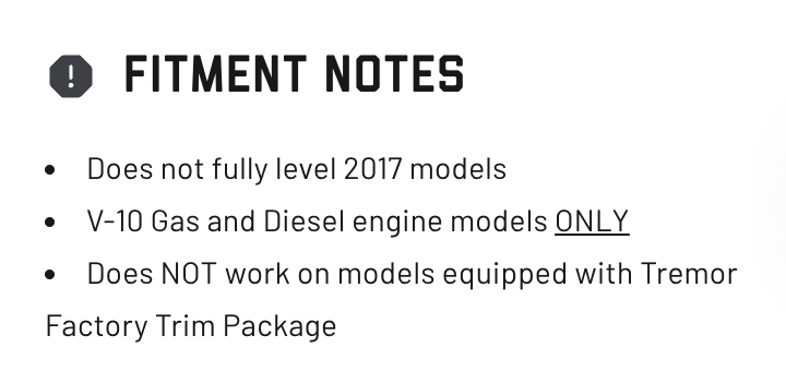

Any idea why they state that they will not fit on V8 models? Only V10 and Diesel? Can't imagine theres a difference in suspension on an XLT model.
https://www.roughcountry.com/product...-lift-kit-9285

Posts: 1,182
Likes: 176
they worked fine on my 2017 6.2 XLT's. But you might get a little more with the lighter 7.3 or 6.8 then I did

When I put in info for check this parts it says Ok.. They will work fine ,
Thanks. Really appreciate it.
