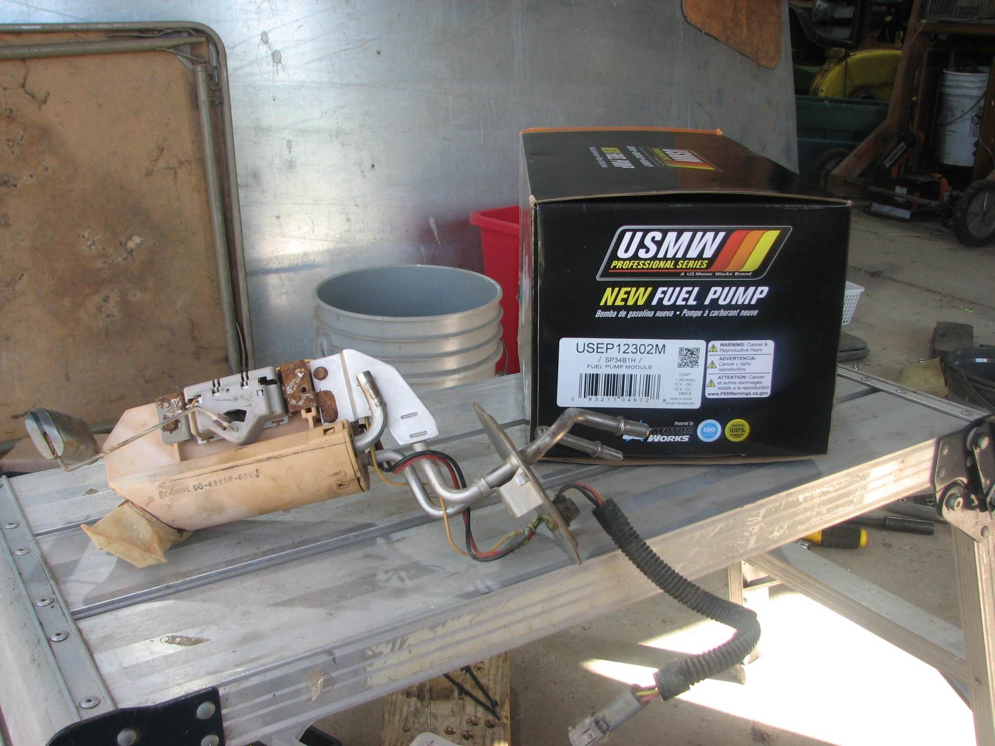

This is the rear pump, complete, fit right in, about $150. Came from local Auto Value parts store. All I could find was one possibility of rear tank, 18 gallon steel.

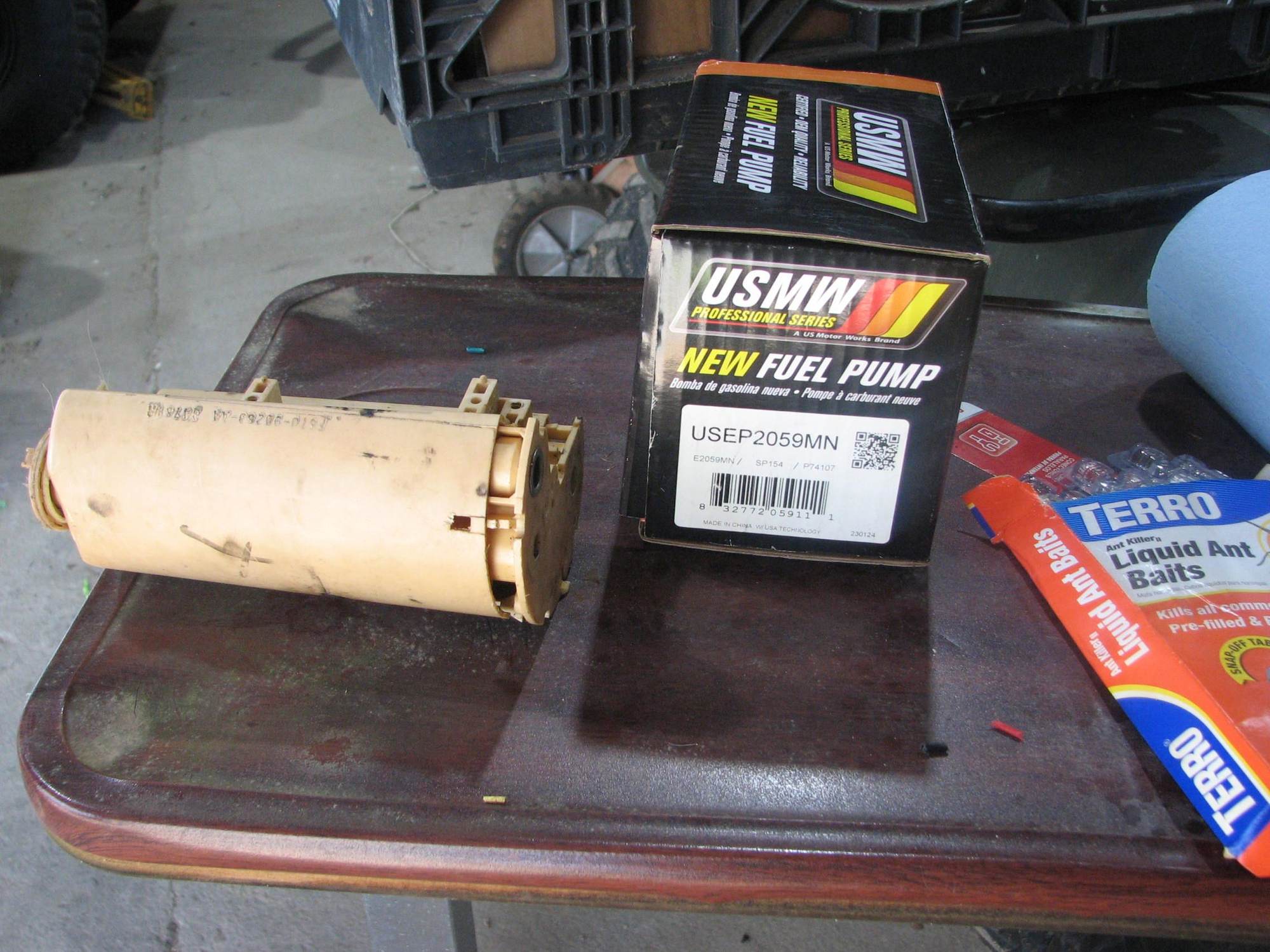

This is the front replacement. Had to do pump only, could not find complete unit. same source, about $80. Took a little force to get it off, could not get the tubes to fit all the way in the new pump. Took it to the parts store and 2 guys spent about 30 minutes getting it on. These guys are hard to beat, probably spent 4 to 6 hours finding me the correct pumps. This was a steel front tank, I am thinking the 16 gallon tank as all the complete pumps were too long. They called the local Ford dealer with VIN number and they said there was a possibility of 12 pumps for the front tank. You do have to cut and splice the wires for the pump, it comes with heat shrink connectors. not sure why it does not catch fire but not so far. Looks like the same pump assembly would have fit most if not all the various assemblies we tried. I wonder since the 1997 and 1998 trucks were a holdover Ford might have used up a lot of spare parts.
