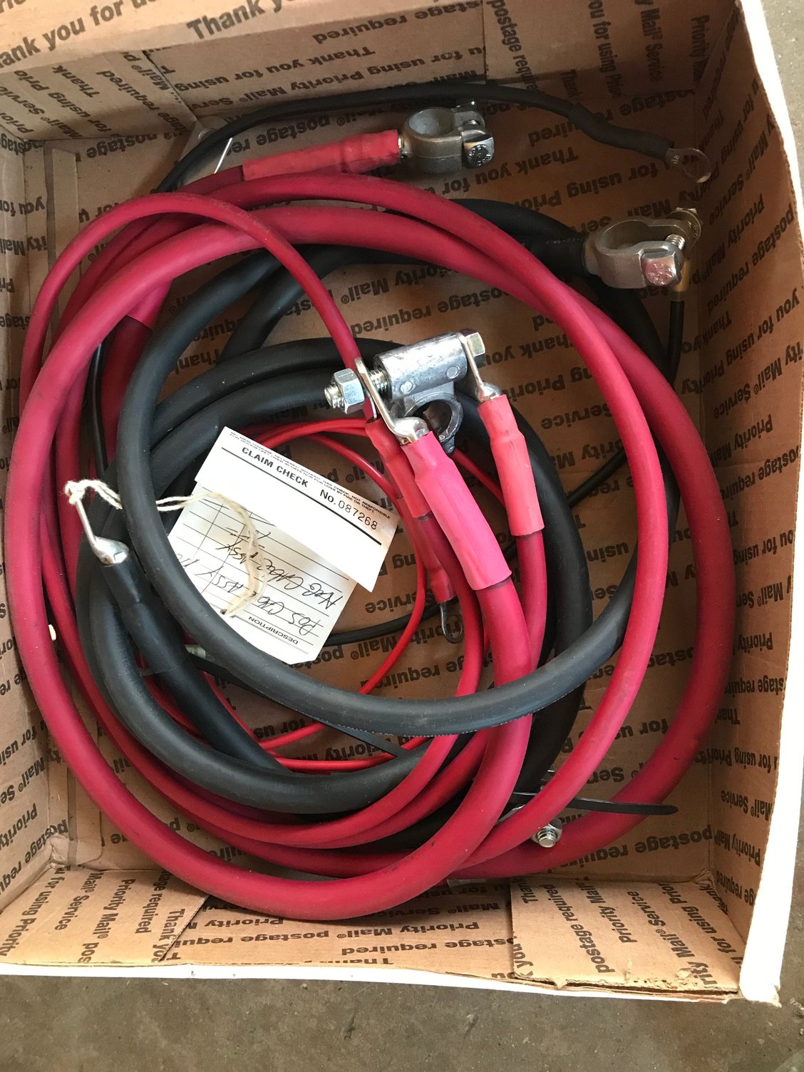

I had the last set of 7.3 battery cables made for $175 I think. I bought an extra set at that time. Let me go look.
Last oem motorcreft cable I bought was in 2018 off Amazon. It was $100. Can't get them anywhere now.

Originally Posted by Kwikkordead
Factory battery cable size is 2/0 not just 2 guage.
I know, I was just saying I had a bunch of 2 gauge that was given to me. A spool of it actually. I know the cables need to be bigger than what I have, I was just wondering what size y'all redid yours with?
Thatd be awesome! I could buy them from you at the GTG if you locate them!

This is the set I used. Been great so far!
This was $185 from a wire/cable shop in Tampa a couple years ago. I had a buddy take them a set of factory cables to replicate and had a couple sets made.
Looks like I need to put them on fleabay with 100% mark-up! Might finally be able to quit my real job!!!
I put your name on the box Tristan and will add it to the barter pile!!
