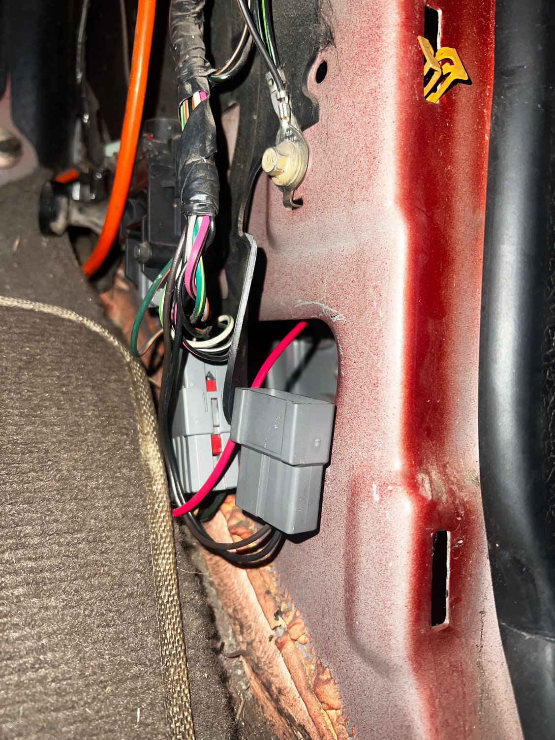

Does anybody know what this plug goes to? It’s behind the passenger side kick panel. Any info would be greatly appreciated as I cannot find anything else online. 2000 f250 7.3

Cab lights pigtail would connect there if equipped. Brown wire is running lights. Makes for a nice splice point to tap into or retro add OEM cab lights
That’s interesting, my truck has cab lights. I know on some super duty’s the cab lights turn on when the door is opened but mine doesn’t. I currently have no lights being turned on when the doors are open which i’m trying to figure out why that is too and was thinking this might be connected to the issue

I believe the cab lights being referred to are the exterior cab clearance lights, not the interior cab lights
