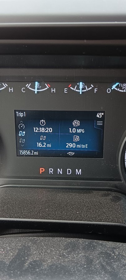

Trip odometer partial reset
I have read about the 2023 f250 going into a power saving mode after a few days, but has anyone else noticed that both of your trip odometers do a partial reset as well as fuel milage is highly inaccurate until you do a manual reset. This really bothers me and my ford dealer said they have never seen this. My truck often sits for a week at a time due to motorcycle being my daily driver.
I have contacted my dealer twice , they claim they have not heard about the trip odometer problem. I have had 2 2023 F250’s, both are doing it

This has happened to me multiple times on my 2023. Dealer cannot find any codes. Mileage on both trip meters resets to .1 mpg and start counting up from there. If not reset might make it to 3.0 mpg in a few thousand miles. The running mpg on the instant mpg screen does not change and stays consistent. Truck is a daily driver, a couple of days is the most it has ever sat. If anyone finds a solution, I’m interested. Truck is a CCLB 7.3 with 19000 mi. Have had this happen both when truck is started and also while driving 5 times total.

This is happening to me as well. Three times so far, it reverts back to 0.1 mpg and builds slowly from there. You can’t keep tract of accumulated miles on either trip one or two
this is a 2023 f-450 xlt with just the small center screen. So far I see only recall mentioning the larger screen. Truck only has 1600 miles

This just started happening to mine too. Just bought a 23 350 with the 7.3 and small screen. It's only got about 8000 miles on it and it started happening about 500 miles ago. I usually reset the whole thing on each fill up, but partially through a tank it resets itself. The mpg and miles traveled resets back to zero but the time traveled stays the same. Sounds like a computer glitch. Glad it's not just me but maybe if enough people have it, they'll come up with a fix.
