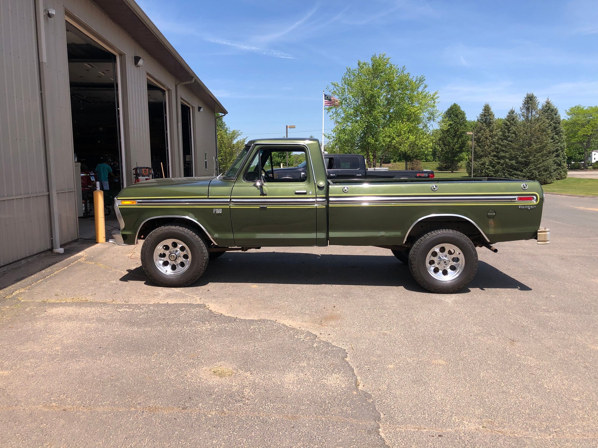

This is my '76 with stock front springs/ upgraded rears (previous owner had a camper in it) on 17 x8" (0 offset) wheels with a 285/70/17 (~33 11.50 17). These rubbed the radius arm at full lock, but were otherwise fine. My truck has a stock 360/ 4 -spd/ 3.50 gears.
