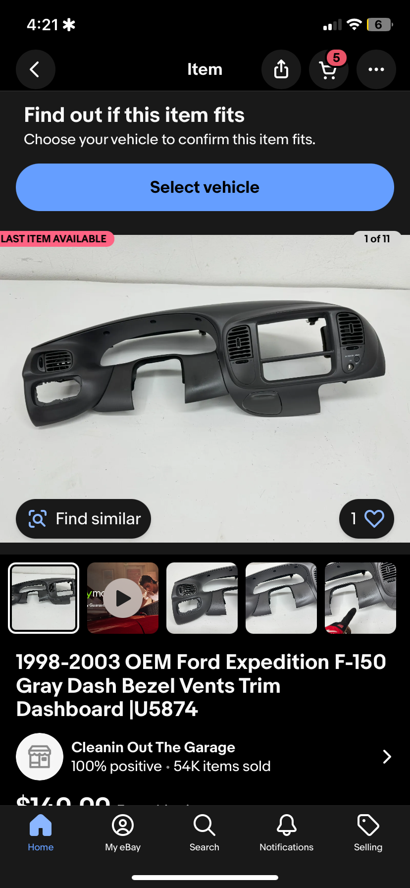

Here are the ebay dashes:
This is only the instrument panel portion of the dash, which is the only part that i need for my trucks dashboard the other piece is intact. So can i get by with just replacing this part pr do i have to do the entire dash?

Anyway, I bought a Coverlay cover for my ‘03. Should work for hours, but that upper portion is about $220 for the part. My dash isn’t that bad, but there are spider cracks around the defroster vents and I opened a hole above the passenger side airbag.
Epoxy your current cracks and slap the Coverlay over it.
