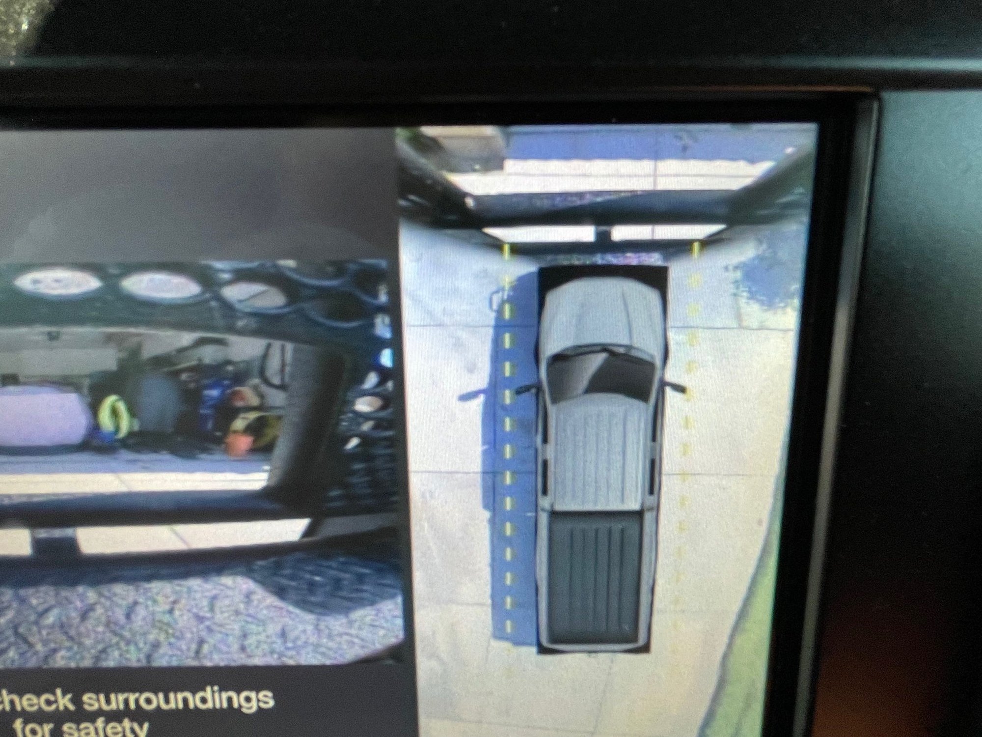

All of them with a cutout for the camera will limit the available view when compared to not having anything on the front. All you need to see out front is the leading edge of your bumper so you can avoid hitting something. If you don't like the view, back in and use that camera instead. Here is what the view looks like out the front with a full replacement bumper...

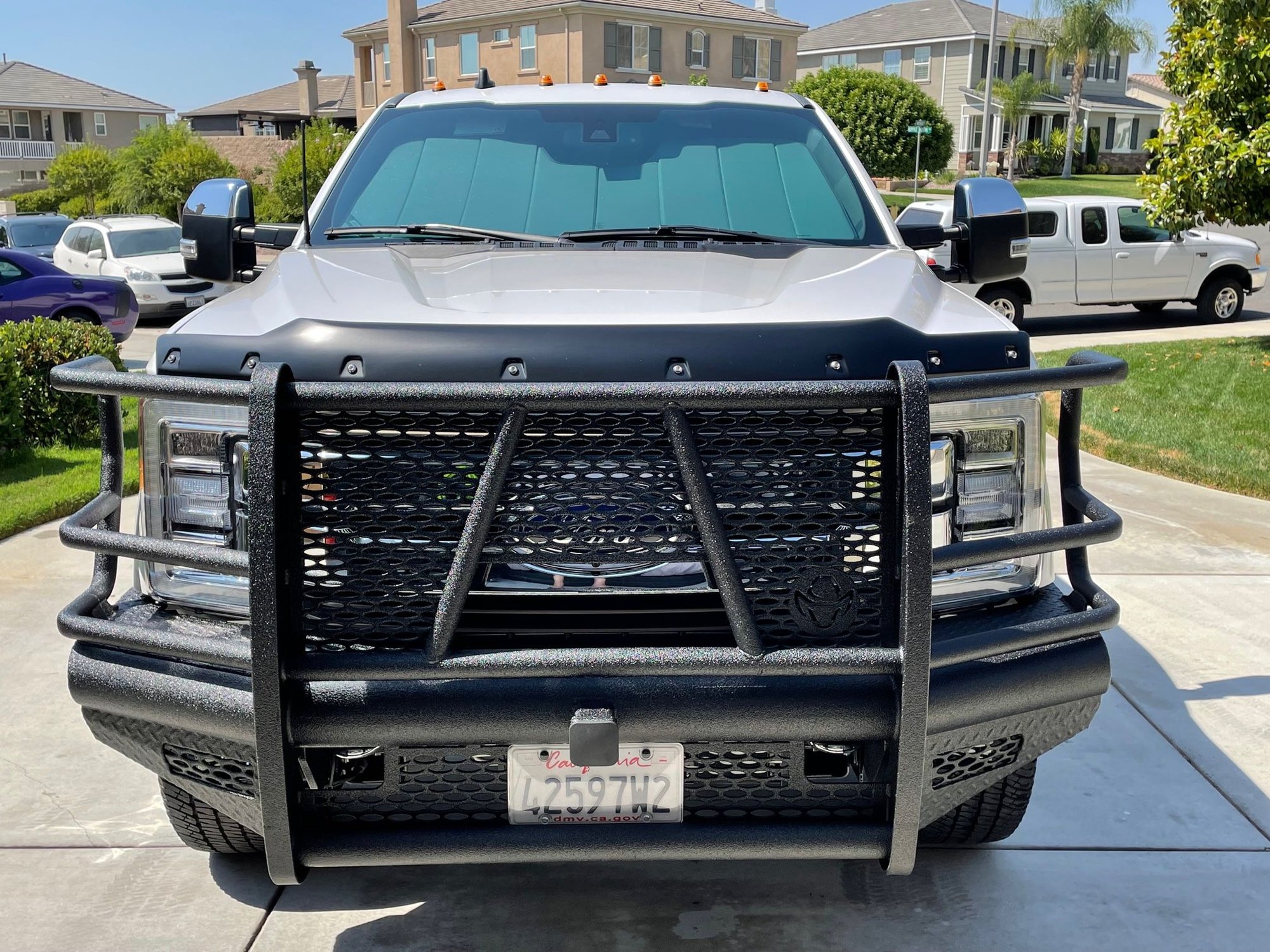

Yes, I have ACC. I don’t usually use it but On my last trip to Wyoming, I used it quite a bit. I had no issues with it.
If you look carefully, you will the sensor that is mounted behind that screen just to right of the license plate in this head on view. I originally thought the screen would interfere with it but it works fine. I do think the screen over the fog lights cut the beam down a bit so I might end up taking the screen out of those spots. It could also be because the lights sit a bit further back and the side is blocked a bit by the bumper.
