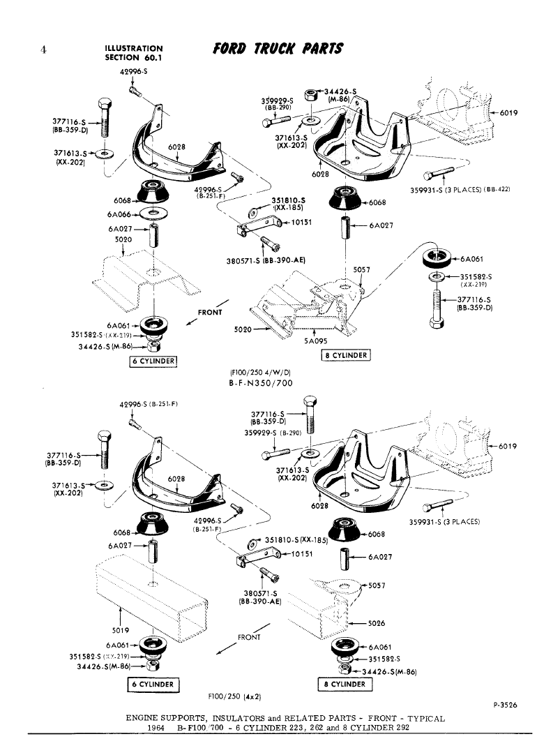

I'll check my truck in the morning if I remember but it looks like from the MPC that the 4WD trucks used rivets for the bracket on the 292 8 cylinder (upper right) and the 2WD trucks were welded on (lower right).

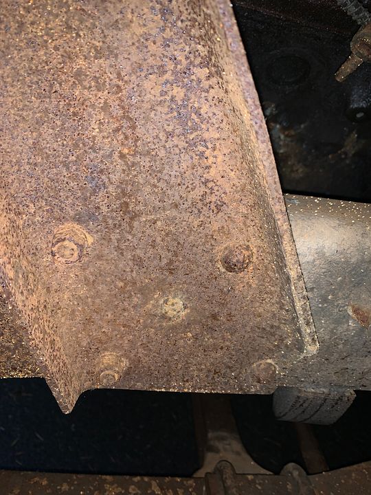

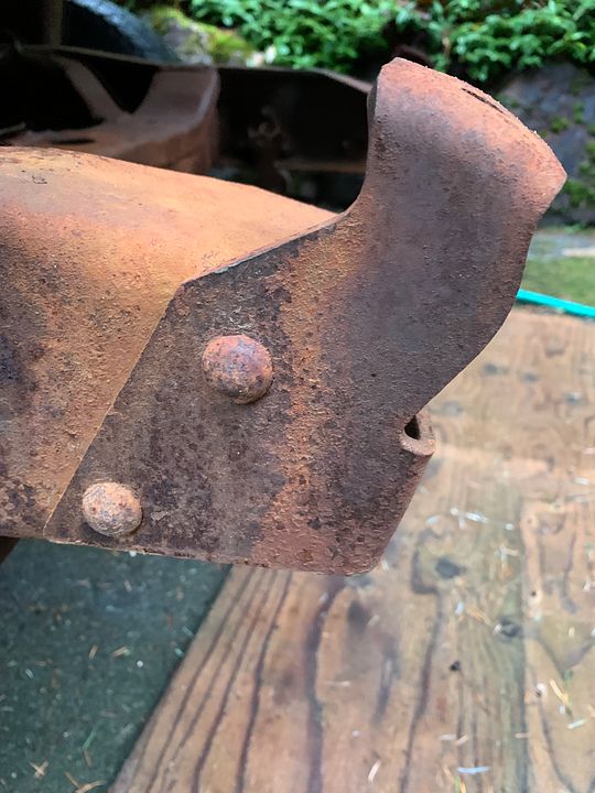

I'd bet the reason they did the front engine mount different on the 4WD was the pounding they were expected to take - could have even shown a problem during testing in 1961 that required a more robust design. One thing to note is final assembly didn't do any welding or heavy riveting, their job was simply to assemble the pieces. The pieces (engine, transmission, axles, frame, body with paint, etc.) were all prepared in other pre-assembly areas/locations or by other vendors. Everything was very orchestrated with the various pieces needed to put an exact vehicle together all coming to final assembly at the time they are needed. They would have known by then which engine type was going in which frame. General Motors knew which exact engine was going into which vehicle and stamped the partial VIN number on the engines and transmissions. That's the number-matching many people talk about.
In 1914, Ford was already experimenting with assembly line prototyping, and his system was perfected before the Minneapolis plant started making Model Ts. This system allowed cars to be assembled in a record 93 minutes, rather than twelve-and-a-half hours.
Consider this - a truck is ordered with auxiliary springs in the rear. Front and rear brackets on each side. 4 rivets per bracket. Even 4 guys would have to do 4 hot rivets each. Probably take more than a minute to do all 16. They wouldn't be holding up the assembly line for that long - San Jose was capable of rolling 22 trucks off the line every hour as well as 59 cars with a potential of over 1,200 vehicles in a two-shift day.
I gotta admit most of the 1961-1964 trucks I've seen without their front bumper installed did have the brackets (61-63 different than 64) rivetted on. But things did vary some by assembly plant and perhaps St. Paul did it a little different on the bumper brackets. I don't see any indication of 4WDs being different as far as bumper brackets than the 2WDs.
On a side note, the MPC often shows bolts being used to secure pieces that are often found rivetted on originally. That's because dealerships and most service shops didn't have the ability/equipment to do hot riveting. I've also seen examples where rivets AND bolts were used to hold on the same one piece.

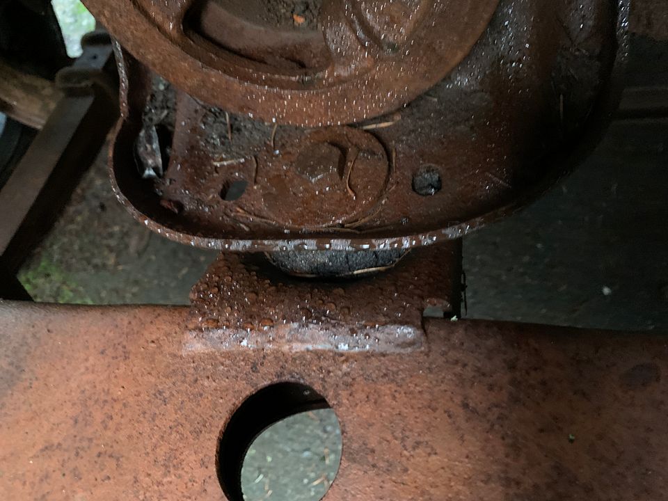

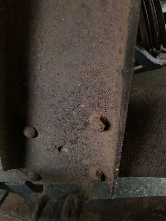

Here's pictures of my 1964 2WD from the Kansas City assembly plant.
Front bumper brackets
Front shock towers - note the use of rivets in the back two and bolts in the front two. Did I say that right? Still a little early here.
And the welds on the front motor support look decent. Doesn't look bad at all here. It does look like the one other truck you posted the picture of is only half welded across the top but maybe it's not that bad in person. Or it was welded on a Monday after a long weekend by a new hire...

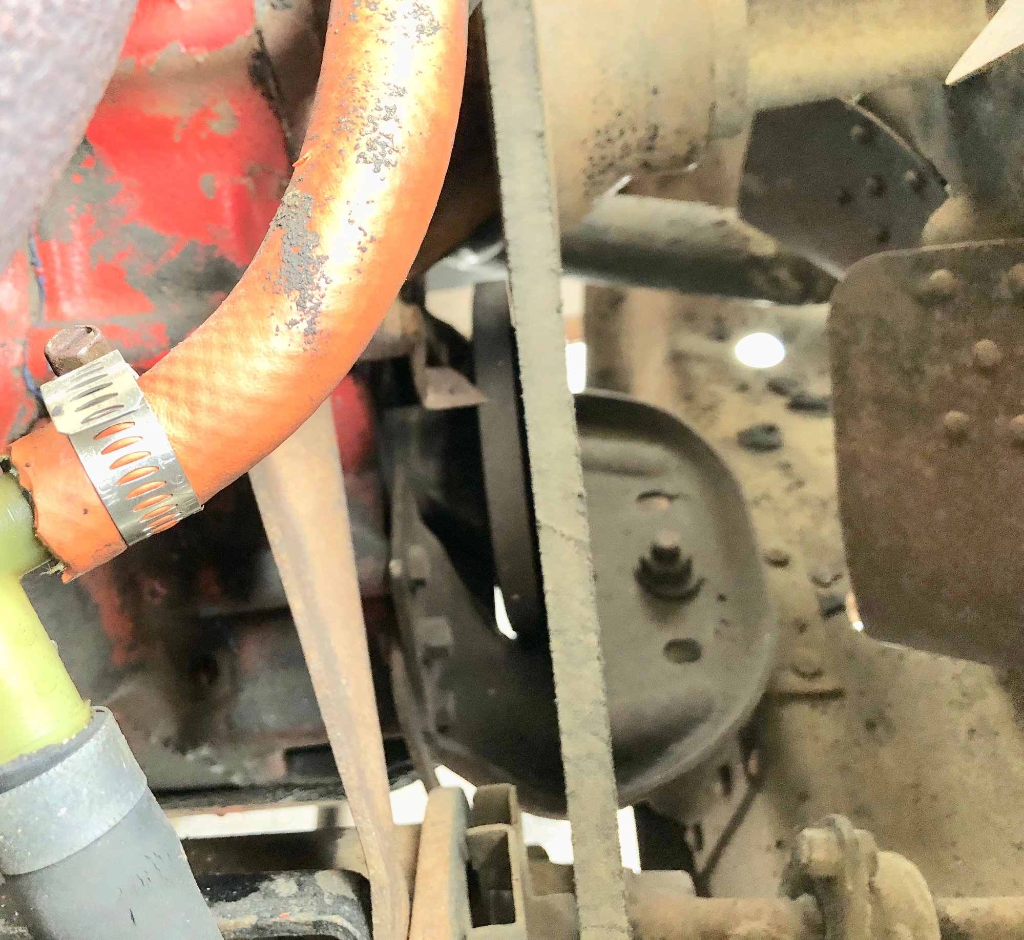

Another thought on the different front mount for the 4WD might be that things sit a little taller on those models. I think if Rick looks where his radiator core support attaches to the frame it's got two metal perches that the core support sits on. That raises the radiator up some and to keep everything in line that front bracket may provide some additional height to the equation.
My 1966 F250 4x4 with 6 cylinder uses a front perch that adds some height. Tough to compare a 1965 F100 4x4 and 1965/1966 F250 4x4 to the 2WD trucks of the same years since they used side motor mounts instead of front and rear.
