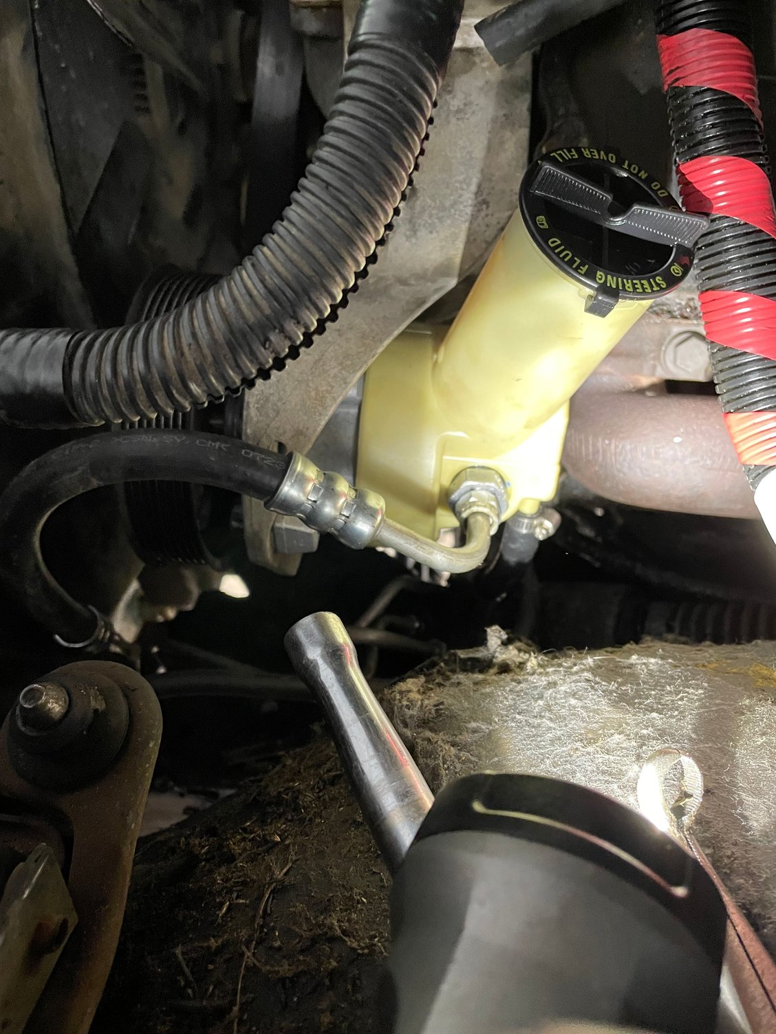

Small bite. Update- big bite
Another one down, now it’ll hold power steering fluid for more than a few days, got a Motorcraft rebuilt pump and a new return line on. I changed the pressure hose a couple of months back.
Going to take care of this next, I’m still kind of on the fence about fix or delete.

I’m in the process of deleting the EBPV and new up pipes, I’ve been working off and on for three days on eight bolts, got the four exhaust manifold to up pipe bolts, got one out of the upper flange on the driver side, gave up on the other one hoping when I get the turbo out I can move the up pipe and collector around and get a good hold on it.
Got the upper turbo to collector bolts out and got the nut off the lower driver side, the lower passenger side is going to require another trip to the tool store.

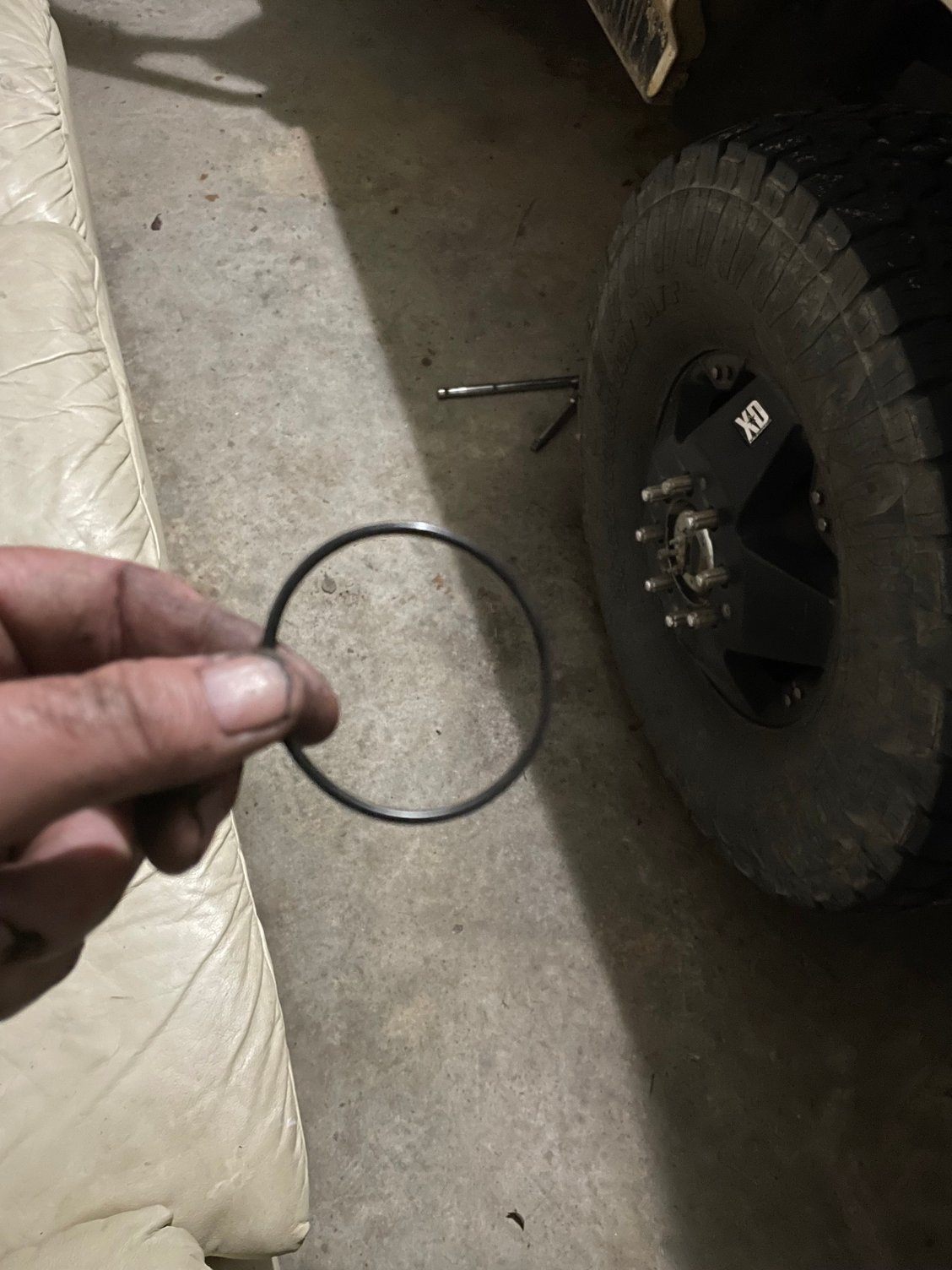

This o-ring came with the kit, anybody know where it’s supposed to go? The only other o-ring I took out that size is the one on the turbo outlet.

Looks like turbo outlet to plenum to me.
