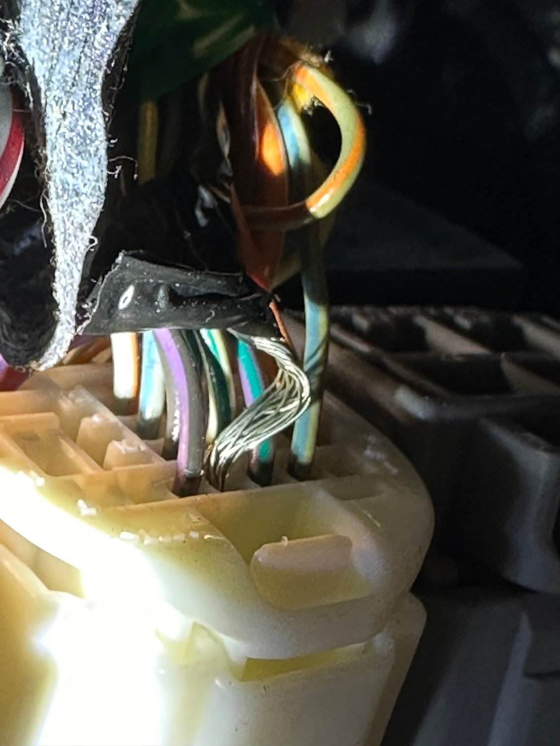

Found this gem while troubleshooting

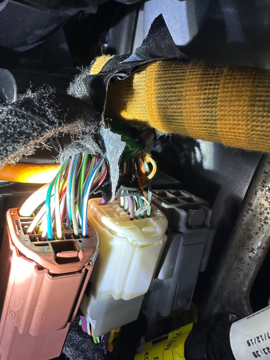

Not sure what this connector is for; it is located behind the bottom right side of the glove box.
i am currently troubleshooting a parasitic battery drain. What a pain!

It looks like speaker wire to me and as best i could trace it was to a large wire bundle running on the right rocker panel. Then again, it's all taped up so who knows. The parasitic drain is what is driving me crazy. I also got the Adaptive Steering Fault Service Required message...

If you are looking for help it would be a good idea to include the details about your truck - year, engine, trim level, etc. Also - a picture not so close up of the area where the connector is would be helpful. I have a wiring diagram book but it is hard to tell where you are exactly.

Is your concern the uninsulated wire? If so, it could be part of the outer shielding for the harness that gets terminated in the connector.

I was just taken by surprise to find the wire insulation gone, really do not think that is the issue I am chasing though. If it were on just one side of the plug, I'd almost believe it to be a factory over sight, however, it is on both sides of the plug so it is just a little surprise the previous owner left for me.

As I mentioned in prior post, it is most likely a shield wire. It is common for these to be terminated as an uninsulated wire into the connector. It is not a factory mistake. It is on both sides of the plug to carry the shield through the connection.
