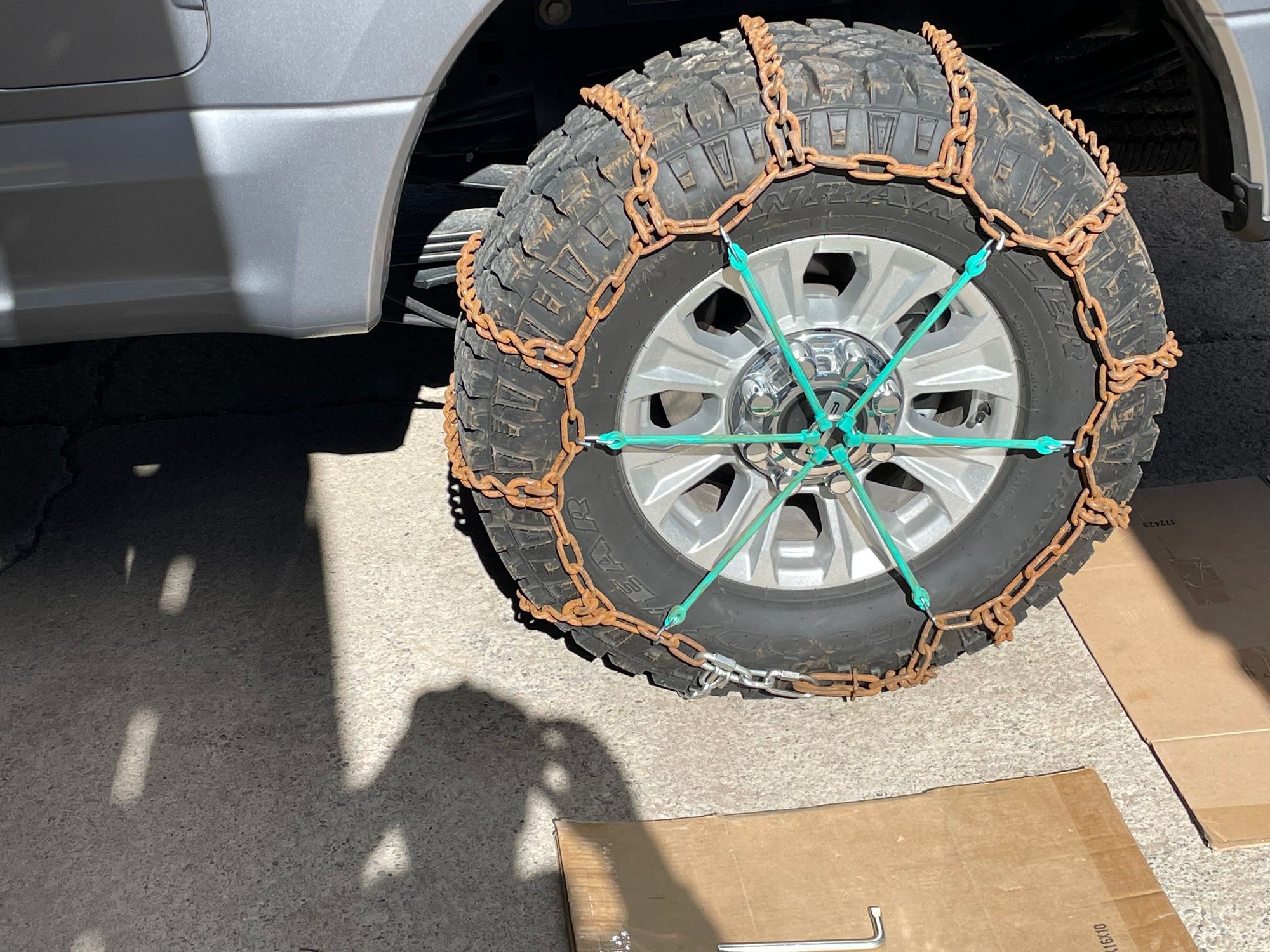

I run chains on a stock truck with stock wheels and 285/75-18 tires. They just barely click the radius arm at full lock. Cables to me would be a last resort, an on road solution you almost never need but are sometimes required to carry. Colorado doesn't require me to carry chains. I learned 20 years ago the value of chains when I was rescued in the dark, in the winter, in the ditch in the middle of nowhere , because somebody else had them...I bought chains the next day, good ones because I rely on them to save my bacon and make me money.
This is all chained up to haul these logs down a 12% grade covered in snow and ice for several miles.
I have never felt the need to run a 4wd pick-up down the road at speeds where chains would start tearing things up. I rarely run them on pavement, only with over a foot of snow. I could see how you could tear up wheels but users should apply common sense to what they are doing.

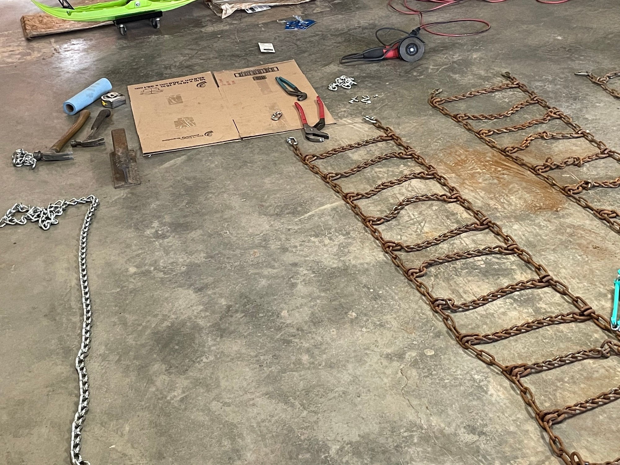

I use a heavier twisted link style. the v-bars are incredible but unacceptable in some places I like to use them. I have matching, chains for all four wheels. They have already been on the truck twice this year and we hardly have any snow. I use mine a fair amount and can have a pair fitted in 5 minutes, I try to choose "clean" places to fit them. fresh snow brushes of pretty easy. I do have a tarp in the toolbox as well
I like your anvil. Is that a section of RR rail?
lol, yes, handy and portable !
