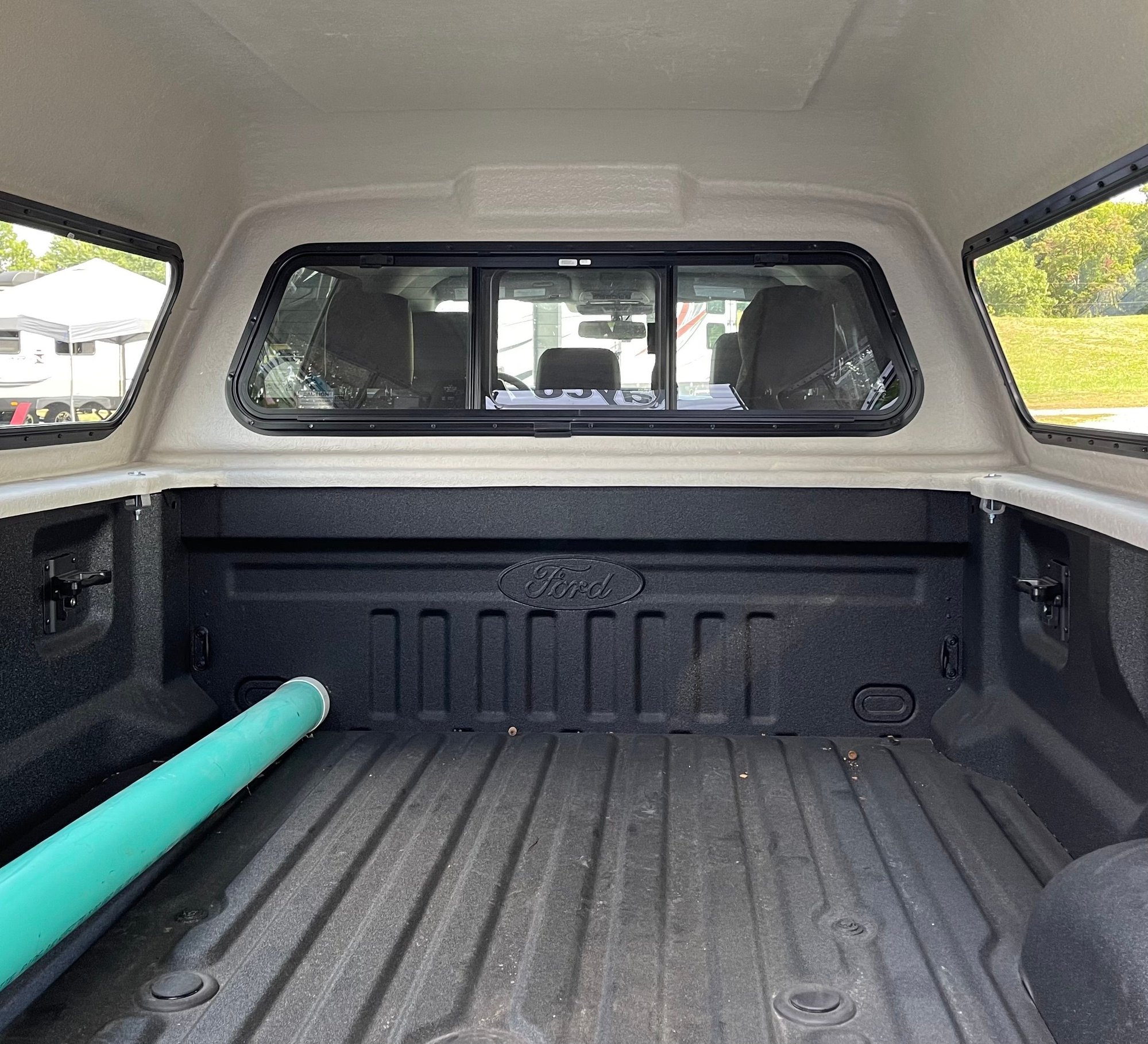

In the photo you can see front covers in the photo of my 2023 with the prep package. Photo was looking at something else thus it doesn’t show the rear and center.

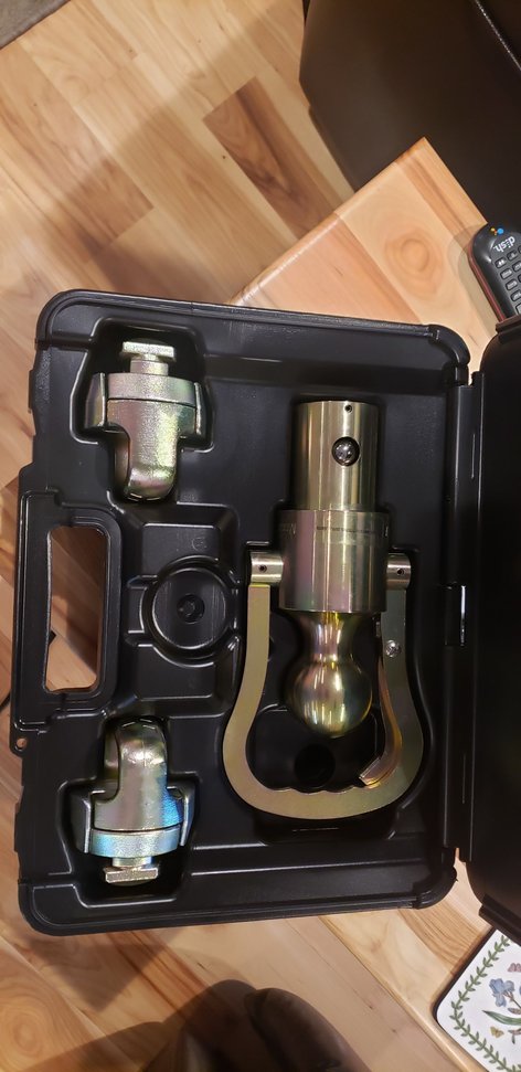

goose neck is just the ball. Curt, Ford, BW and others make one that will drop in the hole.
