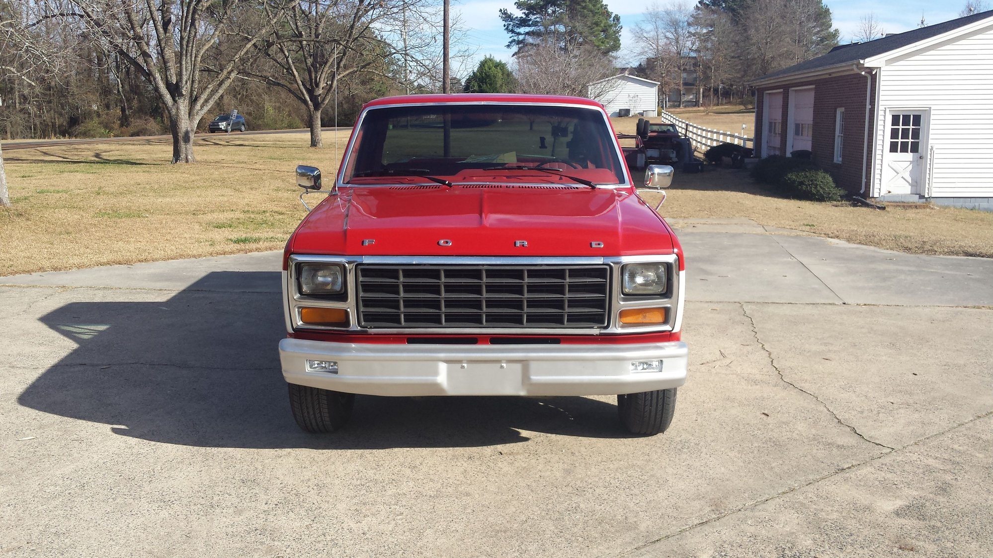

Oh just a thought on the back up lights.
If you are in the building stage or looking to change the look a little and dont want the lights below the bumper or "stuck on" some where maybe put them in the rear bumper?
I wanted driving / fog lights up front but did not want them above or below the bumper so I found a set that would fit in the bumper and that is where I placed them.
No no one makes a 80 - 86 front bumper with lights in them I looked.
I also removed the bumper bolts on the front & rear bumpers.
No one would chrome wrap them so I painted them Argent Silver with a clear over the top.
Dave ----

FuzzFace2,
GOOD LOOKING Truck! Thanks for even more good information too.
