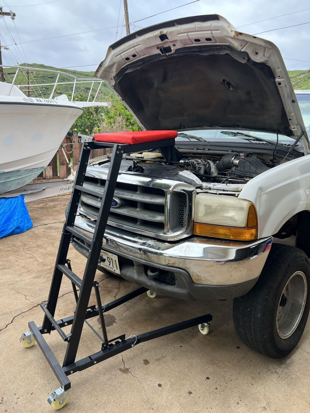

I will be checking the wiring this weekend. Was waiting for my engine creeper to get here...my back just can't take hanging over an engine anymore!!!

A topside creeper!? Those things will make you soft. Next you'll want wrenches that don't slip and bash your knuckles, and before you know it you'll be drinking beer from a glass. They are freakin sweet though, enjoy that one.

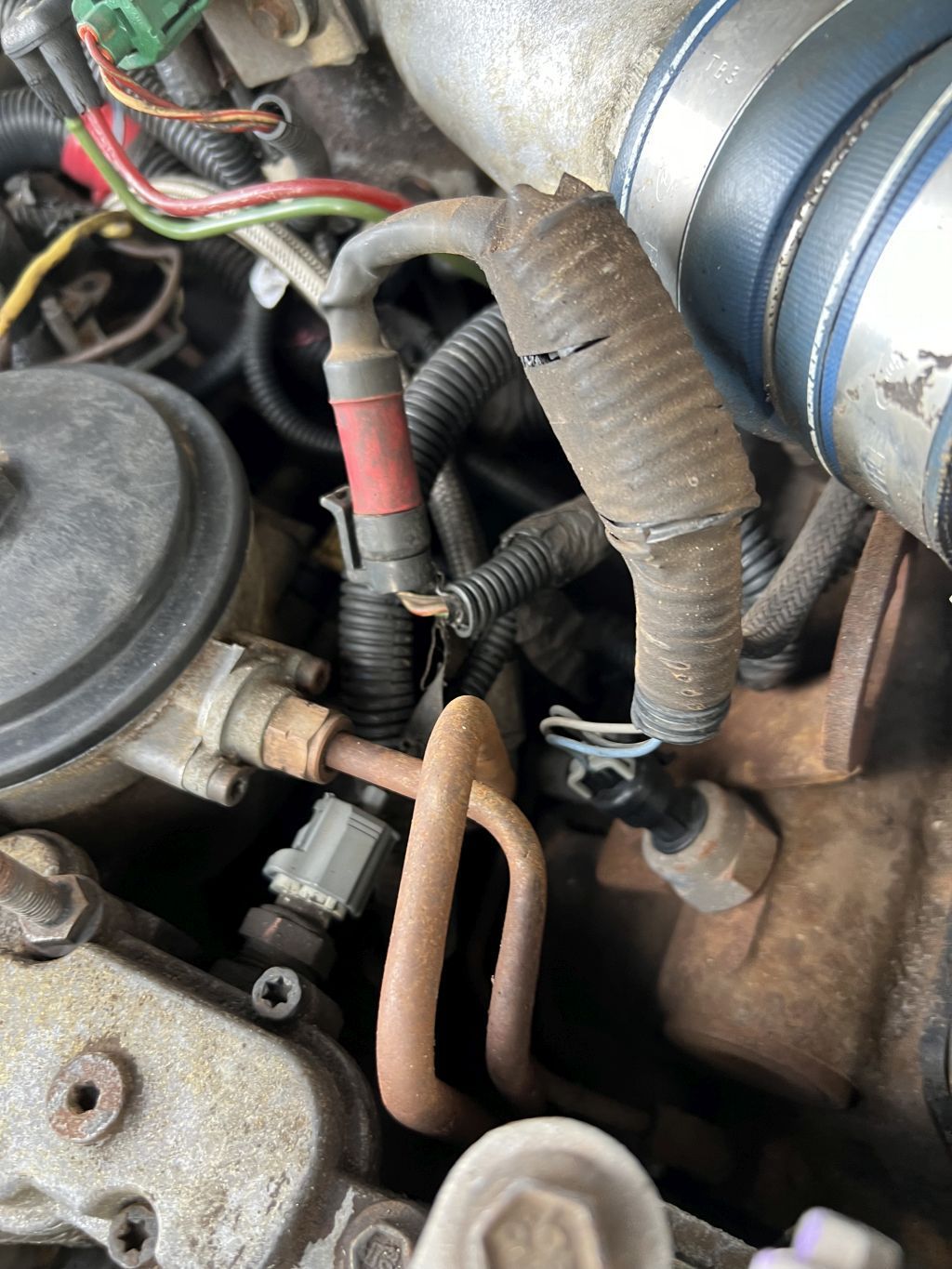

Follow the wire harness that trails off to the left of the photo, and take another photo of where that harness terminates.
We suspect that the "controller" wires will lead to the wire harness that serves the ICP (injector control pressure) sensor.

I did get an email back from Diesel Dynamics. Different company, they were nice and wrote back that they forwarded my email to the owner of the company that closed shop to see if I get a response.
Here is a pic where the ECU termination happens, it is taped up in this harness. I will pull it apart and ensure a good connection this weekend when I am under the hood...

It is a glorified 10K mod (or 5.6K, depending on if the resistor is inline or straddled with ground)... hidden in a "black box" to make it look like more wizardry than it really is, in order to charge more money that it was really worth.

OK,
So safe to remove it and repair the harness? Maybe figure out the resistance and add it back later if I want...
I have the Forscan cable on the way and the software on my laptop. Just dont want bad readings while I figure out the miss in the engine.

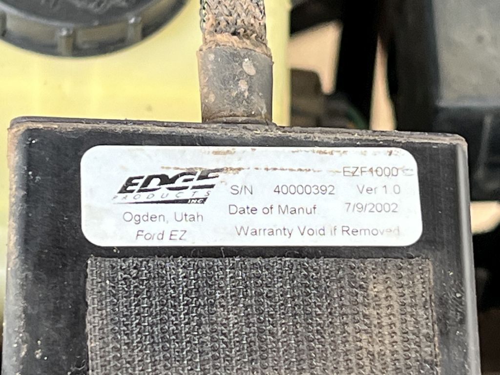

I just needed to get up on the engine and see what's going on. The unit looks to be an edge EZF1000, I just need to open and see what power level it is set at. The topside creeper takes a bit to get used to but it will save my back!!! Started the truck this weekend and there was no miss.

Wipe it with a moist towelette and put it on Ebay as vintage speed equipment
