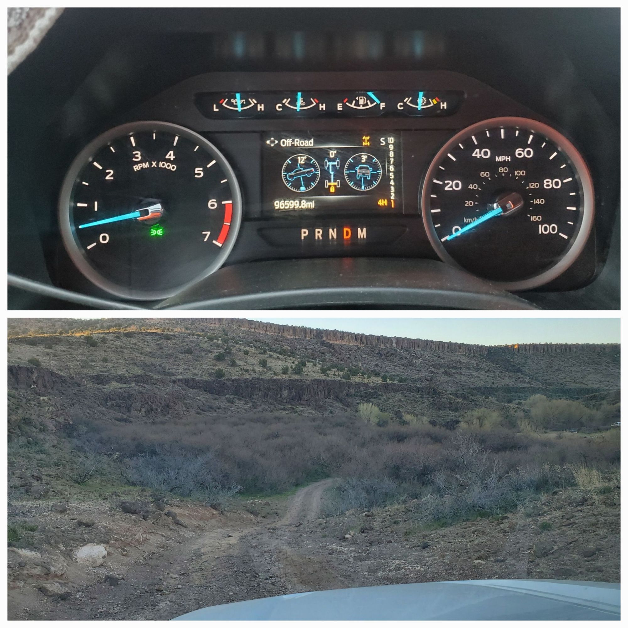

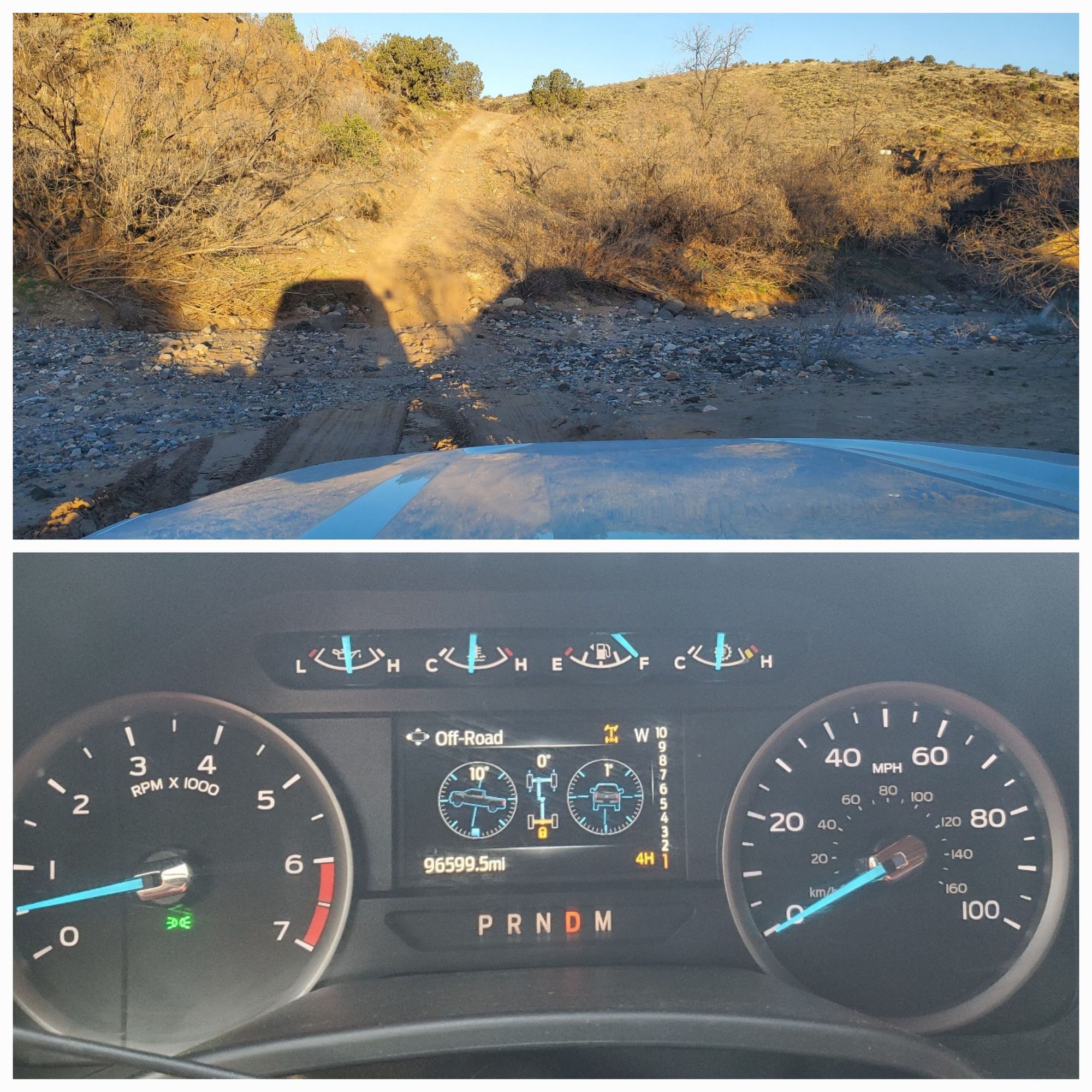

Feeling your knowledge oats this morning.... I'm sure you're right and we're wrong.
Or when I climb these and switch from 2wd to 4wd it's my imagination.
I'll respectfully disagree with you about how my truck shifts in to 4x4 .
From the manual which seems to be how it reacts and feels as the shift happens and the light activates.
