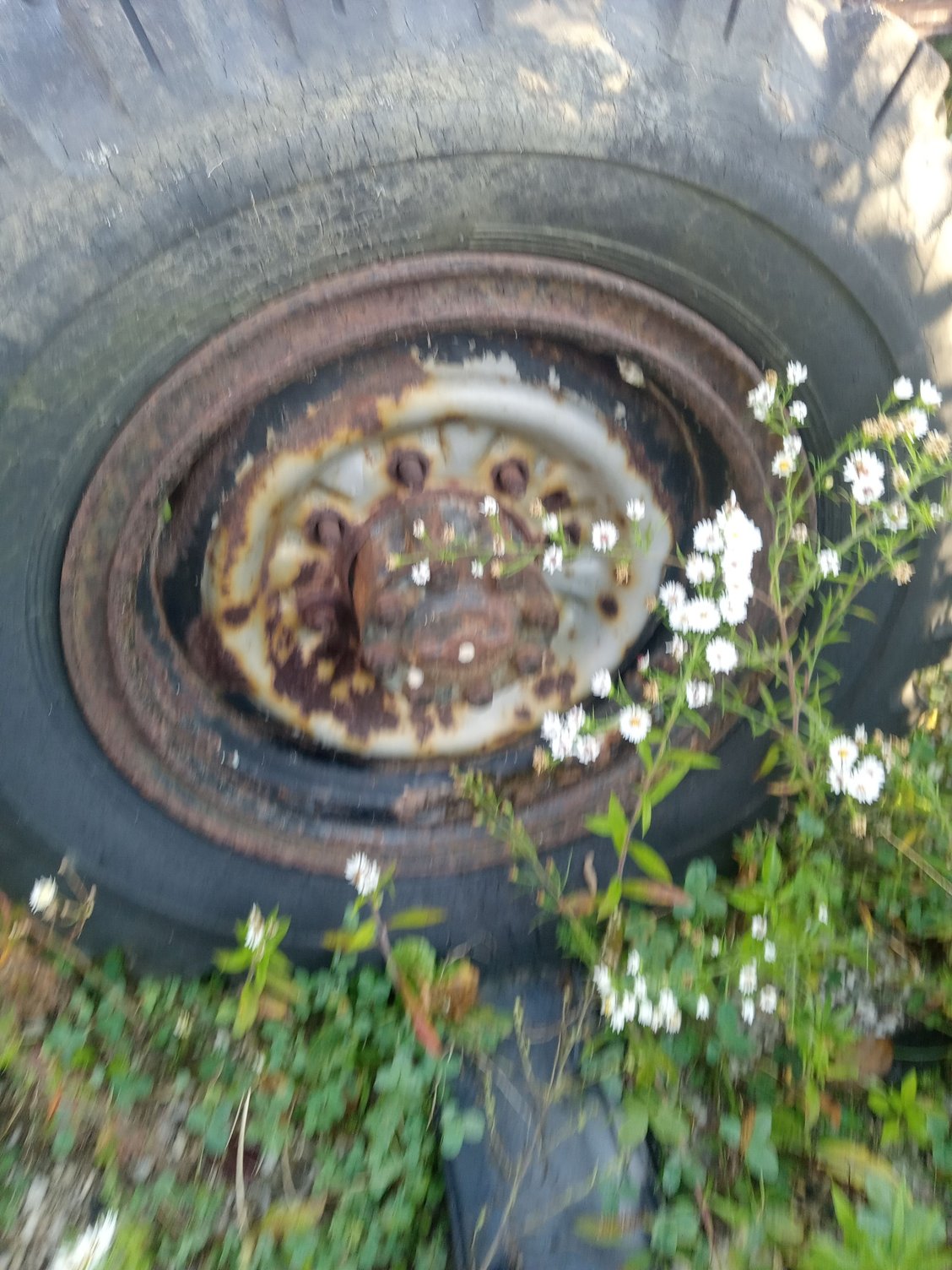

I’m looking at buying an eat up old dentside for the frame, I think the vin says it’s a F 150 but it has 8 lug rims on it . Any help would be appreciated

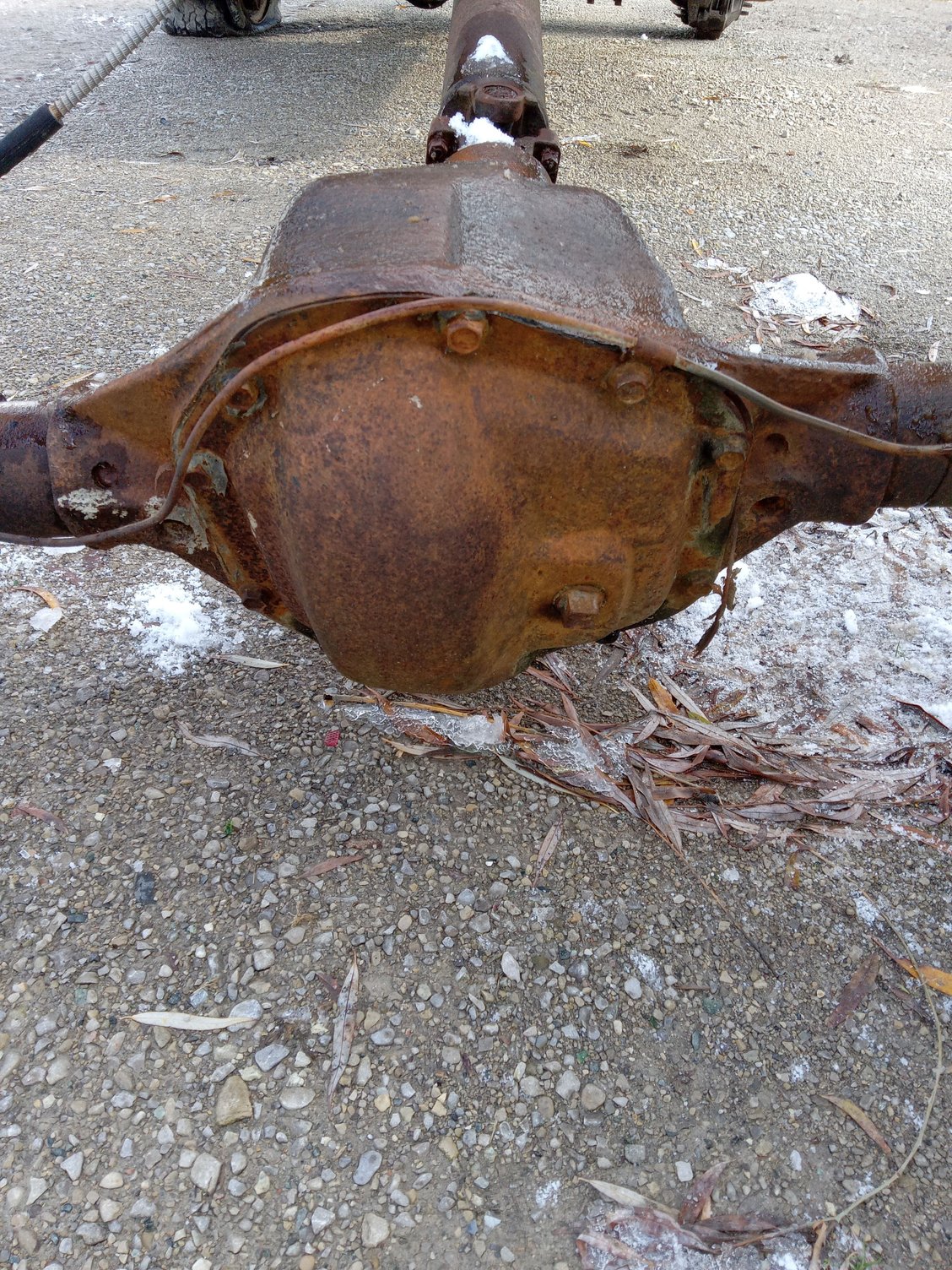

A F100/F150 should have a 5 lug 9" rear axle. Yes that is a 8 lug rear axle in your pic and probably a Dana 60 rear axle. The rear axle could of gotten swapped. Body's (cab's) get changed and or the complete top (cab and bed) get changed. Doors get changed. I would compare the vin on the paper title to the 2 on the frame. If the paper title does NOT match the TWO on the frame, then you have some questions to ask and a decision to make.

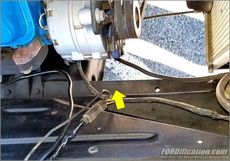

2wd vin in line with the alternator, on top of the frame rail.

85e150 for a game, set and match. You speedy decoder you. I was just sluffing along at it. But I at least posted of pics of 1 vin location. So nana nana bobo.

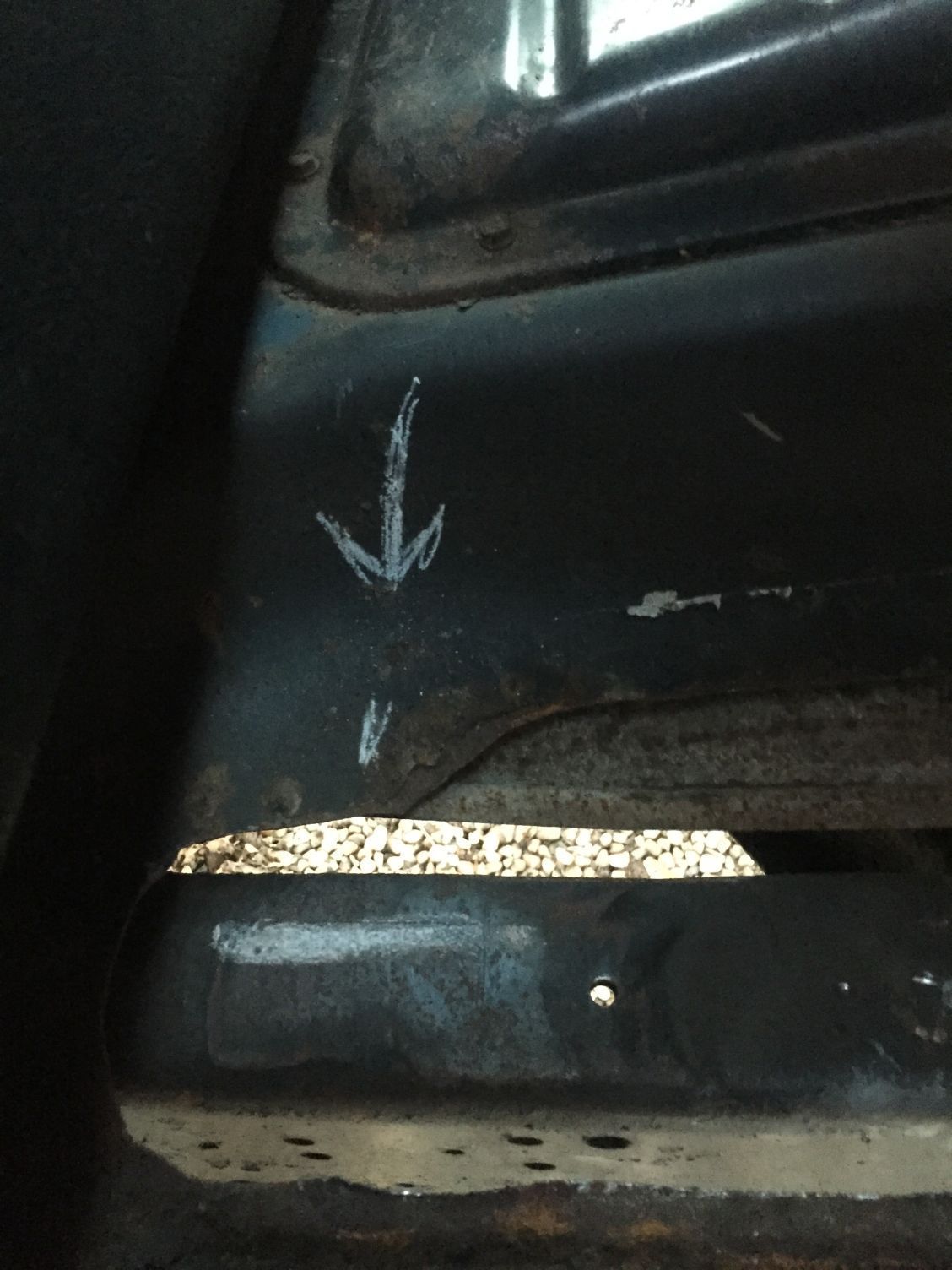

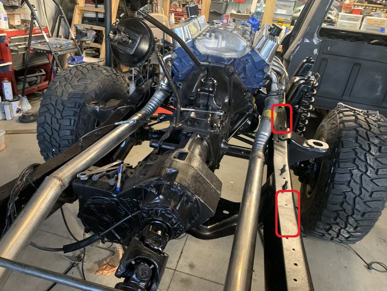

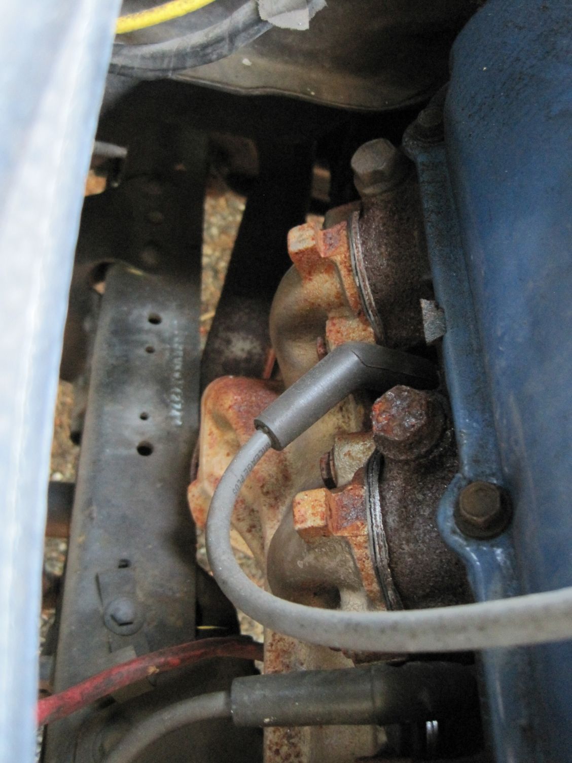

Yes, see pic. Passenger side, top of frame rail, under front seat bolt area. Hard to see clearly. So it is a 4wd truck? You have a Frankenstein truck for sure. And on a 4wd the vin is here on a 4wd frame. Red box is 4wd vin location.
In the fresh primer area, where the 5 holes are in the top of the frame rail.
Obviously you are not going to cut a hole but it the floor pans are rusty. The vin is the white line that the arrow is point at.
Under the cab trick.
1/2 and 3/4 ton 4wd vin location.
4wd
4wd fwd one.
4wd rear one.

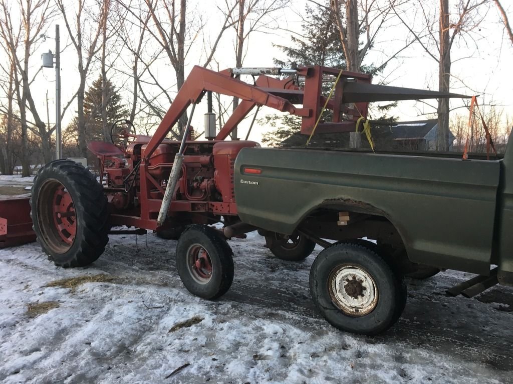

Another question anyone ever moved a frame with wheels only on the front axle ? It has a rear axle aswell but no wheels

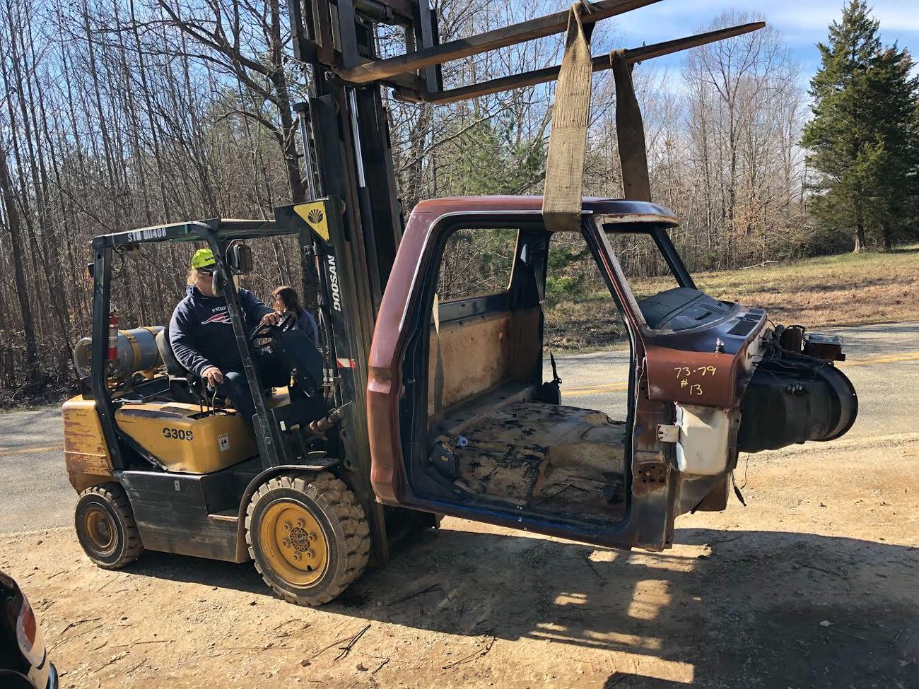

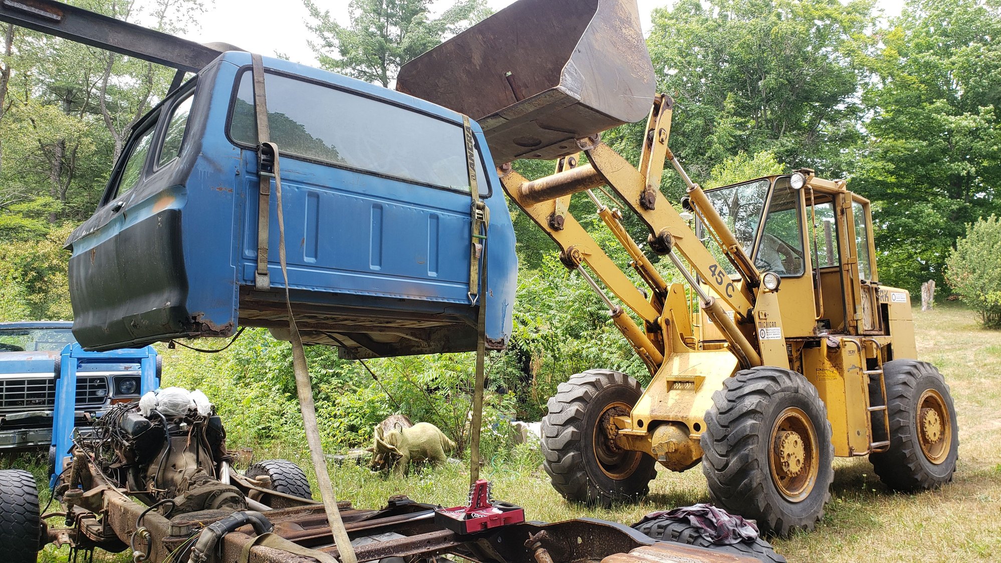

Is it outside, in the dirt/gravel? Yes just put some steel wheels on the back and tow/drag it. If it is inside on concrete. Get some car skates.https://www.harborfreight.com/2500-l...ece-58394.html
Worse case set each rear brake drums inside and old tire and ratchet strap (pull the tire) to them to make them "tight" and drag it where it needs to be. NO sideways pulling.
Skid steer, tractor with forks, fork lift, excavator, wheel loader.
NOT OSHA approved.

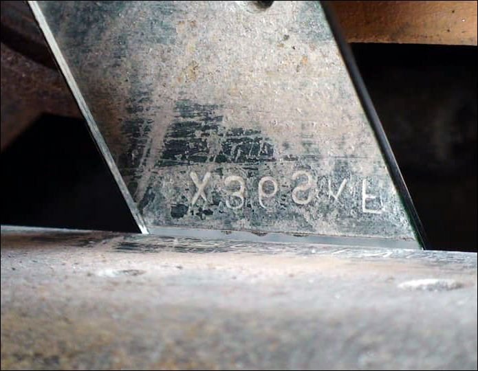

This is what I found
