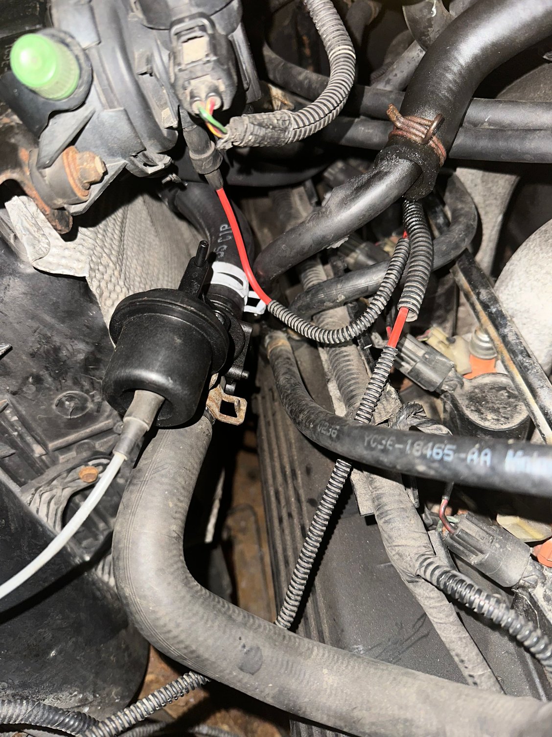

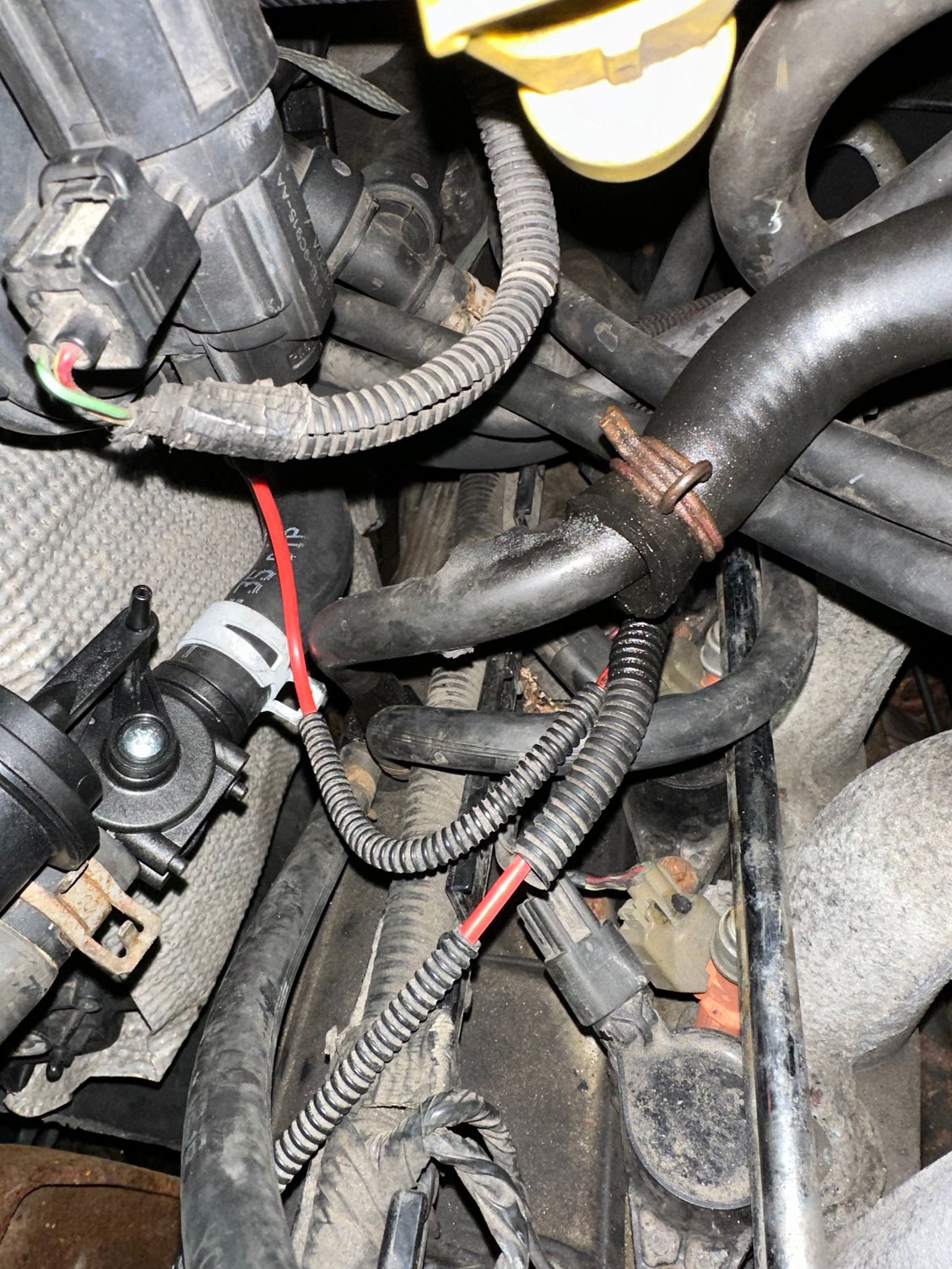

Originally Posted by samsdad02
I used the 6.0 hose as I could not find a 6.8. I had to rearrange how all the hoses lay.
Any chance you can take a pic of how you routed the hose?

Old Dec 20, 2023 | 04:34 PM
samsdad02's Avatar
samsdad02
Joined: Jul 2009
Posts: 705
Likes: 12
From: Taxachusetts
Sorry for the delay. Haven't had a chance to get to it plus I was still working on the sticking brake slides again.
I used the old hose from the feed to the heater shut off valve. Hope it helps
