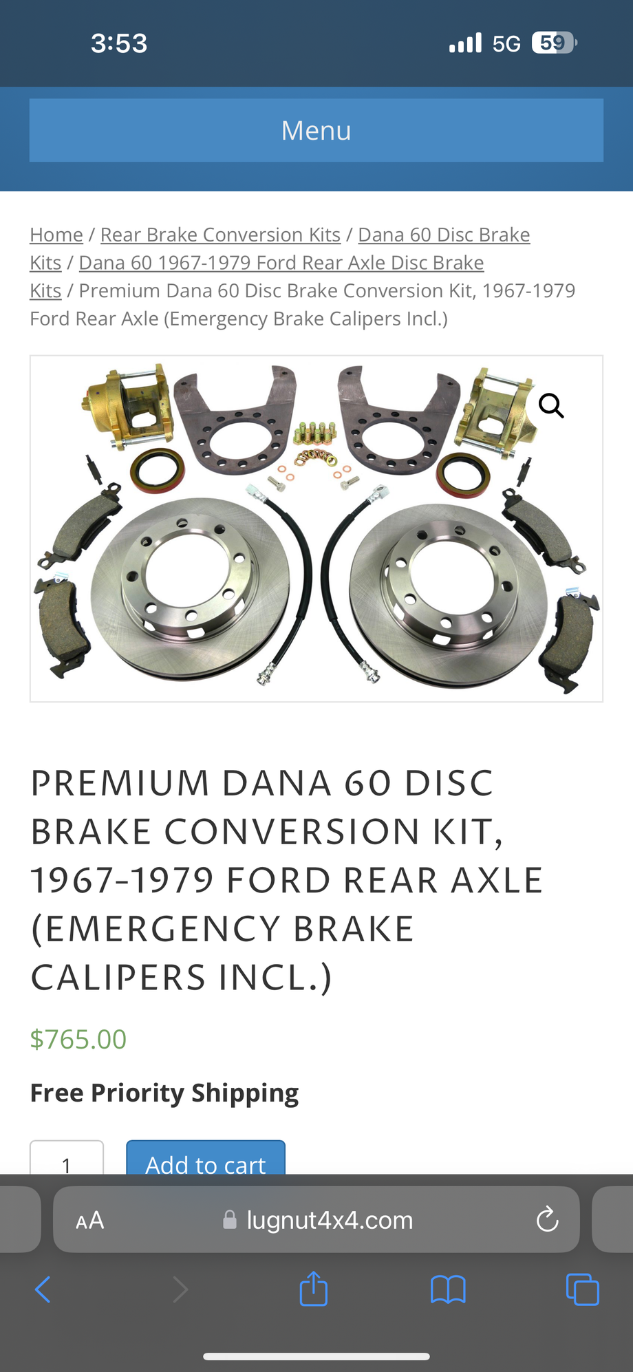

I have a 1977 ford f250 2wd and I did a brake conversion kit on the rear axle to disc and I’m needing to find a master cylinder that will work with my disc disc system I was wondering what are some master cylinders y’all would recommend? And will I have to change the booster?

Lonestar 4x4 kits the rears are disc instead of drums

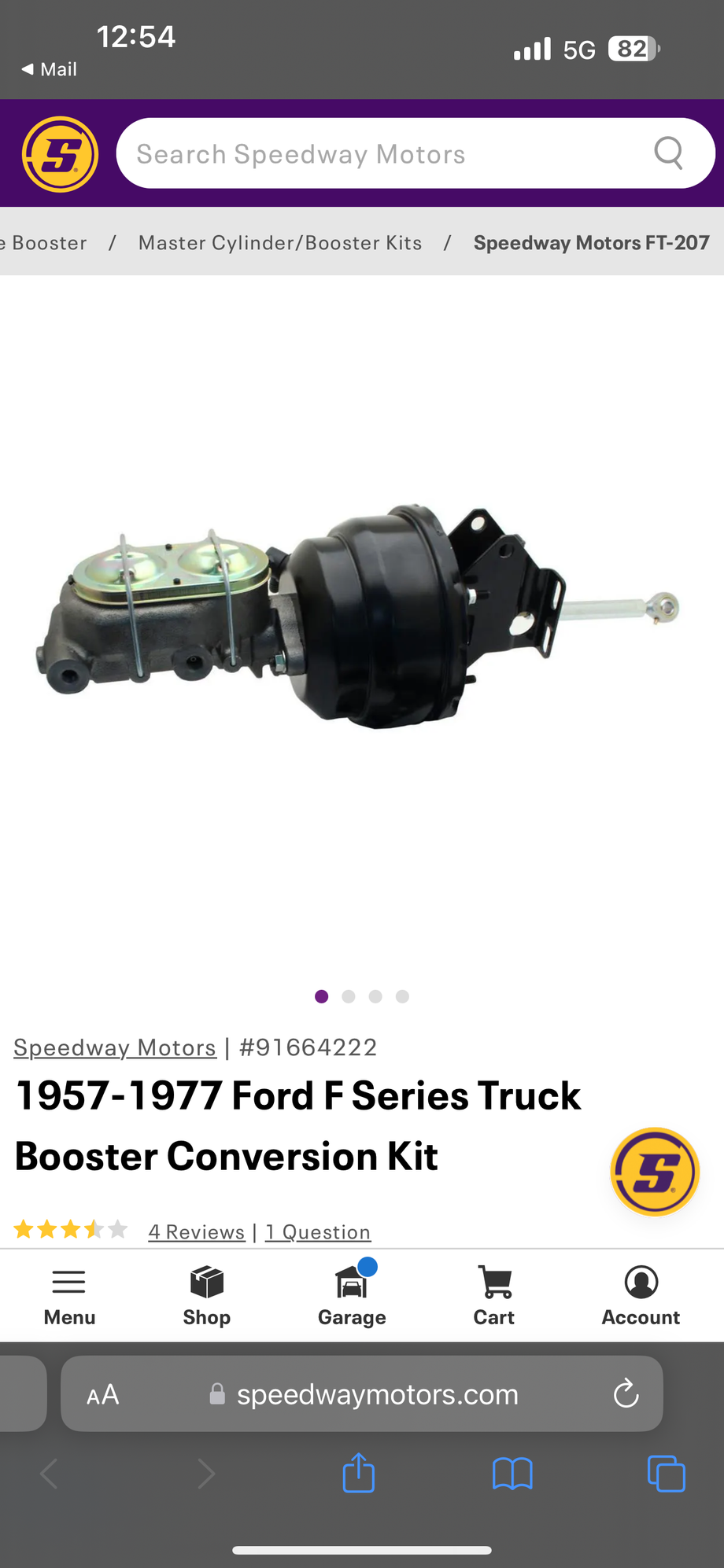

I found this kit online might try it out and see? Idk

The single caliper MCs have a 1'' bore, whereas the dual calipers have a 1.0625'' bore.
Your OE one probably looks like this (note the port tube nut sizes) :
https://www.rockauto.com/en/moreinfo...1836&jsn=11434
This is the one I'd consider for your setup, taken from a 1995 Bronco (note the port tube nut sizes are swapped over and larger bore) :
https://www.rockauto.com/en/moreinfo...1836&jsn=11078
It is not a disc/disc MC, but would work just fine.
The mounting holes might require slight modification with a drill bit.
3 benefits over the horrible cast iron OE one :
1. Fluid level checks at a glance
2. Air not allowed into the fluid upon checking
3. Reed switch can be easily wired to a 'fluid level' warning light which is a far superior warning system than the crap ''pressure differential'' OE setup.
The above pictured dual diaphragm booster should be more effective than your OE single diaphragm one (without the crap MC. LOL)
I assume you had to fit different e brake cables. (Flat faces as opposed to diagonal faces)
That said, I would follow the above two suggestions first.

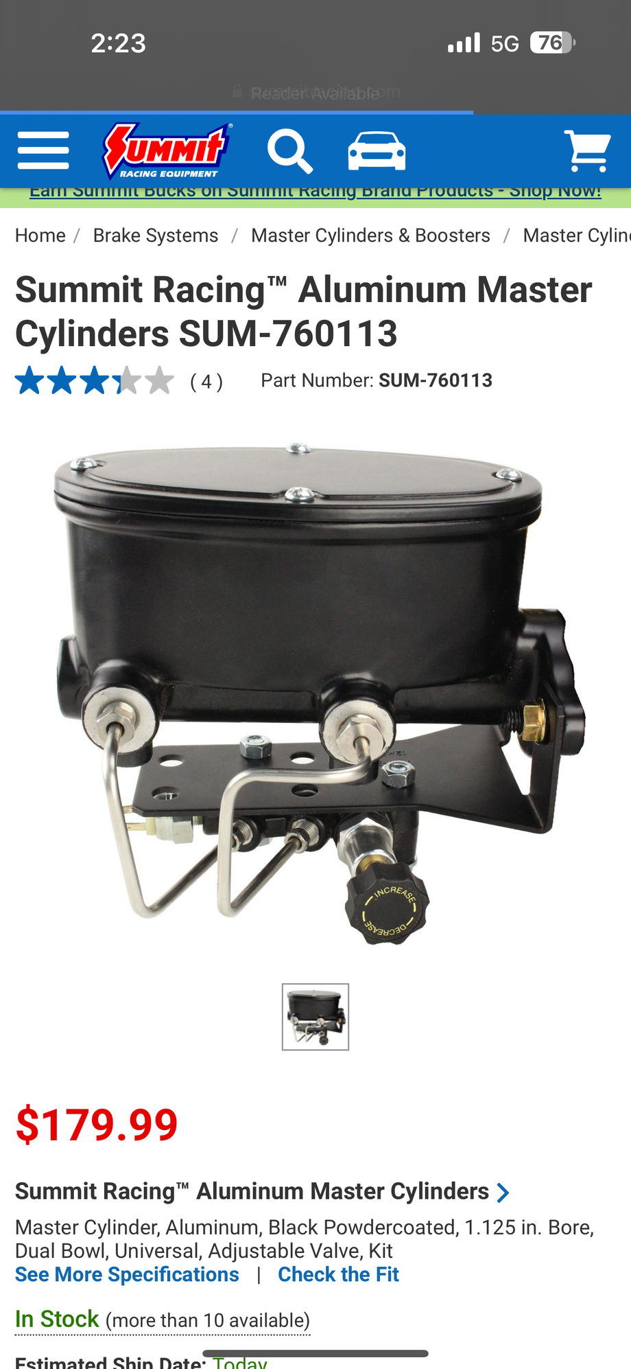

I appreciate the suggestions and I will look into them for sure! I did just remember this master cylinder on summit I found awhile back I actually bought it but returned it because idk honestly lol but it’s a disc disc master cylinder and it fit on my oem brake booster I wounded if that would work?
https://www.summitracing.com/parts/sum-760119?rrec=true
Old Dec 5, 2023 | 02:40 PM
6 by 8's Avatar
6 by 8
Joined: Dec 2020
Posts: 869
Likes: 186
From: Near my truck
I don't like those either, but that's just me.
It's a knock off of Wilwood.
Note the proportioning valve (PV), which is not a 'combination valve' that you have now.
The PV is why they say it is a disc/disc MC.
The bore might be too big for your application, depending on what the bore size actually is !!
Read the 4 comments on that web page for info.

On the website summit racing it has the bores are 1.125 inch on the MC and I was thinking about using it for the look and i was going to remove that valve and just use the one I have already so im not making new brake lines
my calipers are factory in the front single idk the bore size but the rears from lugnut 4x4 there 2 5/16 bore single caliper

I did forget to mention I emailed the company about what they recommend for a master cylinder and there saying they wouldn’t change anything
