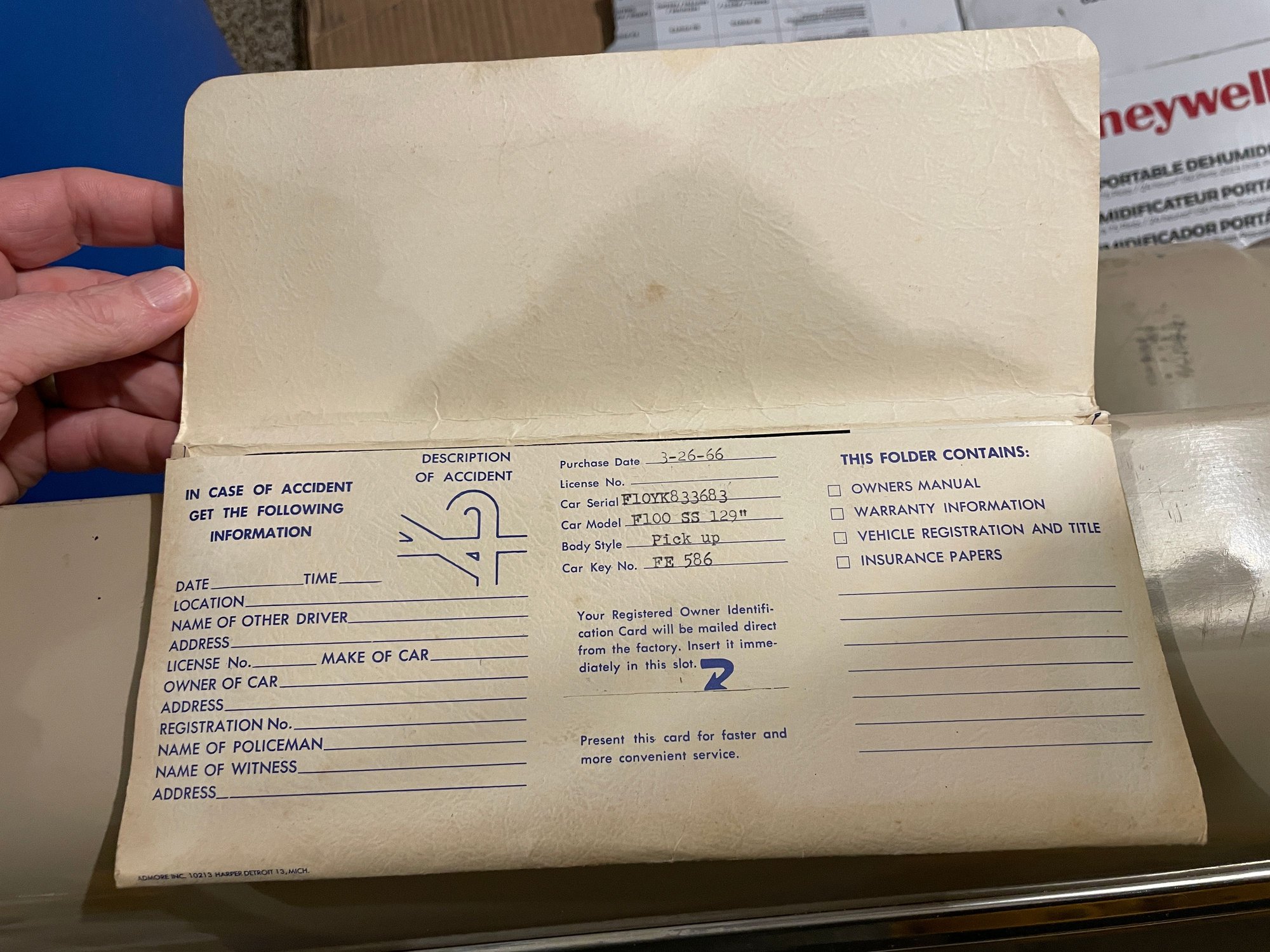

In pic 2 the square corner tag was glued to owner card. If warrenty work was needed it was laid in machine like what was used back in early credit card days and applyed to work order . It looks like Ray Losh special ordered it but looks as if all spaces are filled .

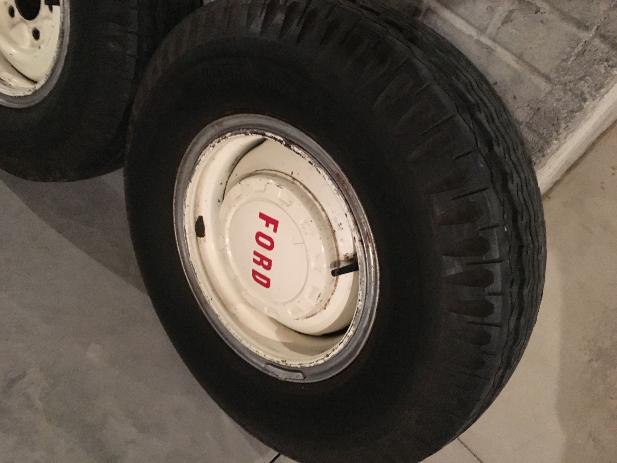

Camper Special was a Regular Production Order (RPO) item even in 1964 - a year some people say they didn't make any. So that wouldn't have been a special order item. I'd suspect the tires were the special order item since I've seen similar. Here's my build sheet for one of my 4x4 trucks along with pics of one of the tires which is a GoodYear Hi-Miler (HM) Xtra-Grip - second set of tires at the bottom of the build sheet. Nothing else that I can figure was special ordered. Your truck was built on March 14, 1966. The ROT or Rotation number in the upper left corner is blurred but that number was typically written on various parts of the vehicle. In my case it is a 0152 for this vehicle. That's how they tracked the vehicle during the factory build.
