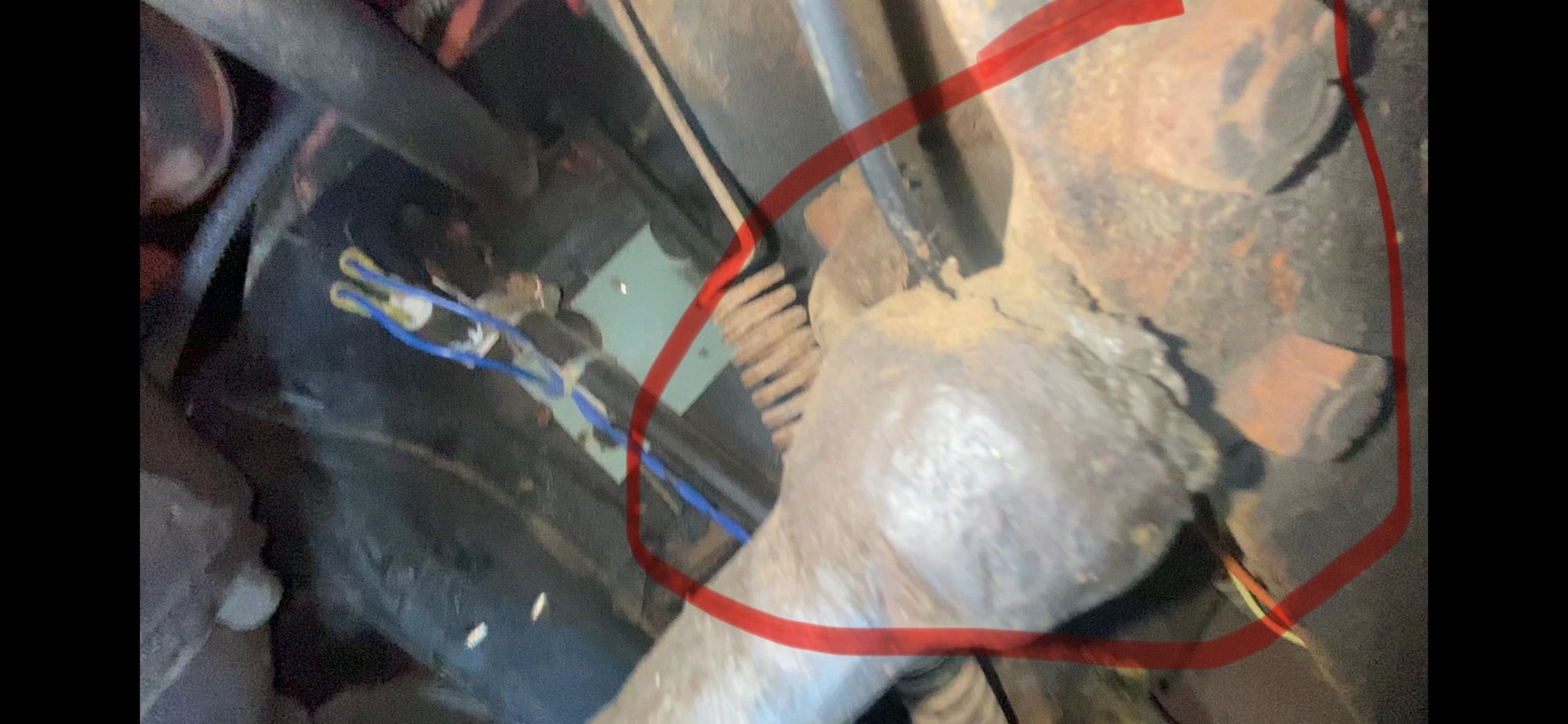

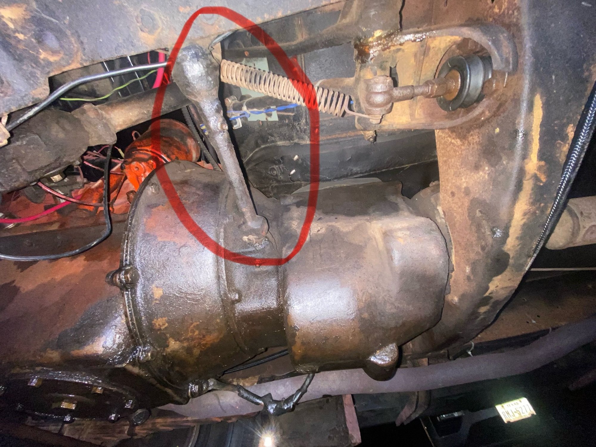

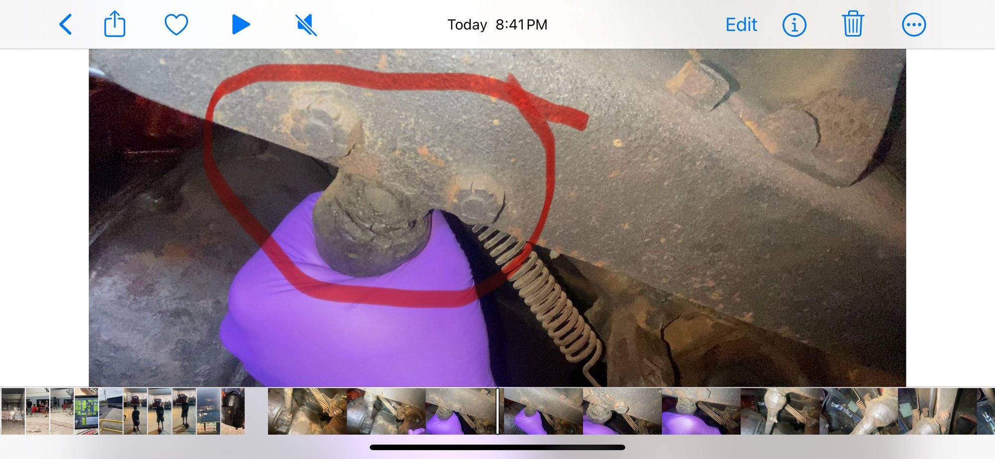

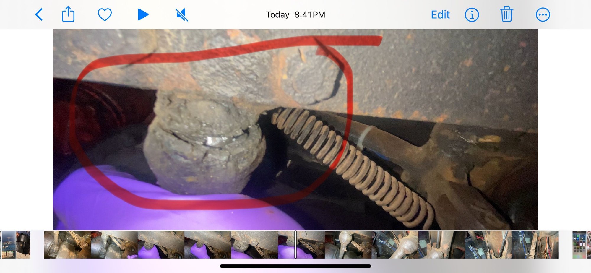

When I engage my clutch and slowly let off of it, I hear a clunk whenever I hear the clunk, my clutch somewhat releases on its own, and the truck takes off. I’m trying to narrow down the problem. I am not sure if it is the shaft or where the shaft meets another part bolted onto the frame pictures are below. Sorry for my poor explanation.

Couldn't hurt to remove the transmission floor cover and take a peek through the inspection port and see what is going on in there.

I agree. The truck still runs fine and shifts fine. My only concern is the clunk I hear when releasing the clutch, leading me to believe it may be linkage. As soon as I took a look I noticed that shaft had play and my search stopped there, but I will take your input and look a little further into it tomorrow. Thank you.

The bushings were my first thot. The ball bracket they wrap around can also be worn and might need replaced. There are 2 styles, early and late. Yours is the early style used in 42-47 trucks also.

Looking at that release lever, you could have several things going on. Taking that off to clean it and install new bushings and a seal would be a good start. The bracket with the marsden nuts, the ball may be worn egg shaped. Doesn’t look to have ever been removed.
As others have said, open up the inspection cover on the trans and see how everything is moving. I have seen bent release forks, worn release housings, etc that add up to big problems but fixable.
