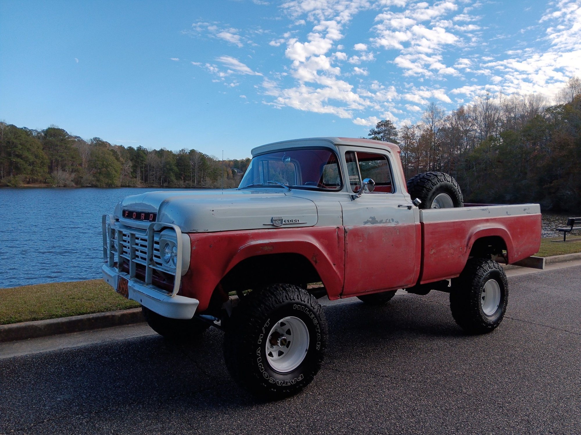

Originally Posted by bald59
Mine defiantly does not need to be any higher.
Can the bushing be done without removing springs?
That does set up nicely! Nice pic.
