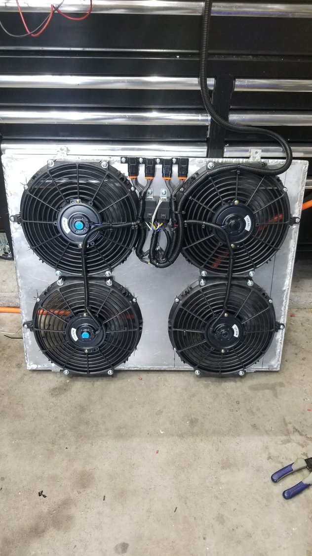

I just did mine, swapped to full electric all aluminum

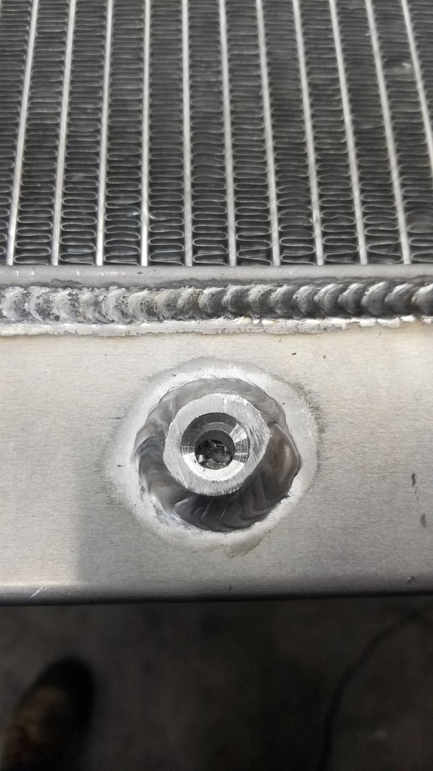

I had to drill and weld on new -AN fittings for the trans cooler.
ALL the radiators out
Rive nuts, some aluminum, a 175off 195 on switch inline on the lower hose tapped out to 3/8 -6an fittings as the aftermarket lines are way to small. 4 fans dual ball bearing from summit with 2 relays for AC and the switch. HUGE upgrade

you can put a temp switch anywhere you want, the trick is that before you had a POS clutched fan that was ALWASY ON and even though the clutch "works" its taking a considerable amount of power from the engine.
NOW I have electric fans that do have a life span, if they were on all the time they will last a lot less. MOST of the time you are driving so the fans are NOT necessary. Mine only kick on after i get to a light for too long.

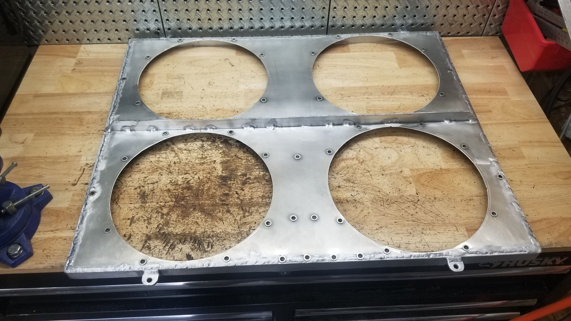

If you put the switch on the block, the fans will run all the time, if you put it on the top of the radiator at the unused bung it will run some of the time even when you are moving. If you take the temp AFTER the radiator it will never run unless needed. I did a lot of testing and this is the best way to do this. no one sells a 4x4 radiator shroud, only a 2 fan
If i did it again i would use a proper DIY fuse block i did not know exists now!

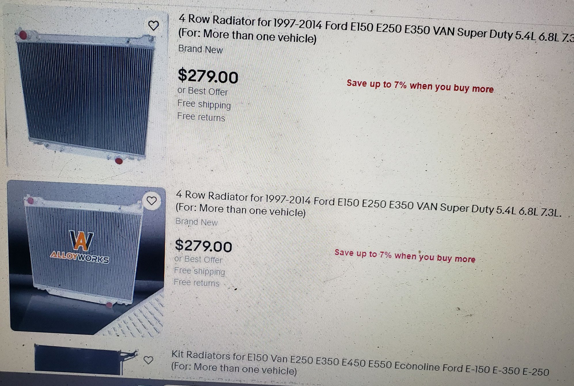

Back to basics: I'm looking for options/brands that fit current configuration but might be heavier duty/cooling. Aluminum no plastic.

I replaced mine with an all aluminum one a few years ago and love it
This one is not too expensive off Ebay

Looks Familiar!
like i said, ALL of these radiators are ALL the same made by the same maker in china, they rebrand them to other sellers on ebay, summit, amazon etc....
you WILL have issues with the trans cooler line being VERY small
When you get yours, pressure test it to 20psi before your return window closes.
I had one that had a bad weld pin hole leak, fixed it with my TIG
