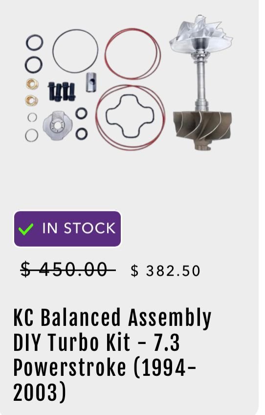

This is showing up on KC’s sale page unless you’ve already picked up the billet wheel and rebuild kit.
I like the Riffraff 4+4 wheel better than their 6+6 for my application...plus I already have it, so I just need the S300 turbine for that turbo...
