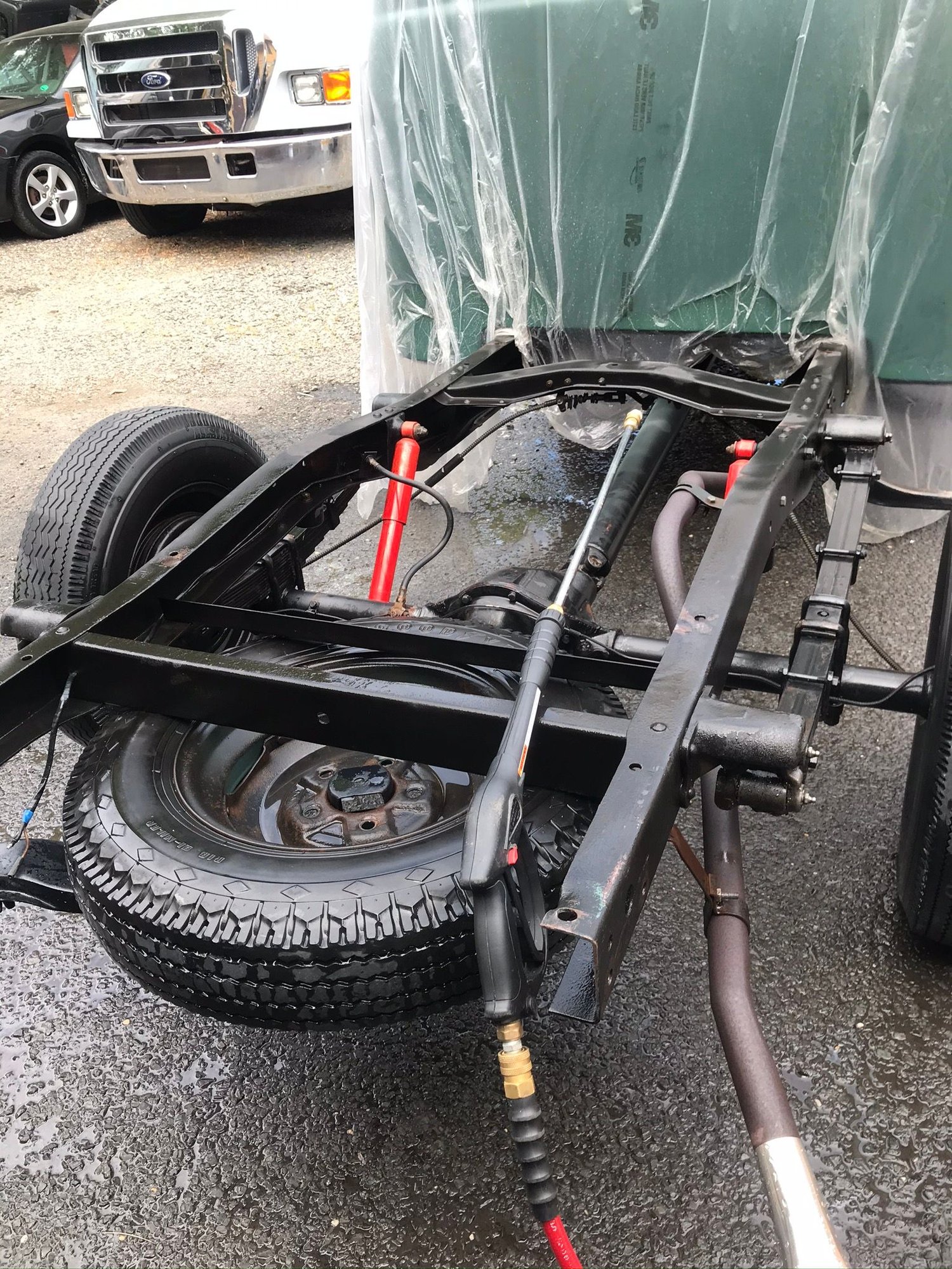

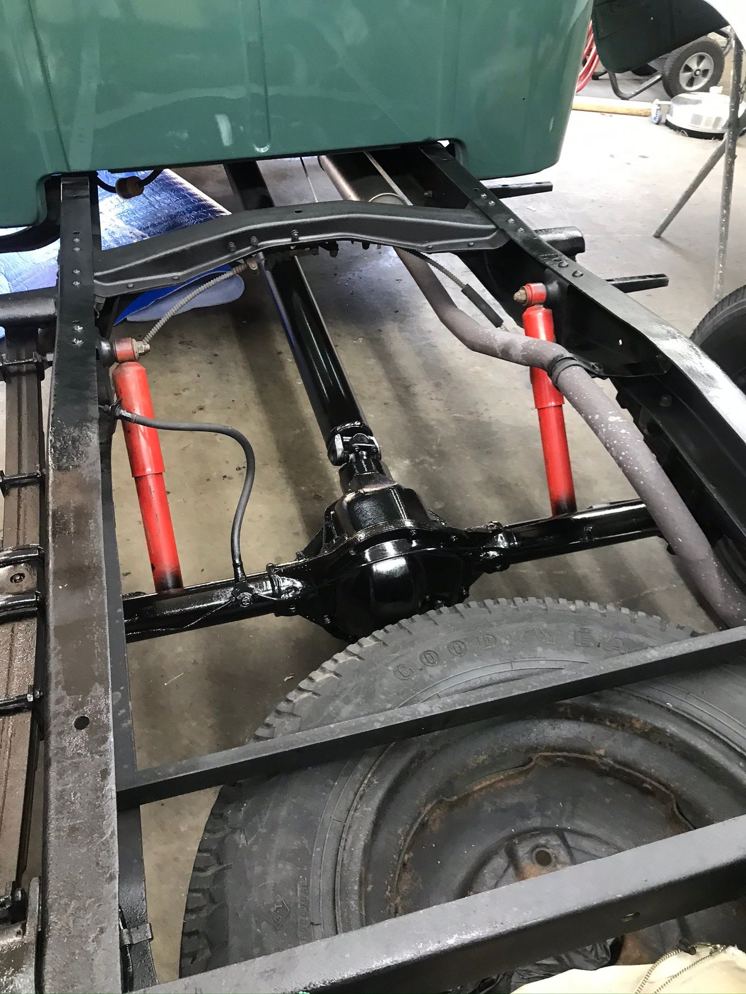

When my truck was apart I tried to remove a small section of it from the frame but after pondering the possibility of it I decided to embrace it. I was told it’s cosemoline. I actually found the stuff still for sale in spray cans. Probably not the same thing as what dealer used in 52 but it’s close, and it repaired the small section of frame coating that I worked on.
My truck was built in Somerville MA as well and was stored in a barn only yards from the Atlantic Ocean for 30 plus years there’s not one spot of surface rust anywhere.
So in fact, I’m such a fan of it; even if I did a frame-off concours restoration, whatever that means, I’d still apply it! I’d argue since it definitely was a dealer installed item that makes it factory correct.
