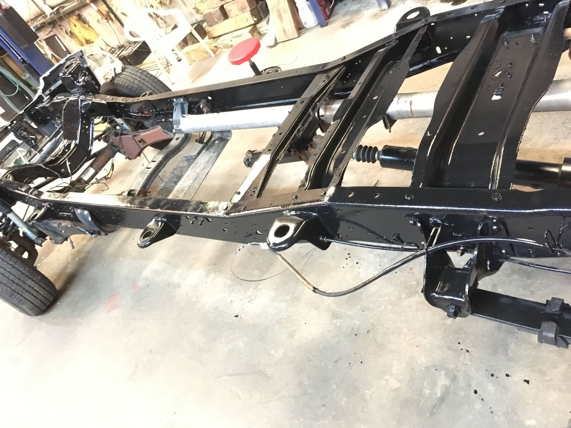

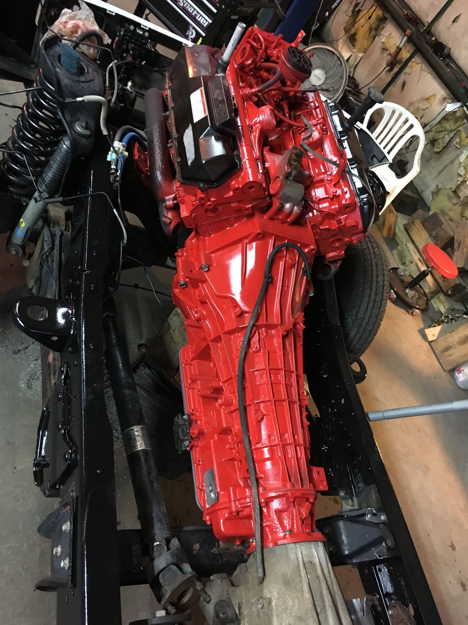

It is unlikely the cab on a rotten frame would be worth investing the time a frame swap would require.
It is possible to buy an ‘05-07 complete, rust-free (southern) truck with a blown up 5.4/6.0/6.8 engine for as little as $1000 if you don’t mind a few dents and dings. (You can even recover some of that by selling the parts you won’t need). Then swap your 7.3/ZF6 and ALL of the wiring harnesses to the new truck. I’ve done several of these swaps.
