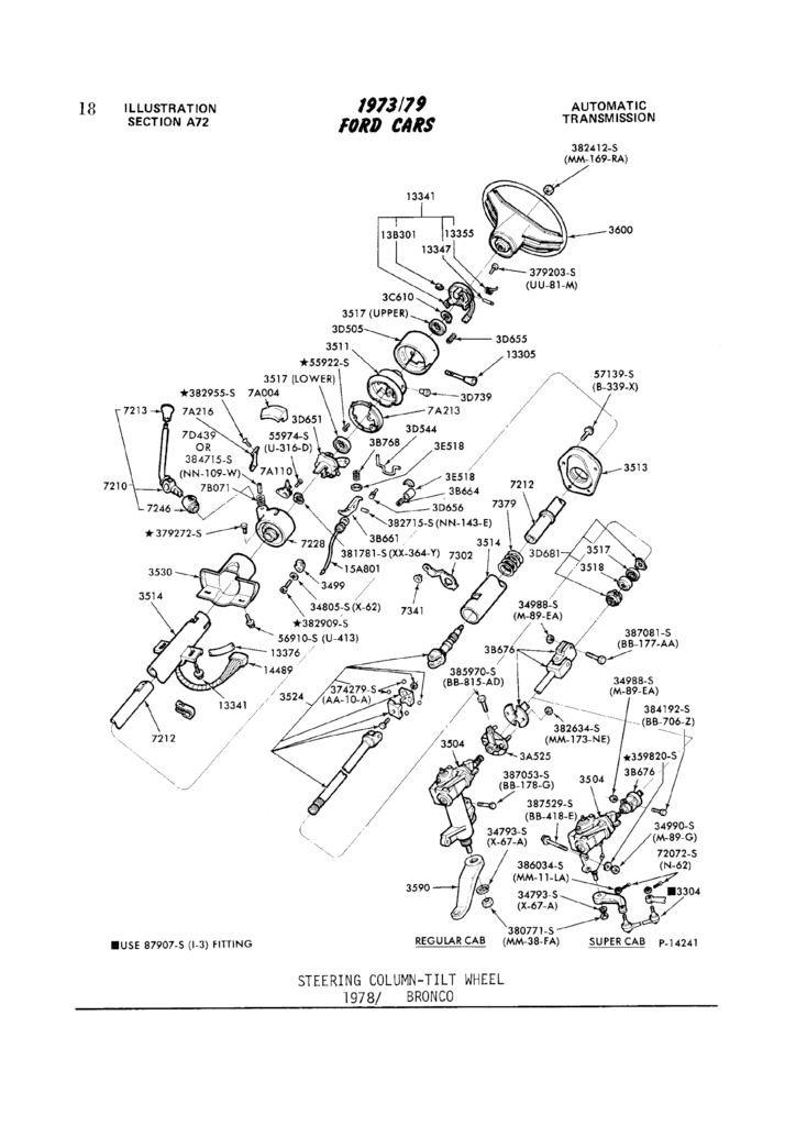

I have a project I am looking for parts for. The truck is a 1978 Ford ranger explorer. It is 4 wheel drive and automatic. I need a steering column with tilt wheel column shift and keyless.
Do you all know of any interchangeable parts possibly? Prices are up there.
Thanks
Old Nov 11, 2023 | 10:23 PM
77&79F250's Avatar
77&79F250
Moderator & parts slinger
Posts: 50,170
Likes: 5,789
All are keyless columns, key was in dash until 1979, then in 1980 it went to column. So you just need a 77 to 79 F150, F250, F350, or 78/79 Bronco, and of course 4wd and auto trans. The tilt request is going to drive the price up thru the roof, if you are needing a complete assembly. Reach out to Thopper67 he had a complete rebuilt one for sale a little bit ago. https://www.ford-trucks.com/forums/member.php?u=947649
