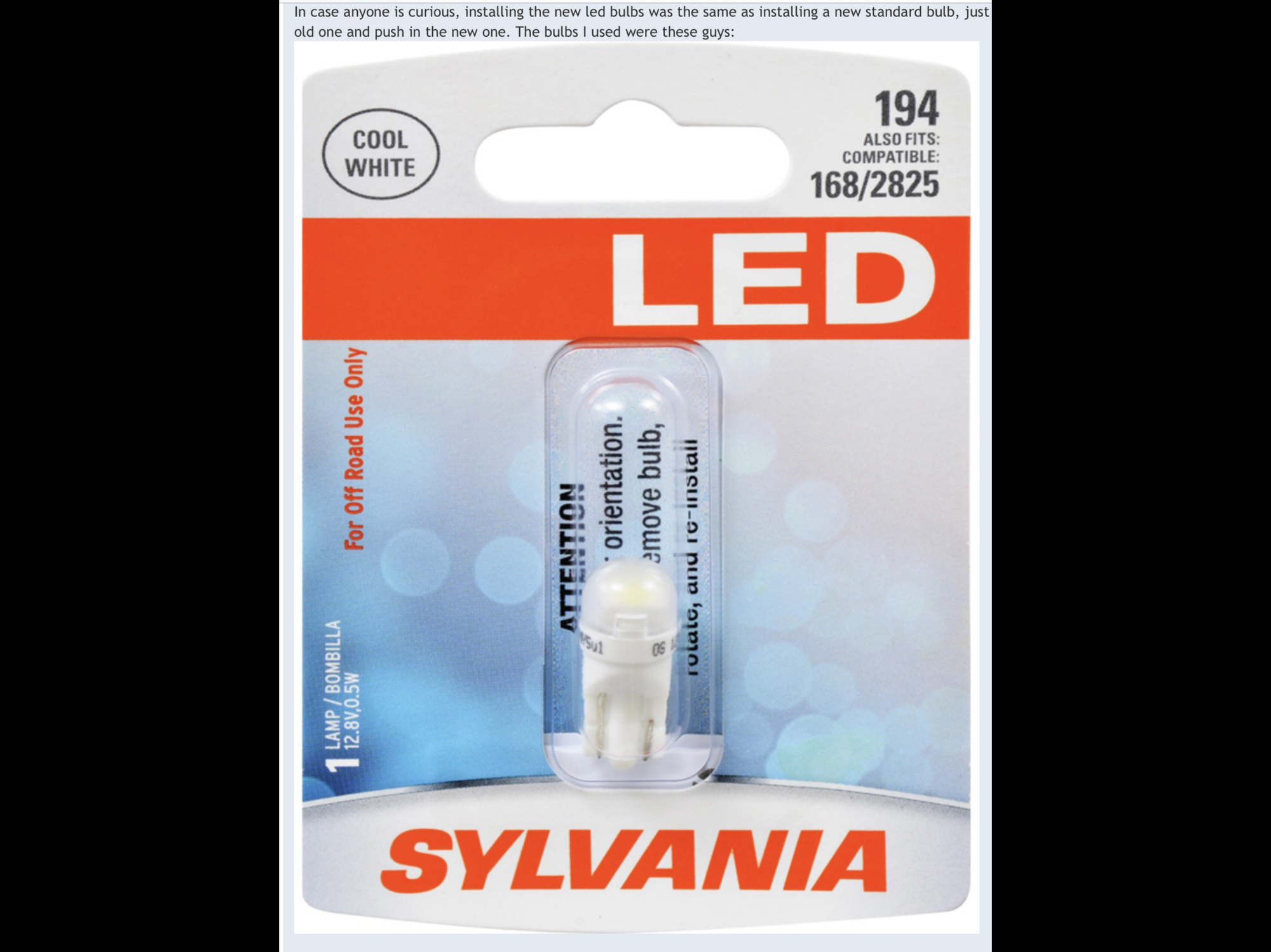

Suggested as a LED replacement for dash bulbs.
