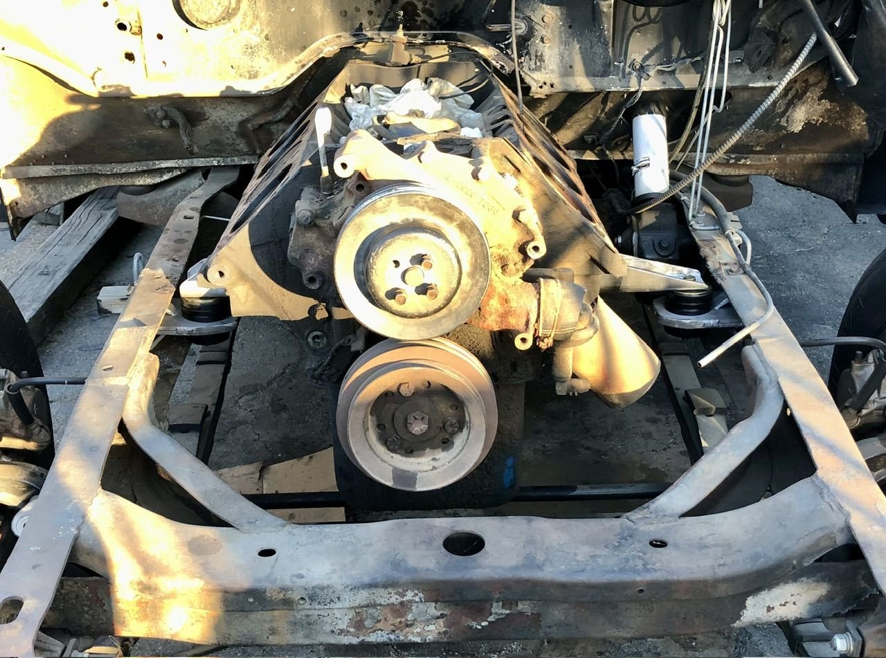

I mocked up the install.

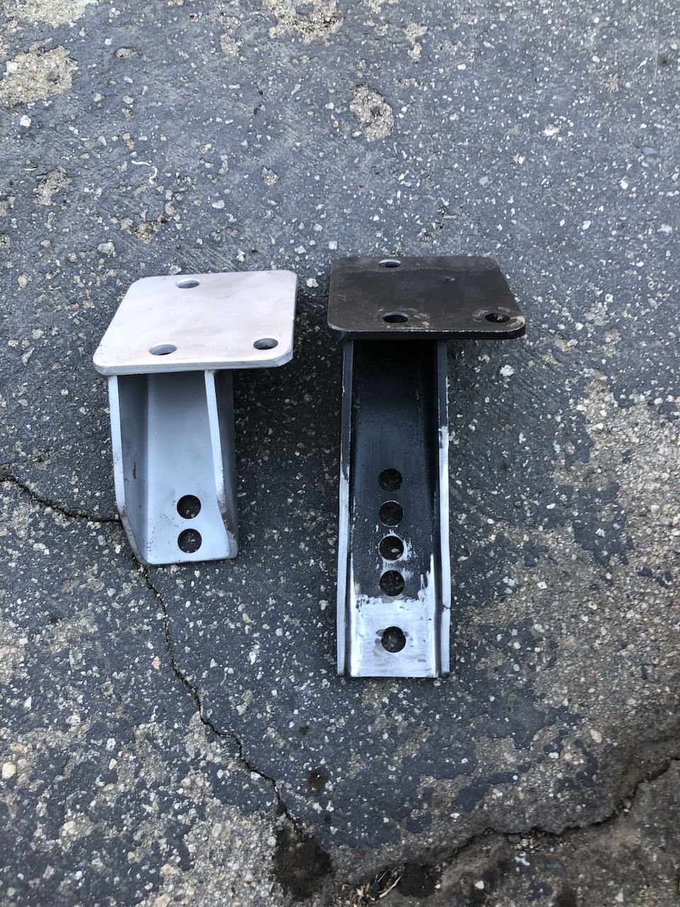

I bought some universal mounts from Speedway too, just to see what they were like.
Speedway mounts on the left, kit mounts on the right

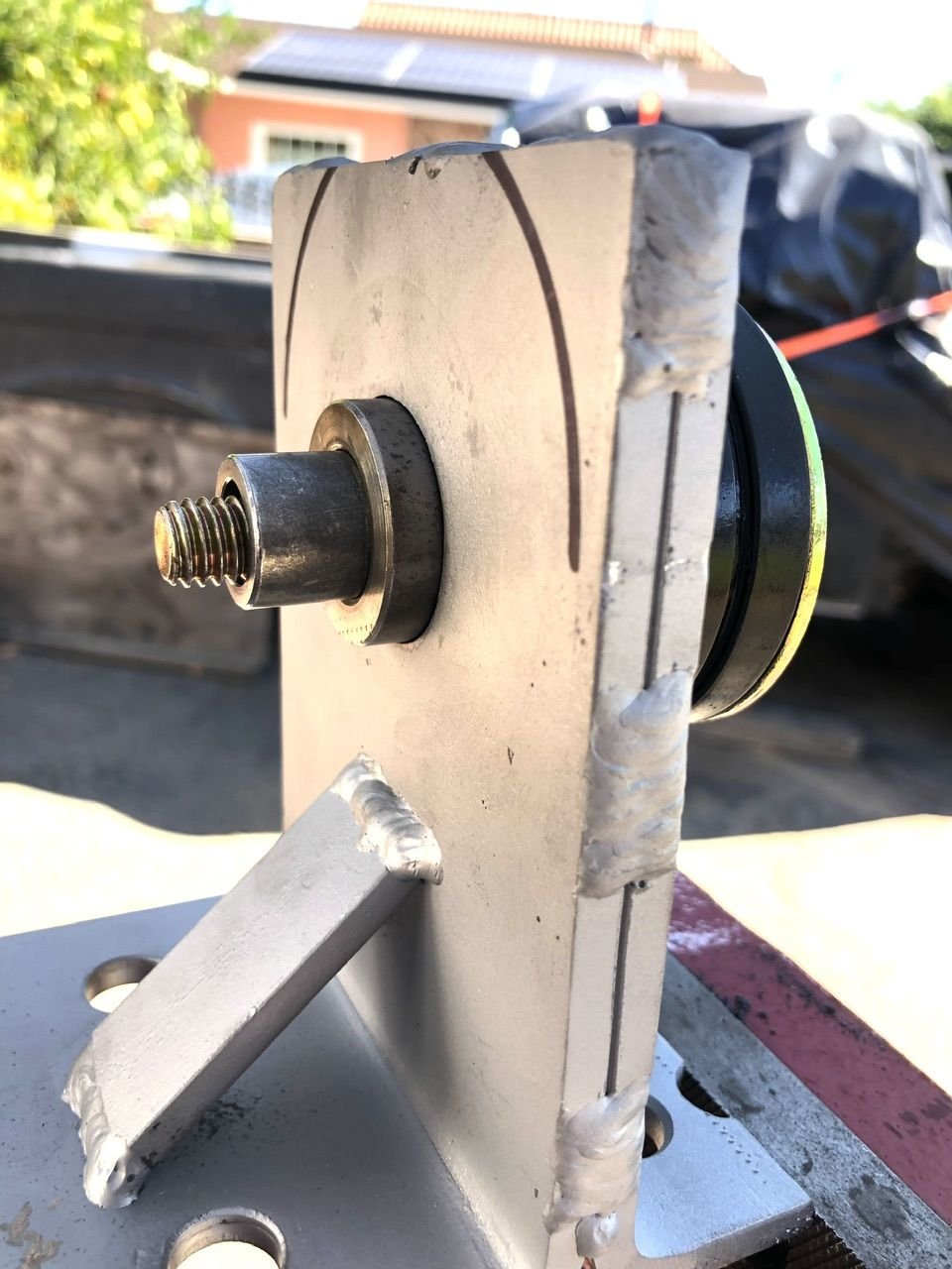

Urethane mounts
I had to replace the bushing in the center of the urethane mount because of the increased thickness of the frame mount, once doubled
