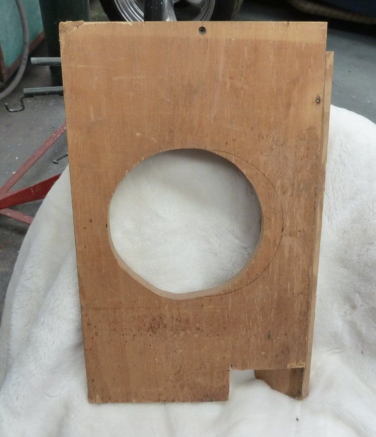

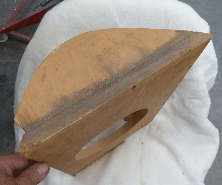

What you choose will be based upon what you are looking for in the way of audio. I have two 8" woofers, one on each side of the cab in the lower corners behind the seat. Two coaxial speakers (mid and tweeter), on on each side in the kick panels. 1200 W amp under the seat and a Kenwood head unit with NAV and video (DVD and front and rear cameras). Here is how I built the woofer boxes...
1st pic is from the underside, 2nd is face-on, and last is top down...box fills the space between the seat and the cab skin.
I chose to modify the dash to mount the head unit but it could have just as easily been mounted on a dash extension or console.

I appreciate the replies. Lots to consider. Mounted my fuse box in the drivers side kick space. Charlie I like your mounts in the rear corners.

Sorry that I don't have pics of the mounts with speakers installed...
