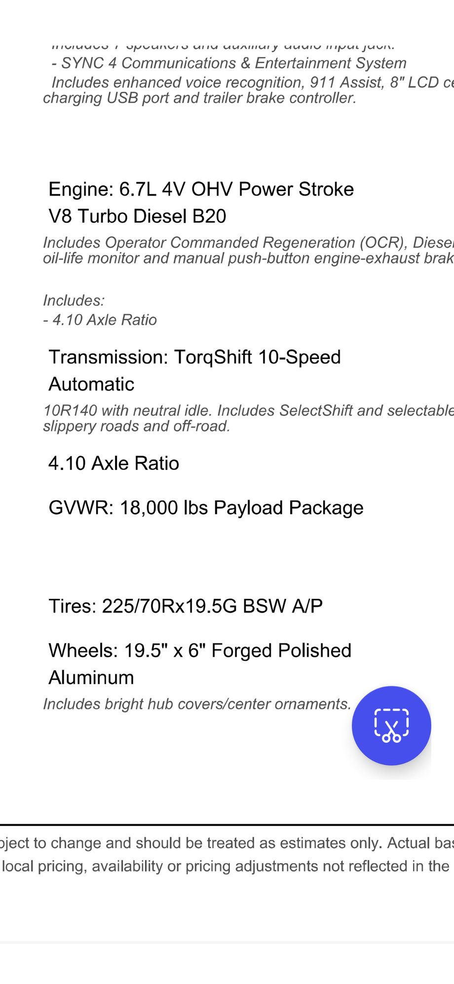

Old Nov 3, 2023 | 08:53 AM

Screenshot of my 24 order
