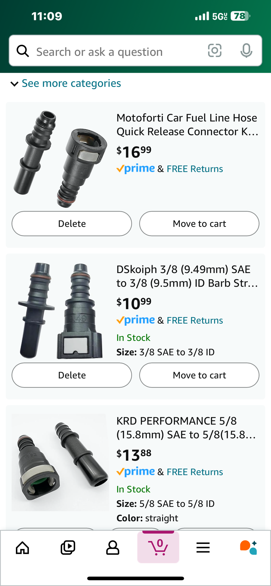

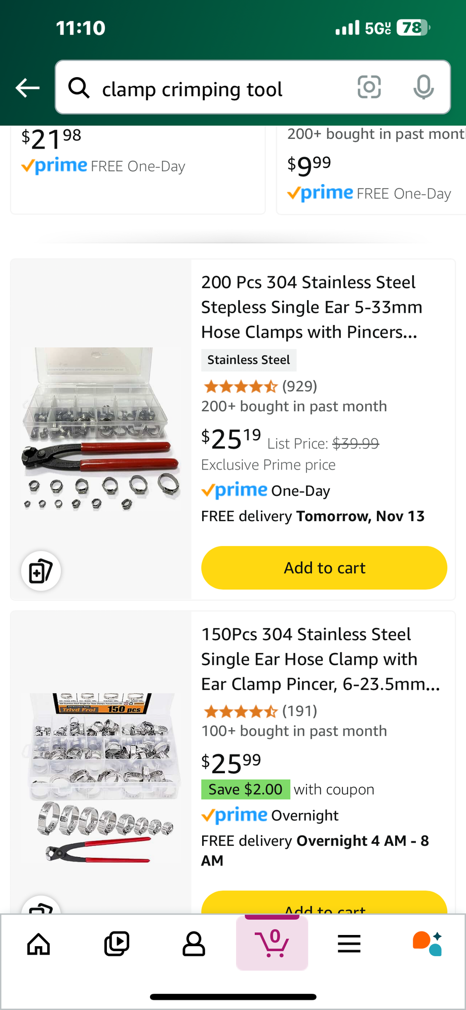

there are two sets of install instructions for the afe dfs780, both show different feed and return disconnects that can be used to connect a different lift pump filter or filter. You will need to order a set of male and female fuel disconnects, obtain a crimping tool, and some crimp clamps.
if you have a 17 thru 19, the instructions that use the mid frame quick disconnects are easier than the rear bear tank disconnects. That yellow rear quick disconnect is a PIA to disconnect t .

You will need the correct size fittings…measure the male prong of what you have .
and a ear clamp crimping tool and some clamps.
dont use screw type hose clamps they will pop off or leak.
