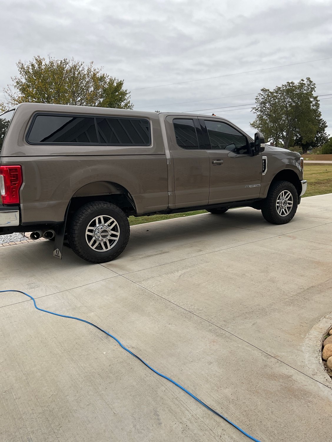

Thanks for the feedback. I had them mounted yesterday. The look is nice … this week I’ll put them to the towing test.
No pictures?
Old Oct 15, 2023 | 02:16 PM
1956mike's Avatar
1956mike
Joined: Jun 2019
Posts: 48
Old Oct 17, 2023 | 07:49 AM
