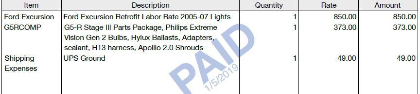

G5-R package:
Phillips Xtreme Vision Bulbs
Wire Harnesses, Hylux ballasts with D2S adapters, & Shrouds
https://lightwerkz.net/collections/p...-parts-package

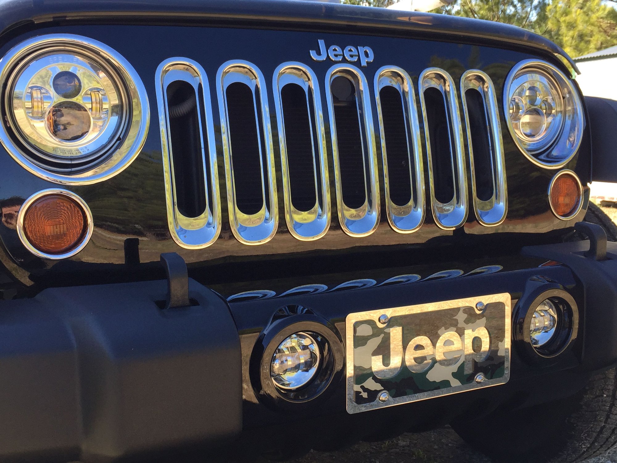

They're the best mod I've done, and equal to quality and intensity as my JW Speaker LED's on my Jeep Wrangler. I don't see a wattage listed in my 2018 Email quotes, possibly not an option back then. The bulbs were $115.00..

No, no cutting was done. I bought new housings at Ford, sent them to Lightwerkz, and they opened them up, added the projectors, then resealed them. So, I had already replaced the headlight header with the 05-07, and modified the 05-07 grill to work with my 01 front bumper. Whatever pics I have are in my thread.

Hey bud, just wanted to confirm that you are saying your custom HID retrofits in your Excursion and JW Speaker LED h6054 sealed beam units in your Wrangler are comparable in terms of light output, quality of light, and beam pattern?? I am on the fence about doing 05 based housing HID retrofits in my '99 with a header panel modification versus getting some used factory sealed beam hardware from a Super Duty and getting either Trucklites or JW Speaker sealed beams. Been curious about how the performance of both options stack up for a while now. I'm looking at it from performance standpoint and aesthetics which is tough because i like both looks (fond of amber corners on my rides).

Not good at really making assessments, but, I do feel the light intensity, clarity, and color temp between both the JW Speaker, and the HID retrofits are superb, and similar. I'm satisfied with beam pattern in both, although different. In both applications following install, I had to lower the housing adjustment to prevent blinding others. Where they are adjusted now, I have full light spread left and right, as well as far enough down the road, with no-one flashing me. Obviously the JW's are a sealed LED unit, and therefore the inner reflector and LED were designed to work together, whereas the the HID's really don't use the rear chrome reflector, and there are no light directing sculpts/prisims in the polycarbonate lenses. The glass projector lens is satisfactory. In both cases, I seldom use the high beams, am able to see anything reflective, eyes, signs, etc, easily a half mile away. The JW's I have (from 2013) do not have lens heaters, and therefore will cause issues in snow, and ice, they are not needed for the HID's.
The HID retrofits must draw some current as I had to repair a burnt crimped on eyelet, the only issue so far. I had to add an anti flicker pigtail in-line of each JW on the Jeep due to the high speed can bus network caused flicker. (Not an issue with the superduty platform)
