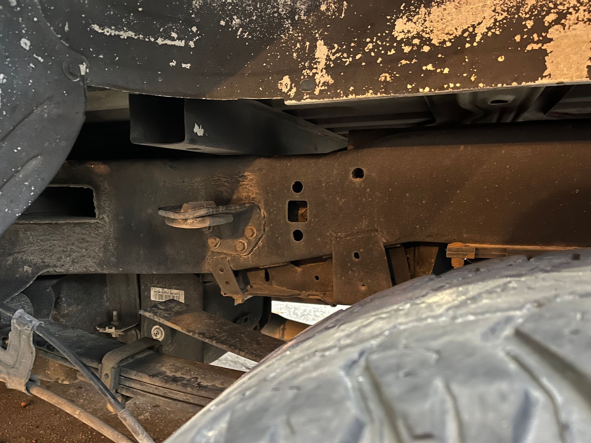

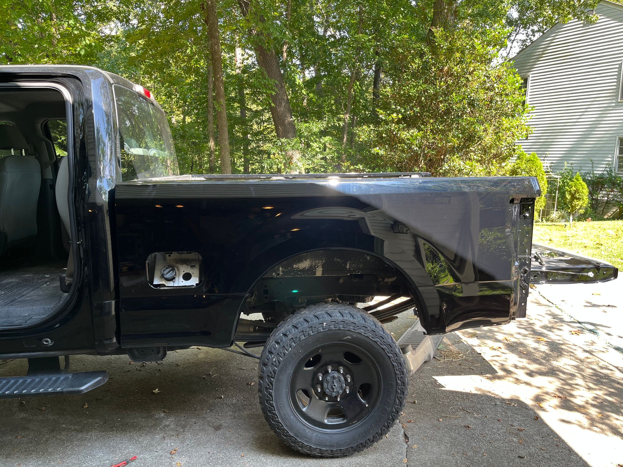

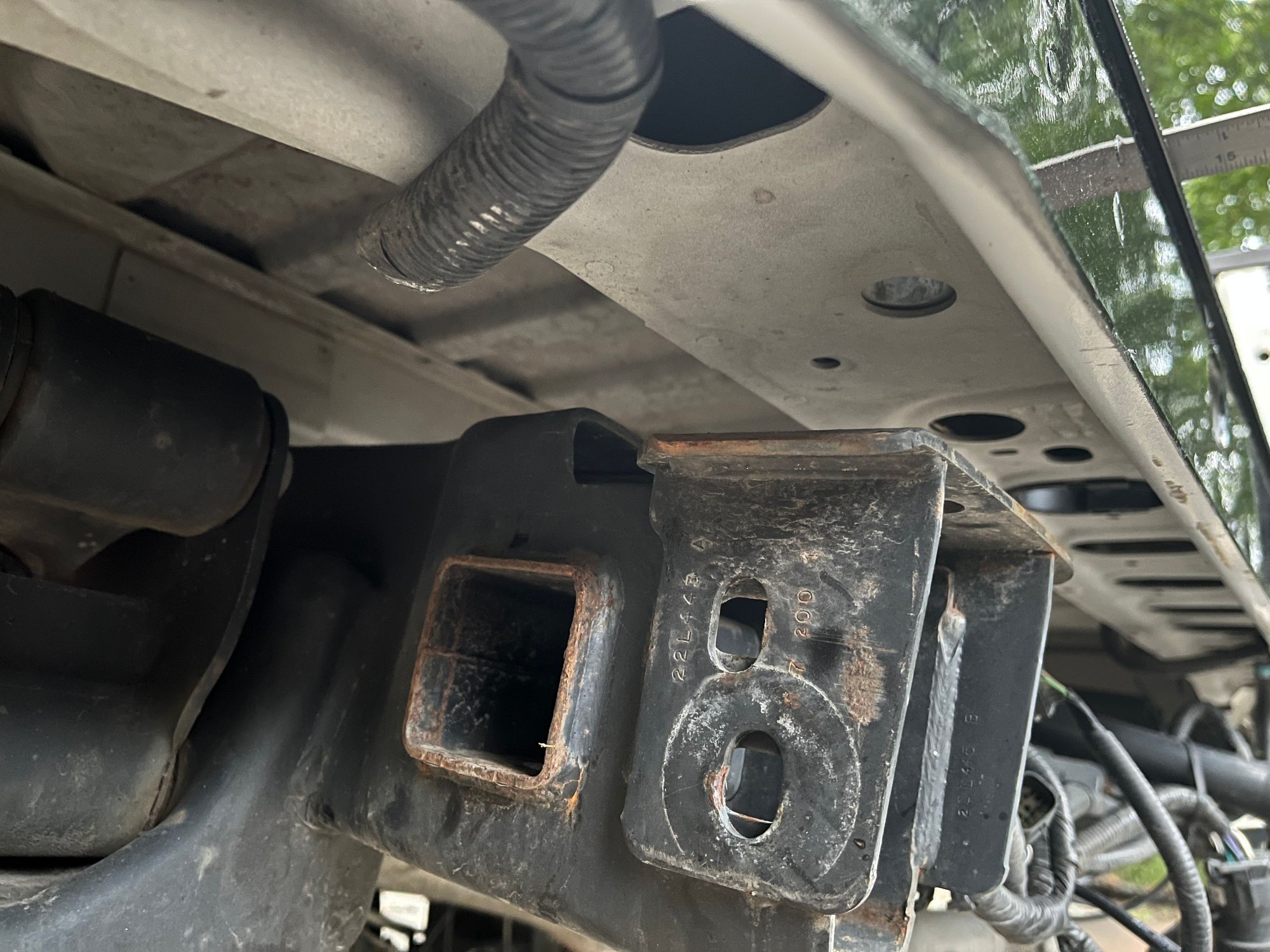

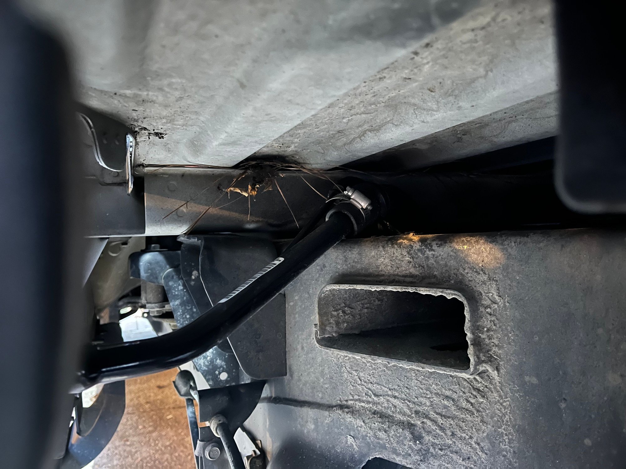

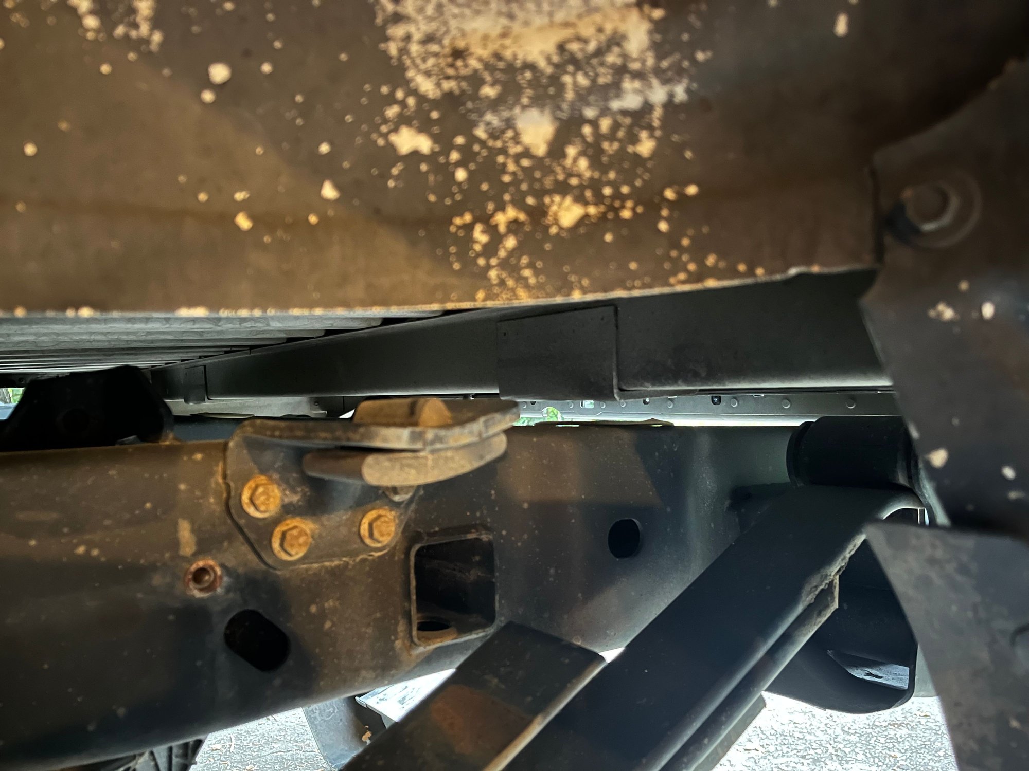

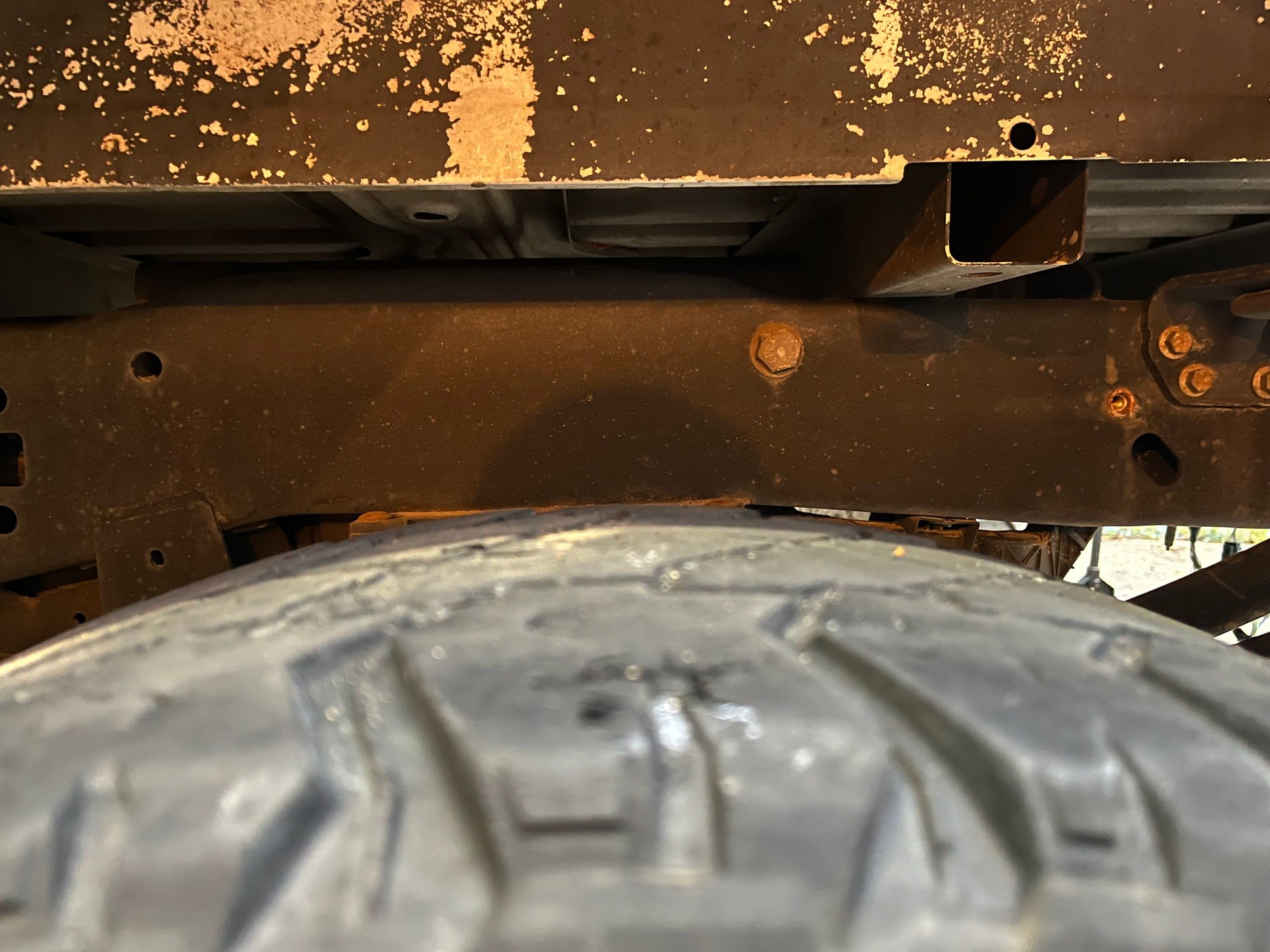

That might be my problem because there isnt anything between the frame and the bed cross members
The bed is not bolted in this picture and I can basically rock it, pivoting on the high point over the axle.
Closest crossmemebr to the cab
The farthest rear mounting point has the largest gap from frame to bed
This is the second from the back, slight gap but not much.
This crossmember is directly in front of the axle hump and is making contact.
This crossmembers is directly behind the axle and is making contact

Go check out some YouTube videos that show 5th wheel prep install on the Super Duty. It will give you some additional visuals of what the frame looks like where the bed sits. From what I have seen, there aren't any spacers or risers, it's just the crossmembers under the bed that make contact with the attachment points of the frame. Can you see all the captured nuts for each mount point on the frame?
Just took these from the passenger side of my '19. They are in order from front mount to rear.
