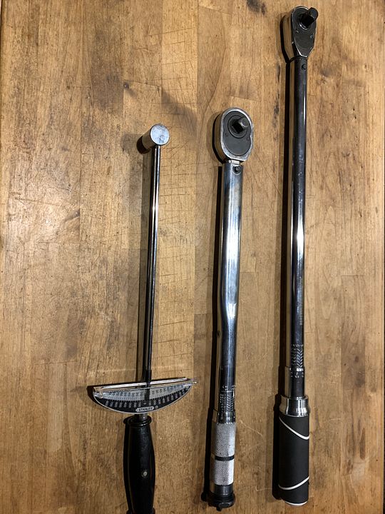

I have a small beam torque wrench for inch-pound work, then a normal 18" torque wrench that goes to 150 ft-pounds max and for added leverage and torque values up to 250 ft-pounds max I picked up a Husky brand. Many of the Husky tools have lifetime guarantees. The 24" length made it easier to hit that higher torque value.

The problem I had wasn't that I didn't have the proper tools but with the truck sitting on the floor there isn't enough room under there to get that much torque on that nut. If you have a drive on lift like the alignment shop, it's easy. I like the beam or dial type torque wrenches best. Mainly because they retain their calibration longer and you can tell at a glance if they are off.

With the click type torque wrenches it's best if you release any pressure on the spring by setting it near or at zero after use. Storing them with pressure on the spring accelerates that de-calibration some.

The problem with the click type is you have no way to know when they are out of calibration without sending them out to be recertified. When I was doing aircraft work on turbine engines, I only used Sturtevant Richmont or Snap On beam or dial type wrenches, so I still have a few around. I admit most automotive work doesn't require tools that expensive. And the click types are fine if you send them out every few years and have them recertified.
