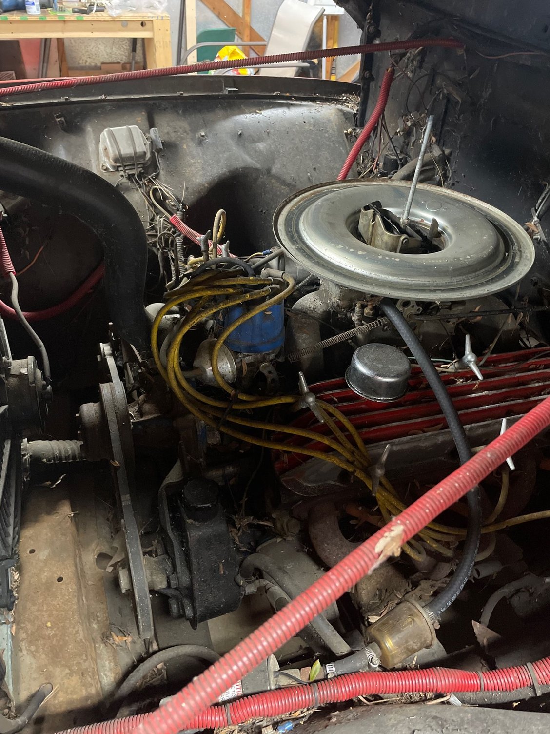

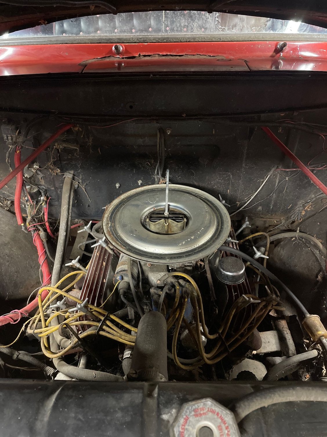

And the big question...The wiring is a BIG MESS. Scary big mess. there's wire nuts, fuses in weird places, and random wires all over. I need to get this out of the garage once i get the tires on it and pressure wash it. What are my risks? I'll take measures to prevent water from getting into the carb and vents on the tappet covers and I will keep the pressure low. Just need to get the leaves and grease off the power steering pump and engine, etc.

Looks like a wonderful project ! Looks like you have all the basics covered with your plan. As to your question about the distributor, it probably still has points, as there is nothing to indicate they did an upgrade to electronics. (However, there are a few electronic upgrade kits that hide under the dist cap. ) Nothing wrong with using the old point system until you upgrade when you replace the wiring harness. Probably would not hurt to keep a good fire extingusher handy until you can make your wiring changes.

Yeah that wiring looks scary! Might look into EZwiring for a new harness that lays it out and has all wiring printed so you know what goes where. have fun!

Pop the the distributor cap to se what’s inside. I retrofited my 302 with an electronic distributor with vacuum advance.

@bassdr You should see beneath the dash...I'm looking into prefab harnesses but I think I'll opt to make my own. For now, I'm stripping anything I can confirm isn't needed. There are a lot of things simply clipped off.

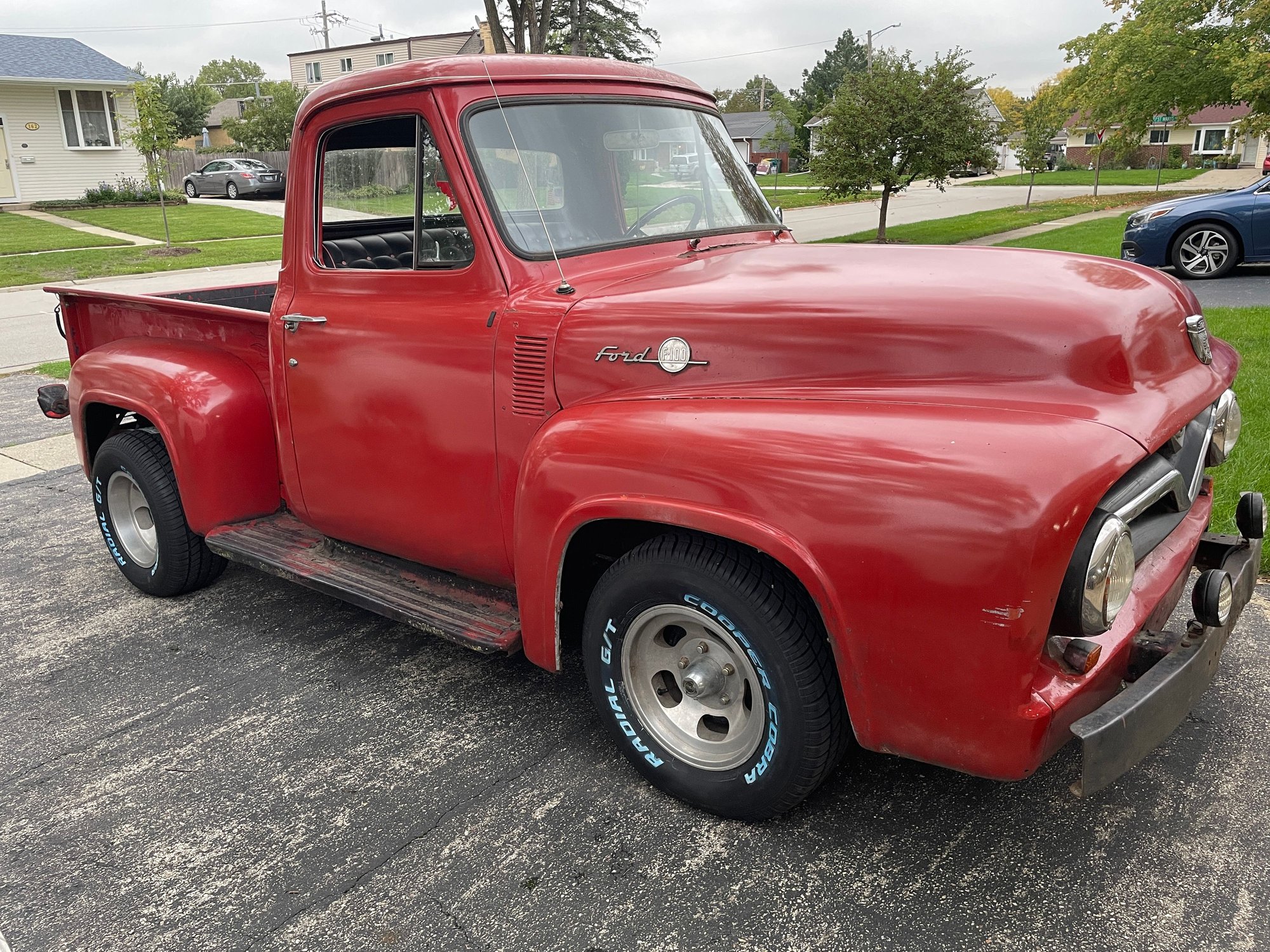

Thanks all for the responses. Right now, it runs and drives pretty good. Headlights need new sockets (arrives today) and wiring. A good exterior cleaning. And here's a pic with new meats.
