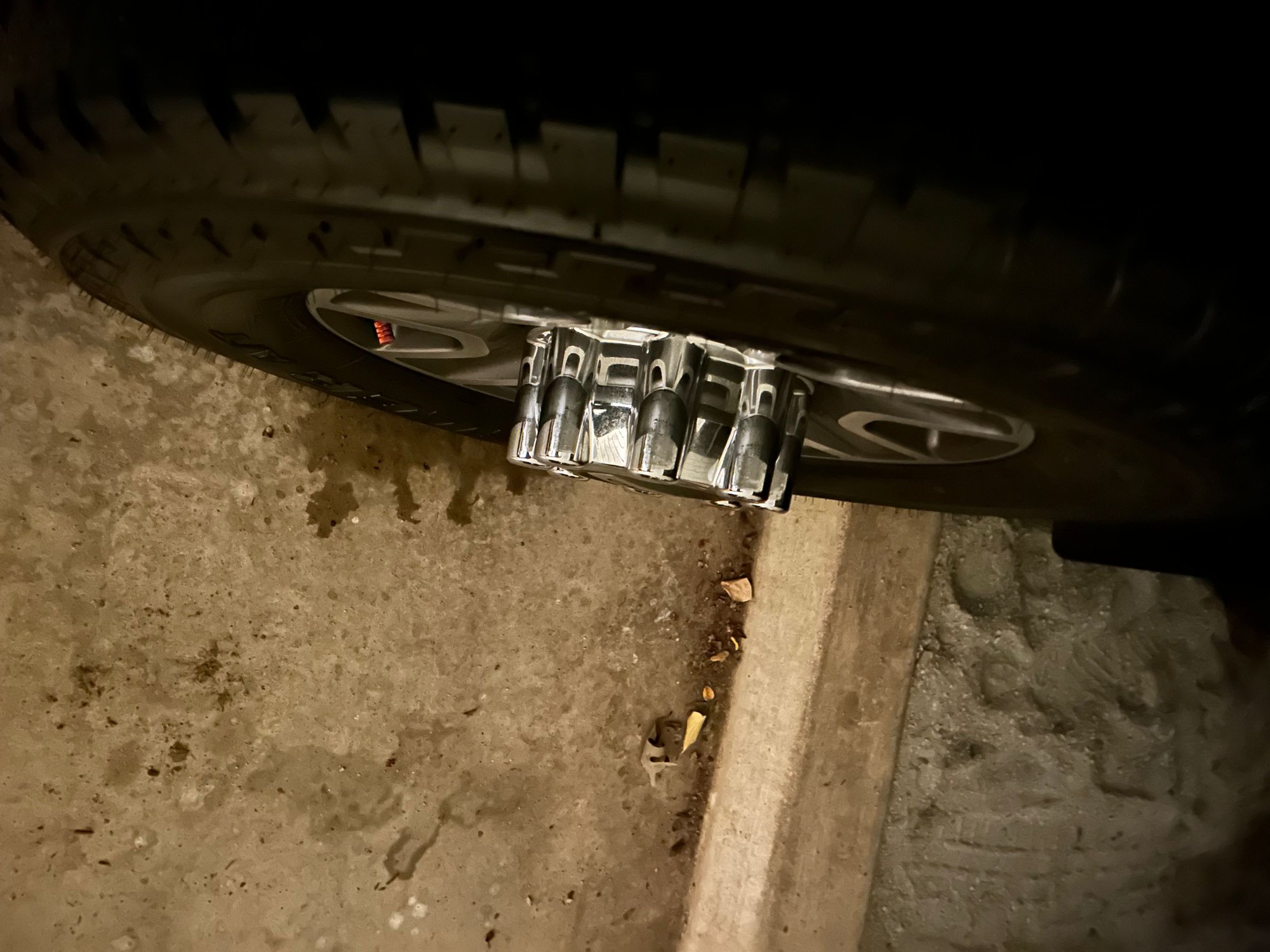

I pulled the caps off my '23 STX with a Dana... I'm not sure if they would work for you...
Not a very good picture, but that's what I got...

Better photos...
3.5" measured outside...
Are sure you have the Dana and not the Sterling under there? I'm guessing yours is the 11.6.
The problem he has is that the caps that came with the wheels are for the Dana rear. He needs the caps from the Sterling 11.6, which yours might be.
I have a Dana... unless Sterling uses Dana parts on their axles...
I was confused by the description above about which was deeper, that's why I gave the measurements. They very well may not work for the OP.
