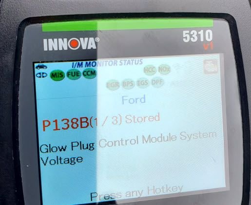

UPDATE: I replaced the three wires to the drivers side alternator cause the power lead was not getting power as this was a common youtube fix. 2 for communications and 1 for power. No change. I had local auto parts do a code test and it came up with a "P138B - Glow Plug Control Module Voltage", fyi- the truck starts just fine. He also tested alternator and it came back OK. BUT, I no symptoms manifested while he tested it.

Yes, got a P138B glow plug control module system voltage
