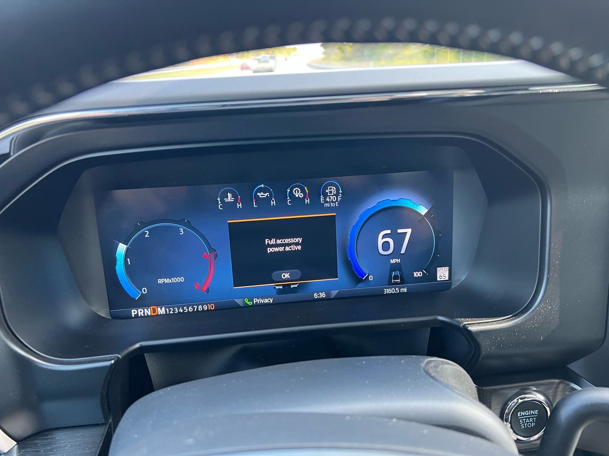

Every so often when I start driving a random message will get stuck on my screen. No matter what I do it won't go away. Anyone else have this happening to them? This is what popped up on my way home from work today. Very annoying.

Yep. This happened before a 2 hour trip and it was on the whole time. Super annoying.

IME, that message should only pop up when you're in accessory mode... ignition ON, engine not started. Definitely not right.
For either of you, did an engine/truck shutdown and restart not correct the issues?

It did. It’s only happened a few times since I picked the truck up in late April.

Yes, that makes the issue go away. Just sucks when you start driving and look down and notice it. Then you need to pull over and restart. I'm wondering if the new recall for the soldering issue will fix this.

I had this happen tonight on my 2023. I was unable to clear the message by hitting “ok” or any other buttons. Didn’t impact operating the truck, just annoying and not able to scroll through other screens.

I find that a quick open and close door removes it.
