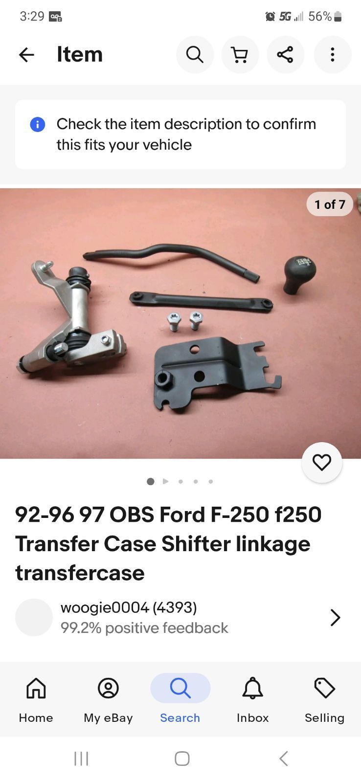

Hey guys went to install the 4x4 shifter assembly on the side of my transmission it’s an 1997 hd f250 automatic and won’t bolt up believe I am missing a bracket that the selector mounts to can someone give the proper name or part number for this bracket so that I can locate one
in the picture attached(hopefully it attached I need the bracket I think please help thanks and does anybody know the bolt size and thread in the picture they mount the bracket I assume

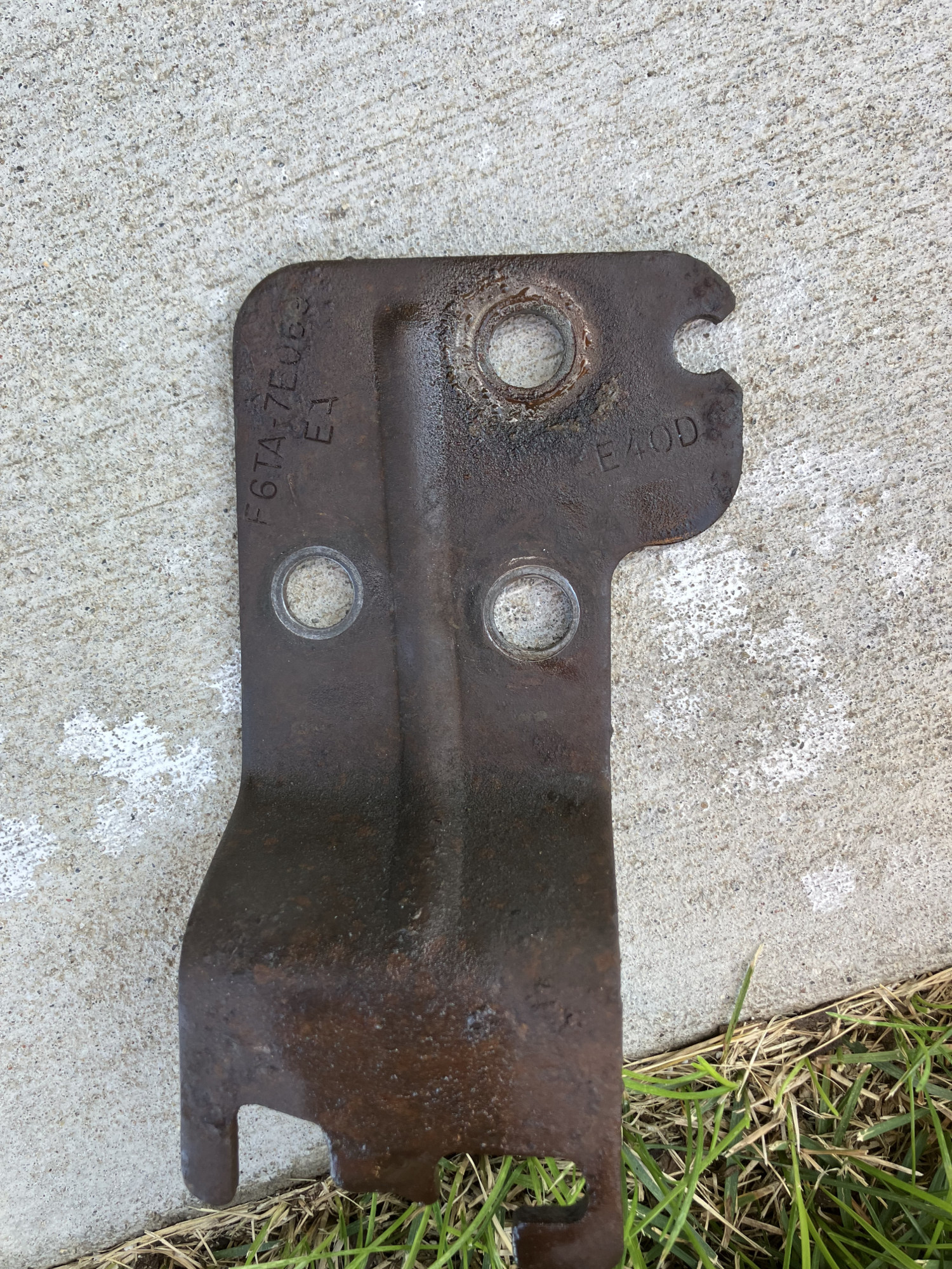

If you mean the piece in the lower right corner of your picture, I just so happened to take a picture of the part number from my truck (1996 F250). It’s kind of tough to make out because of rust, but it looks like it includes “F6TA-7E06”. The piece is also unmistakably stamped with “E4OD”, but it works just fine on the ZF S5-42 that I swapped in.
I’ll see if I can post a picture tomorrow after work so you can read the rusty tea leaves yourself, but it’s too late for me to figure it out tonight.

See if you can tell the part number from that.
