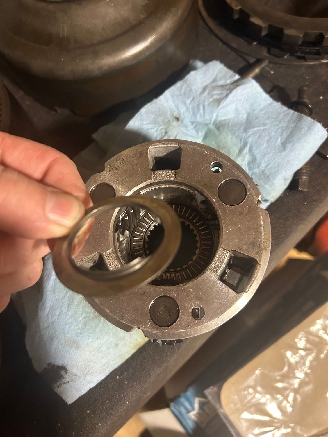

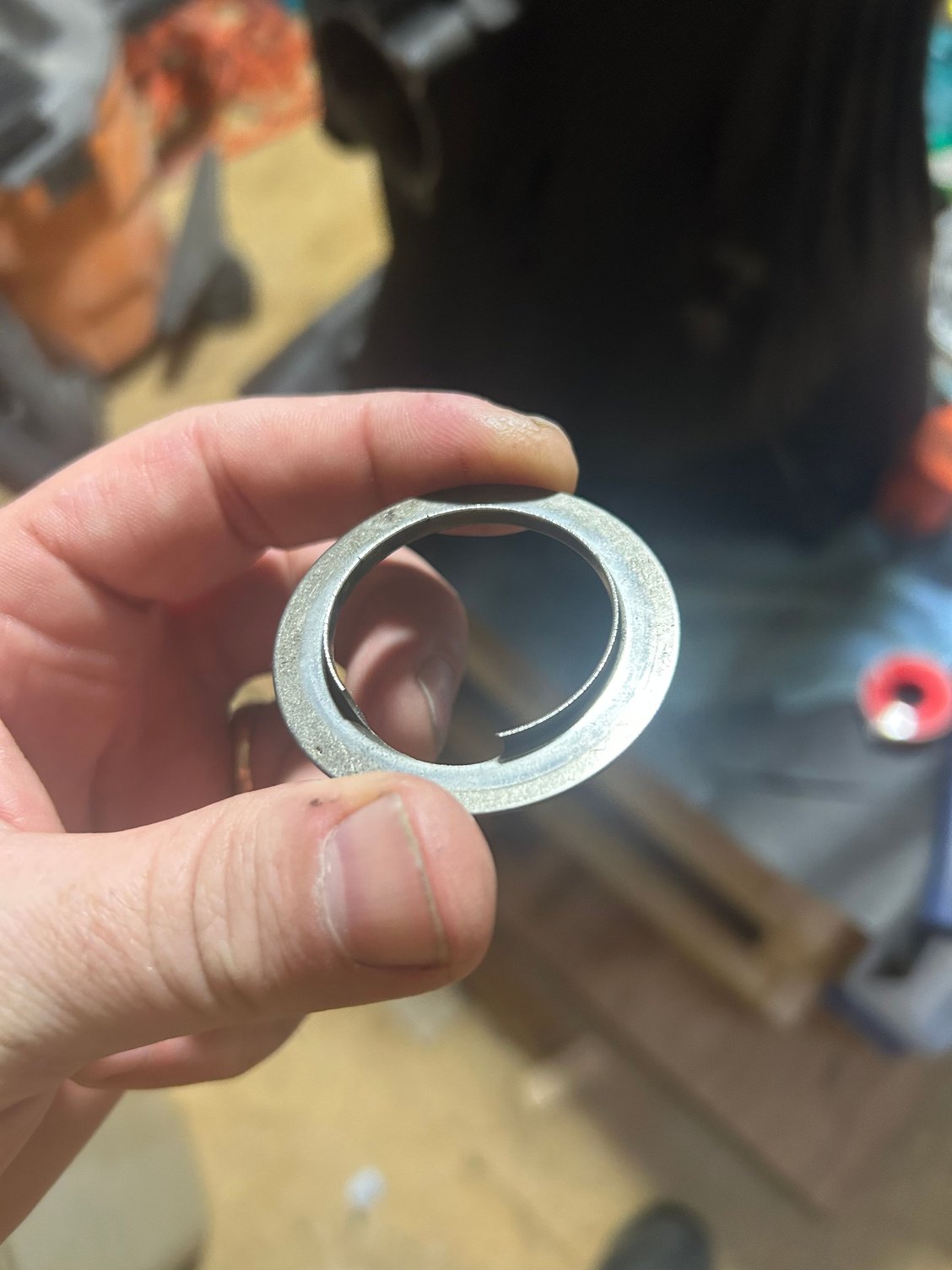

So I’m trying to help my uncle with his tranny rebuild. The problem we are having is trying to find a race for the bearing in the forward planet. His is broken. Any help would be appreciated!!

You may have a hard time finding that race, you could always go to a later front planet that has a 1 piece bearing in it. Believe it or not you could use that race, it is just the lip that centers the bearing in the sungear.... if you really needed to.

If we were to go with the later planet, would it affect the final end play much? Thanks

No it would be the same. A C6 will always take a # 3 or 4 selective on the pump, metal is preferred over a plastic washer.
