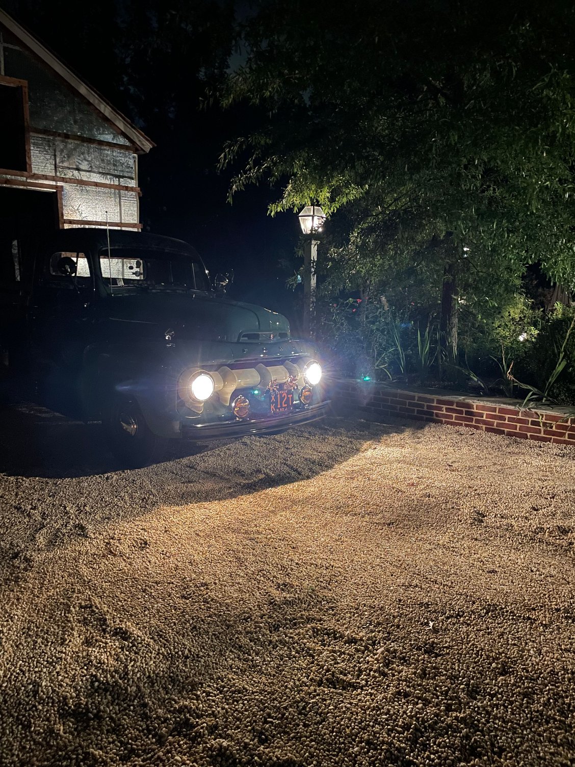

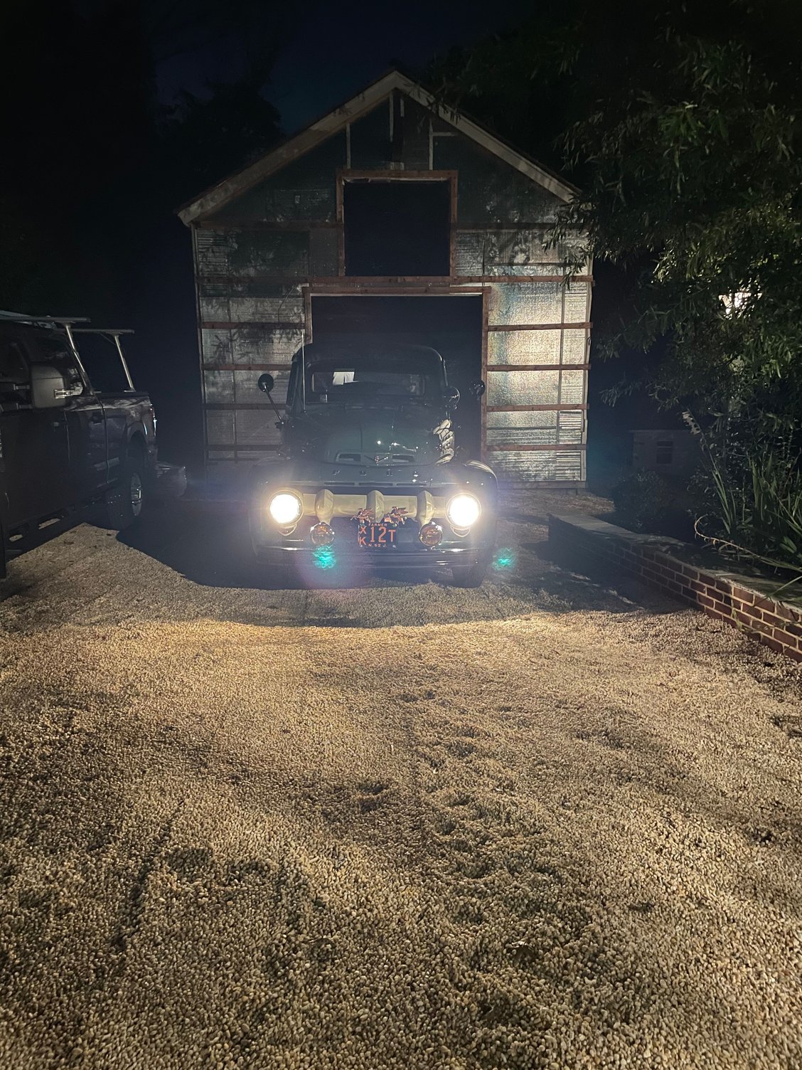

I just bought a pair of H6006s off of Amazon for my '52 F1 and they fit and seem to be nice and bright. They are halogen. Does anyone know if there is an issue with halogen bulbs drawing too many amps. A friend with a Chev pickup told me he had to put in relays for halogens. I have a stock generator and 6V positive ground.

Halogen bulbs actually draw a little less power than the original incandescent filament bulbs. I run them with good condition stock wiring without issue. However, I will never argue against a good relay installation.

The 6006 halogen variants available today are direct DOT certified replacements. The external temperature of the sealed bulb unit will not be of any significant difference.
