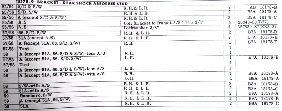

I need help identifying these two old parts. The one looks like a motor mount but I am not sure of the years and the models.
Part #2:
I know this is for a 57 model but how many other years.

2GC-6037 Bracket - Engine Front Support - Right Hand Side, Commercial Conventional Cab Trucks 6 Cylinder G series 1942/47
B7A-18179-B Bracket - Left Rear Shock Absorber Stud - 1957/58 All Passenger, Taxi, (Except Fairlane 500 Hardtop, Ranchero, S/D Sedan Delivery, S/W Sedan Wagon) without Air Suspension

Thanks, b. What is S/D and S/W?

I edited my post above to make things abundantly clear and expounded on the abbreviations like Sedan Delivery and Station Wagon.

Those engine supports are both right side Abe
