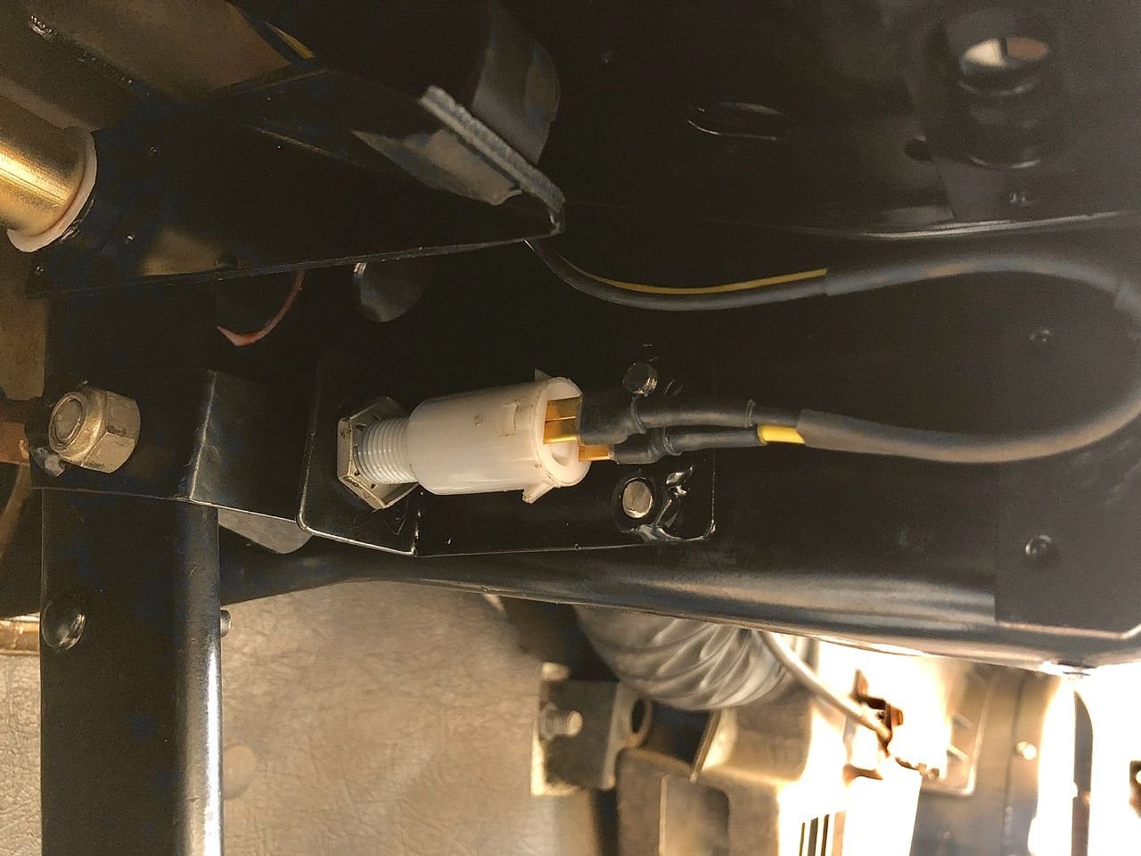

If it’s a fluid pressure operated switch, you could relocate the wires to a pedal mounted electric switch from a later model. That’s what I did on my 63.

I thought of doing that or a mechanical switch... wasn't sure on how to do the electric switch

We’re both talking about the same thing. A mechanically operated switch on the brake pedal, under the dash.
I just made a couple of little brackets.

I went with the pedal switch route also. The pressure switch worked before replacing the master cylinder and booster. Afterwards could never get it to work even replaced it twice.
